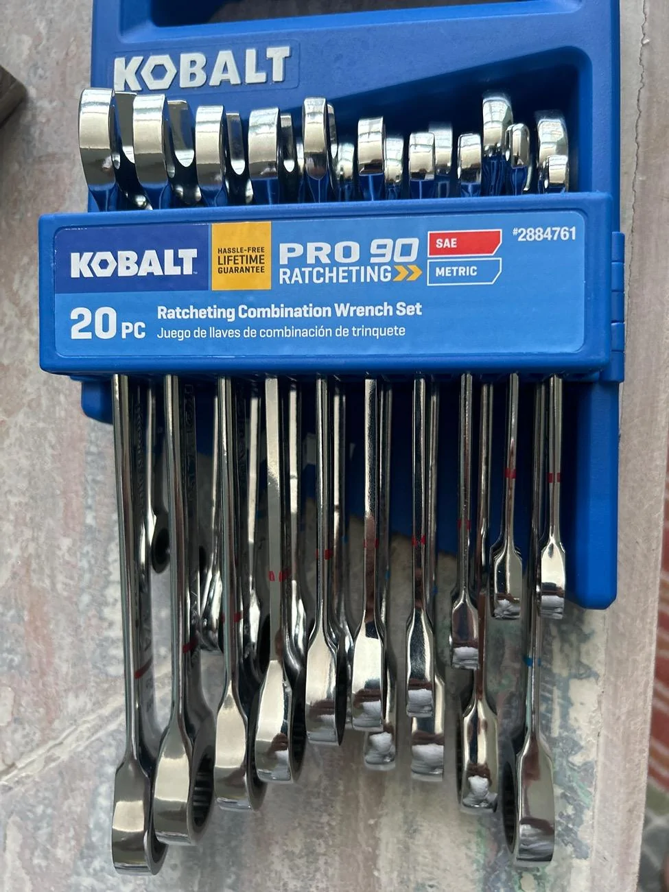

Found a nice set of SAE and Metric combo ratchet wrenches on clearance. Might return as reviews are mixed and found better quality for a good price.(Klein) However this kit is missing 16 and 18mm.
8-Piece Metric Wrench Set comes with 8, 10, 12, 13, 14, 15, 17, and 19mm.
Any 16-18mm on the Bronco you are aware of where a wrench is handy?

Thanks all. My OP may have been a little confusing looking at it. Has anyone ran across a 16 or 18
Ford Bronco Wrench set sizes imag
on the Bronco? If even one, then I’ll just keep the set I bought on clearance. Kobalt $59.00. The Klein set is also 1/2 price, better tools. Except missing 16&18.

I'm certain that the suspension uses 18mm in spots.
Personally I'd still buy one of the sets. I'd be surprised to see 16mm be used.
Yup. 18 somewhere in there but can’t recall exactly where, and 21 for the sway bar if you have the stock one

Thanks. Will keep the metric Kobalts for the kit.
