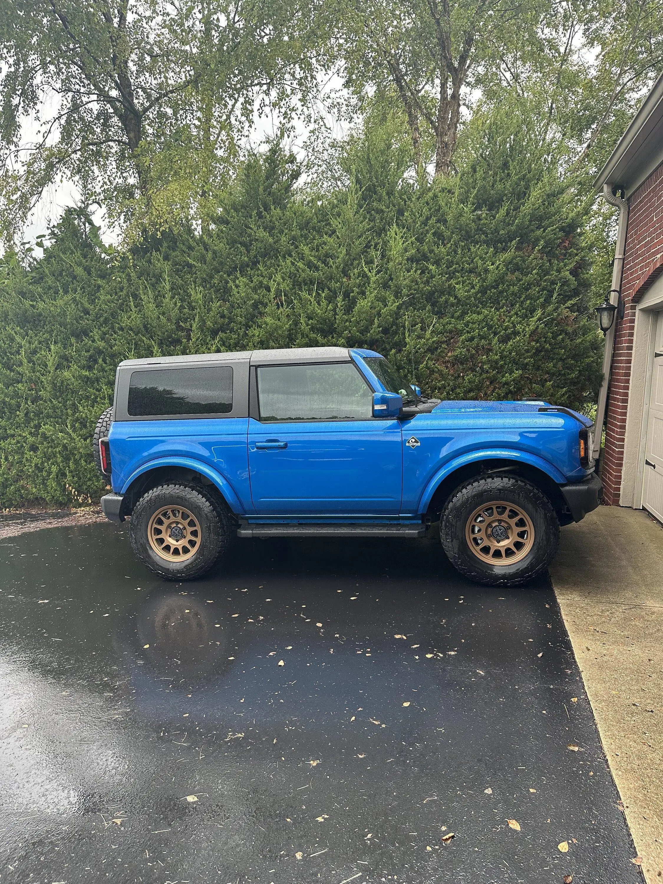

Hey, I figure you know! I just picked up my VB 2dr this afternoon. Where do you fill the rear fluid? I couldn't get mine to spray anything. Didn't see a warning or alarm either. Only drove 5 miles or so. Just never had a rear wiper before. Went to try it out in the rain and no juice!

It’s all the same

Also open the back and be sure the hose is connected. It's on the left rear side. Should be the hose and a connector for the defroster.

THanks! I'll give it a look tomorrow. 3 years was a long wait!

Hopefully a simple fix.
Figured out why it wasn't working this evening after I finished washing it. There was no washer fluid! Guess I can add that to the long list of things the dealer should have done. I was in a hurry to get it out tho
