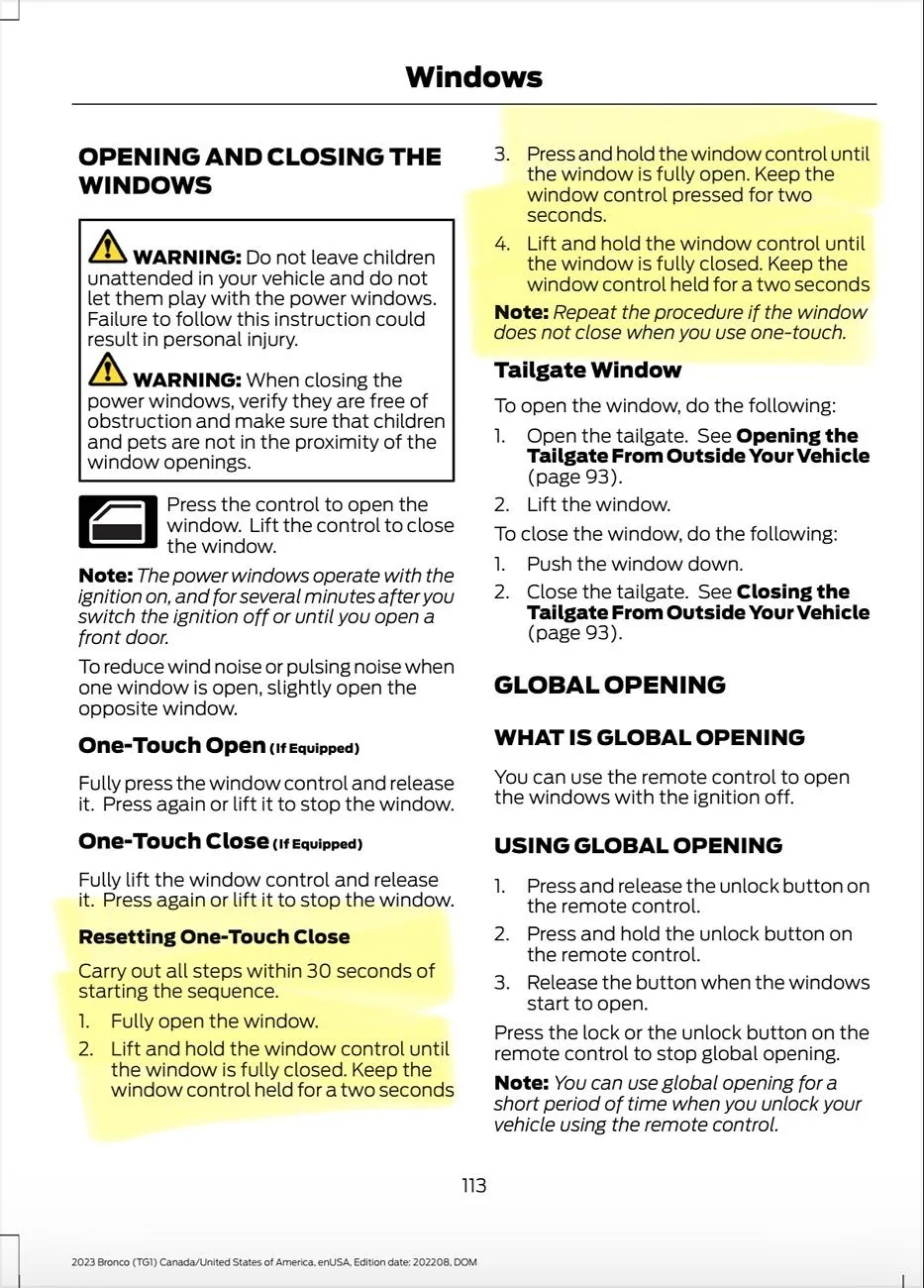

Anyone having issues with the “auto up” feature malfunctioning? We are experiencing this ONLY on the drivers window. We’ve also noticed when opening the door the window doesn’t slide down or back up. @Thehagermaniac @GingerChickAndFlik

No. The auto up/down feature wasn’t working on the driver side window. In addition to this, the window wouldn’t move down/up when opening and closing the door. The window was actually sitting on the outside of the weatherstripping.

Brian.knight82
Jul 18, 2021
46
Cartersville
2021 Ford Bronco OBX
Unfortunately this is a common Ford issue. I have the same issue multiple times on my Explorer. Was hoping they had it solved for the Bronco, but guess not.
Thankfully, the reset option above worked.

Mine has an issue as well. Passenger and Driver. It's as if they get stuck or sense something is there and just stop with the auto-up. I usually have to hold the buttons.

Where is this recent post?
Yep. Just had to do this in my 21 Ranger.
Hold up, down, up, down basically. Each for about 5 seconds after the window finishes moving.
Thanks kindly. This up — hold for 5 seconds at top, down - hold for 5 at bottom, repeat up hold 5, down hold 5 worked for me. Saved me a dealer visit.
