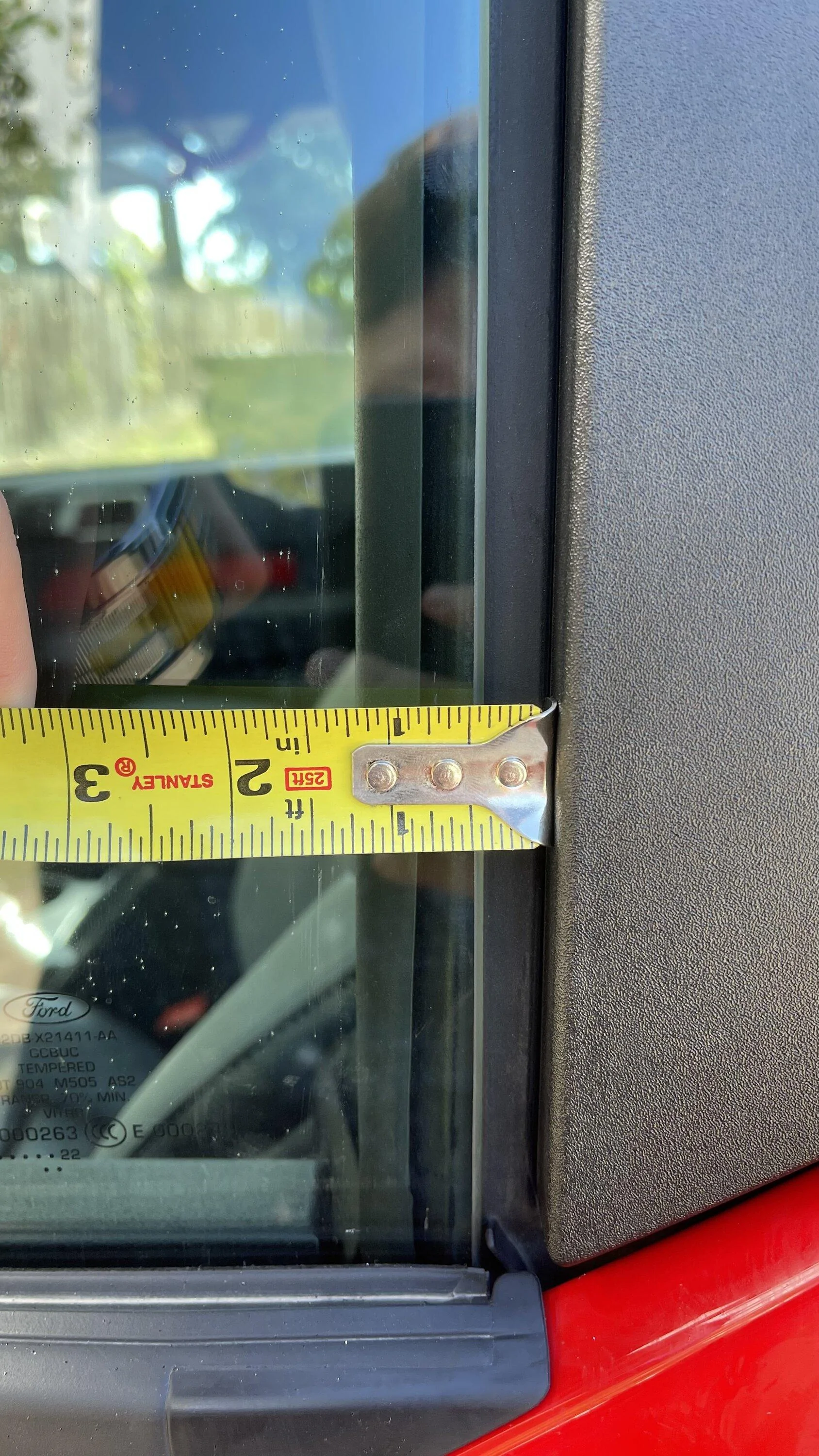

I have noticed a wind “leaking in” type sound near the drivers left ear. It’s been driving me crazy. I’m nearly 100% certain is the upper corner of the glass not fully sealing properly. It sounds like there’s a very small hole that lets air in if you’re going 60+.

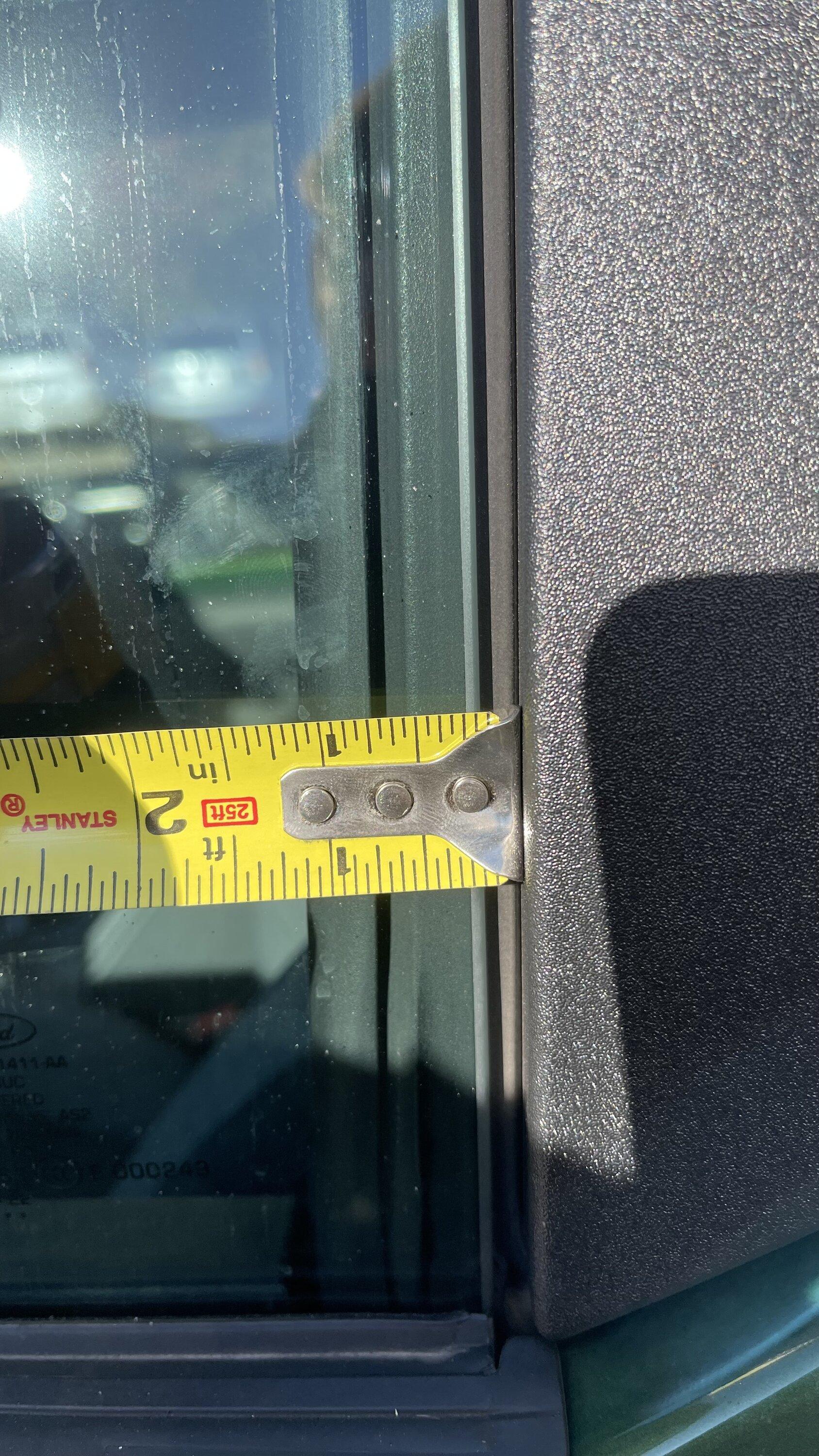

I believe I found the culprit. My friend and I have the same make/model/year. I measured the gap on his driver side window to the trim versus mine, and you’ll see it’s about twice as large of a gap.
I’m hoping someone can check out their own and share some more measurements. Is my gap abnormally large? Have you experienced anything similar?

I got a 4dr and my gap is about 1/2" different between driver and passenger rear door. I got a little less difference by reseating the hard top, helped a bit with the wind noise in my case.

Bring it to the dealer and them the window adjusted

I have, I was told “it’s as far back as the window goes”. I’m hoping for more validation to use as proof for the next time I go in
