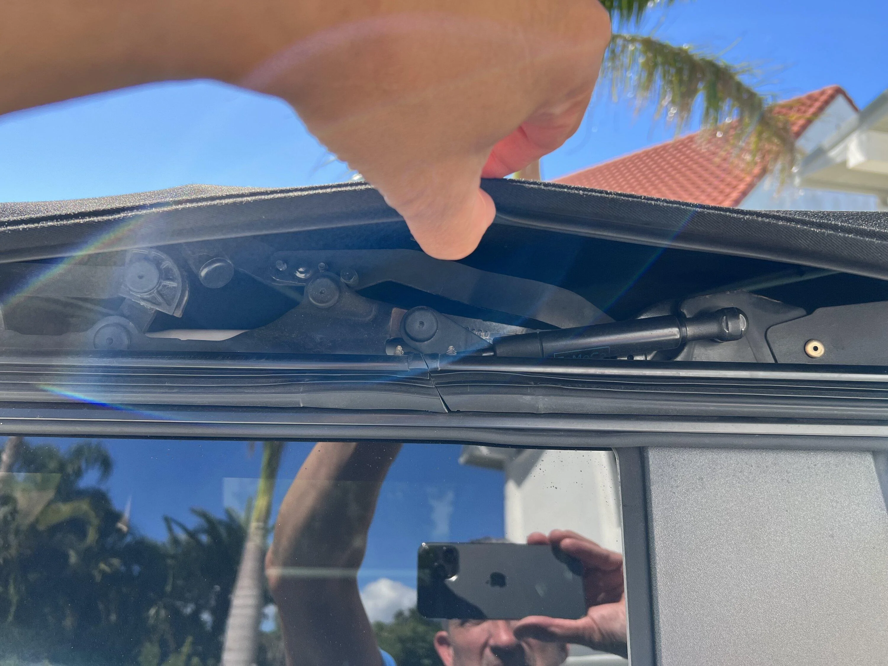

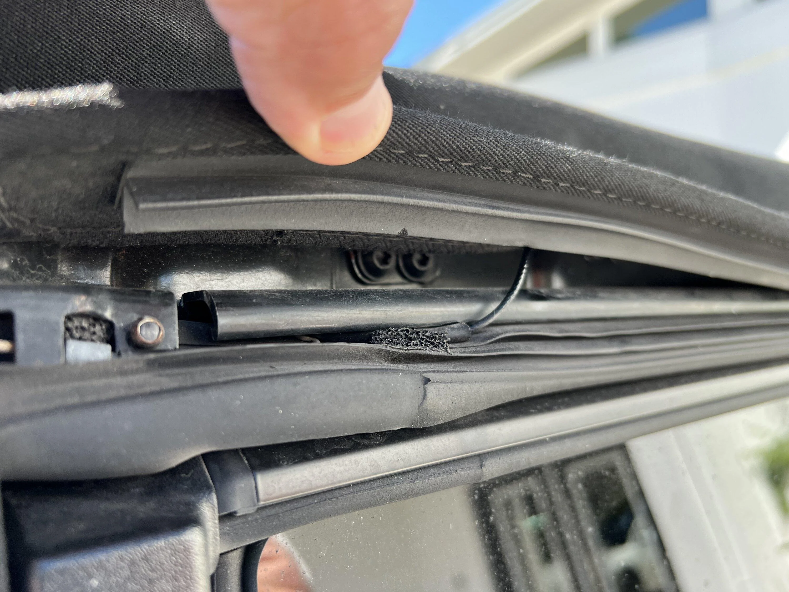

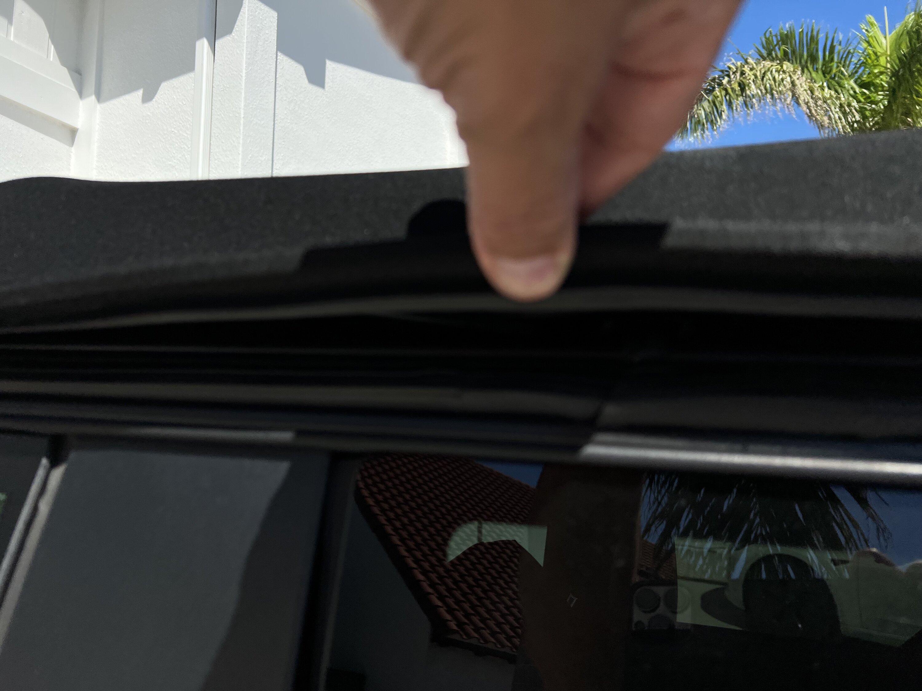

I think I see the issue. There is a cable running through the edging on the top and on the right passenger side its very loose. However on the drivers side its tight and I can barely lift the side of the top. See pics.

I had this problem on day 1. The cable should anchor into a weird little bracket at the front of the roofline. It's sort of an "over-under" latch near the end of the wire. Pop it back into place, and you'll be good. Horrible design.

Any picture(s) of this weird little bracket at the front of the roofline, something which shows exactly how the cable should be run?
I went and looked at my soft top today, including popping the front latches and lifting the forward section up.
Still trying to figure what is the right way that the cable should be run.
Is there a way to tighten the loose cable? Is there any reason for the problem being on the Right side, or does it affect the Left side, or even both sides on some vehicles?
