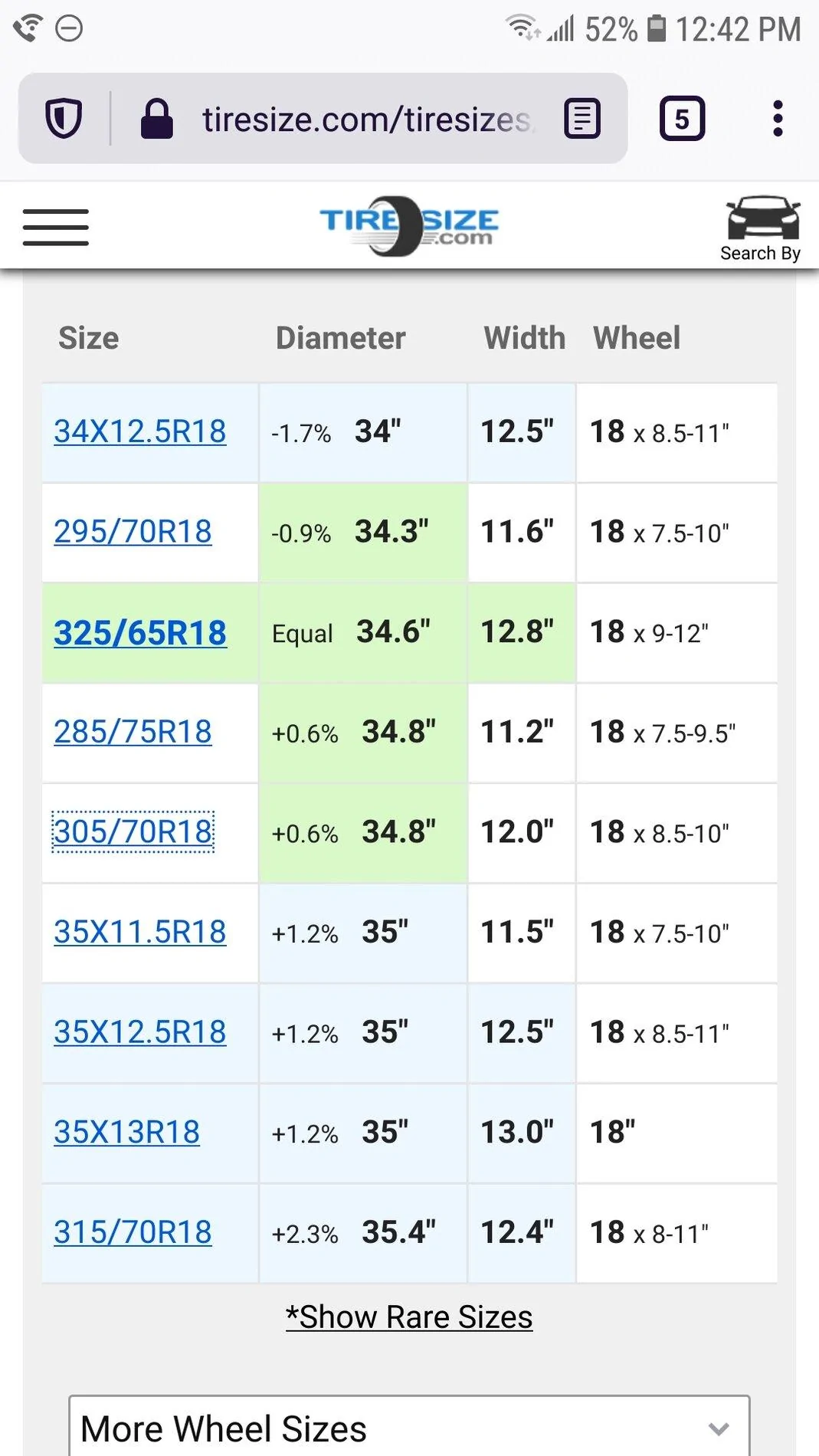

There is a whole bunch of 34-35" tires in the 18" rim size.
If I bought an OBX, I'd keep the stock rims, and ditch the street rubber for one of these.
Wouldn't the stock rims be too narrow for those?
Maybe the 285/75/18
Maybe the 285/75/18
No.
The rims size guide is for optimal tread life.
Not " you"ll flip over and burn".
Every single JK Jeep you see on the road running 315/70R17 tires (35x12.50R17) on stock rims, is technically running an undersized rim for tire size.
