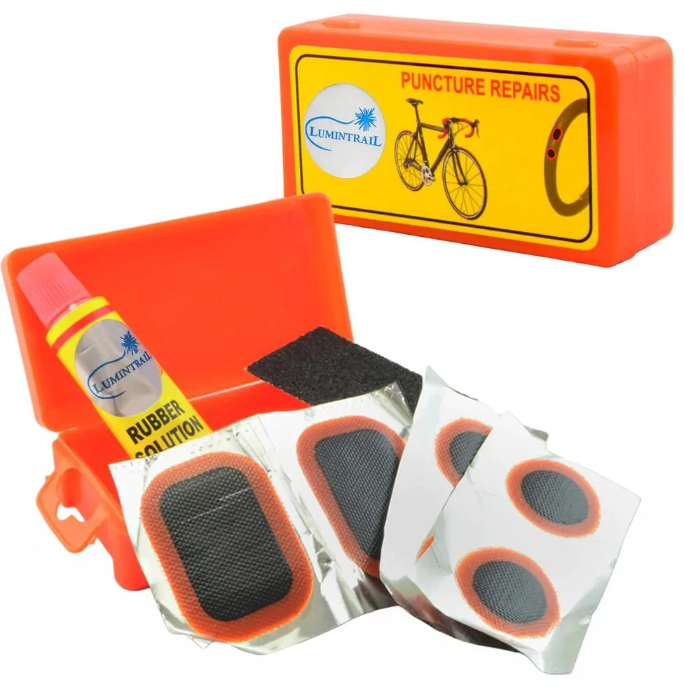

No need for a tire when you can use this:
This kit only works if you are able to pull the tire off the rim and patch repair from the inside the tire.

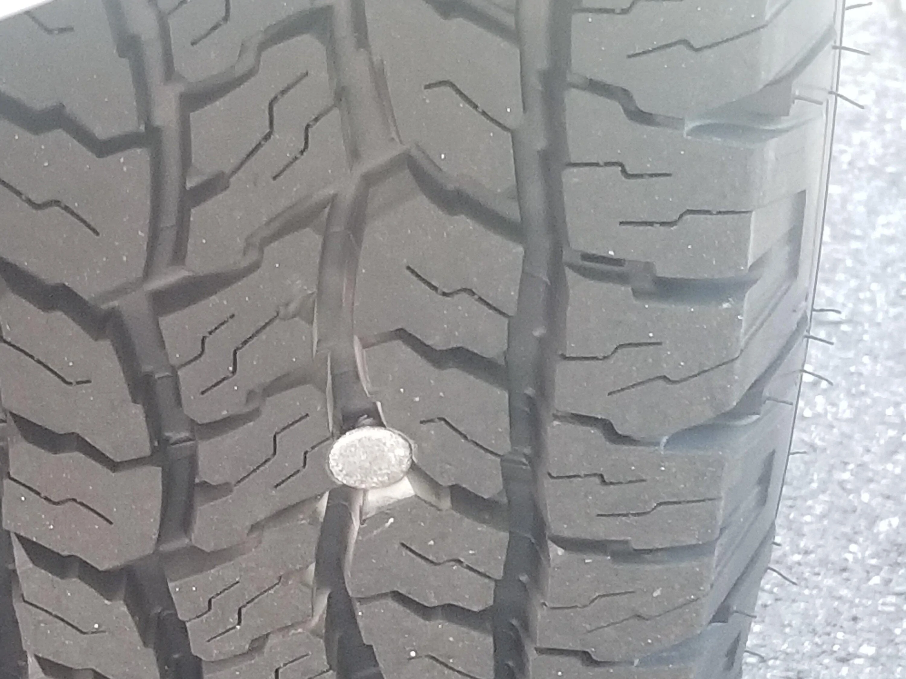

A spare is a must, but a full size with tpms these days is amazing. I had two flats in the same week. First one was in the side wall so I couldn't get it plugged; the second happened in the NEW tire days later (check out the hairy rubber nubs on outer wall). The crazy thing is that it wasn't a screw, it was a 2 inch long, flat tip, half inch diameter carriage bolt and it still went clean through. I must have hit it perfectly. Merry Christmas all!

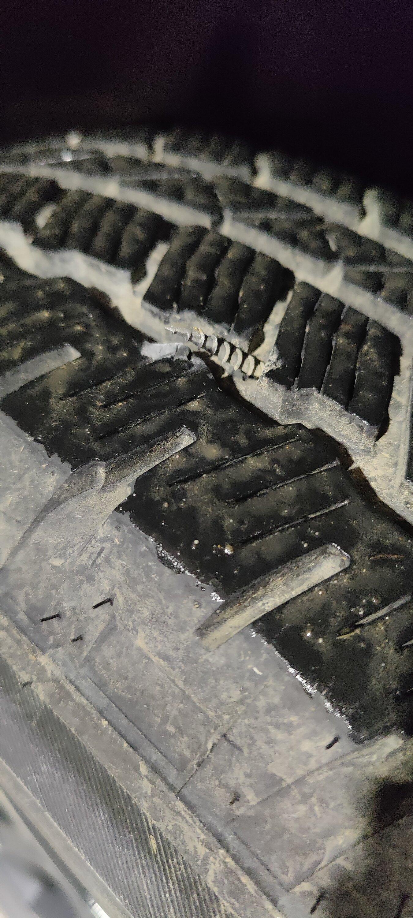

Well, an hour into an 11 hour road trip from Kentucky to Mississippi Thursday night, I get a low tire pressure warning.
Pull into a gas station and lo and behold, there's a screw poking out of my passenger rear tire. What could've been a much more annoying situation turned into an hour's work swapping in the spare. So glad the Bronco comes with a full size spare with TPMS, it's a huge stress relief.
With the angle that the screw is protruding out of the tire it’s not a good candidate for a patch, too many radial belts in the tire are impacted for it to be safe afterwards. Any tire shop following the best practices should refuse the repair, when they grind the hole out square to the tread the damaged area would be over 1/4”. The liability for failure from an improper repair is too high, many main line dealerships won’t patch anything anymore. I doubt Discount Tire would patch that one.
I don't disagree, I'll probably have the tire plugged.. I just appreciate the reliability of being able to just throw another wheel on instead of wondering if a patch/plug/etc is going to hold for another 10 hours straight driving at highway speeds.
I worked in safety for many years, so I’ll put on my safety hat for a minute. Plugs are a useful tool to get off the trail, but aren’t suitable for long term repairs on highway vehicles. The proper patch plug proceedure involves grinding out the hole and filling the void with vulcanizing material and a stem backed by a patch on the inside. The plugs don’t keep the salt and moisture out of the hole, allowing the steel belts to rust over time and fail. In my current position managing a fleet of 140 trucks and 60 trailers we get lots of flat tires. I had to break my mechanics of the habit of plugging truck tires. Plugs are fine for non road going machines, but I don’t want the liability of our company trucks and trailers running them in sue happy MA.
