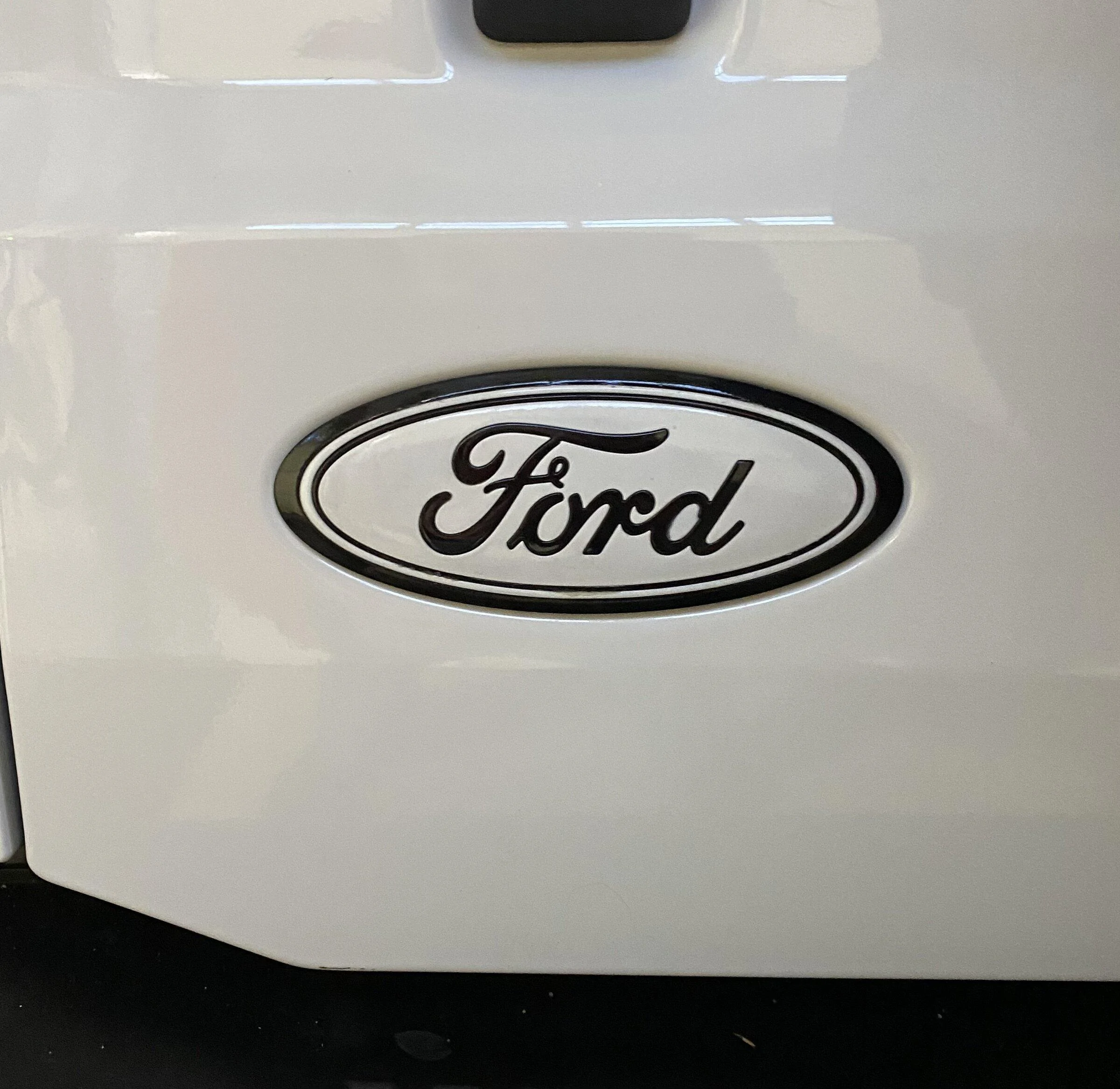

All white, or like this? Either way, you just remove the emblem, then properly prep the surfaces, prime, pain, and put back together. Bunch of threads on here that describe the process.
Biggest trick is removal, for which some floss or fishing line and a plastic trim removal tool will greatly ease. Knowing that it is attached with body tape AND two clips (press inward from the ends - they are apps at the left and right end of the "Ford" to release helps a lot).

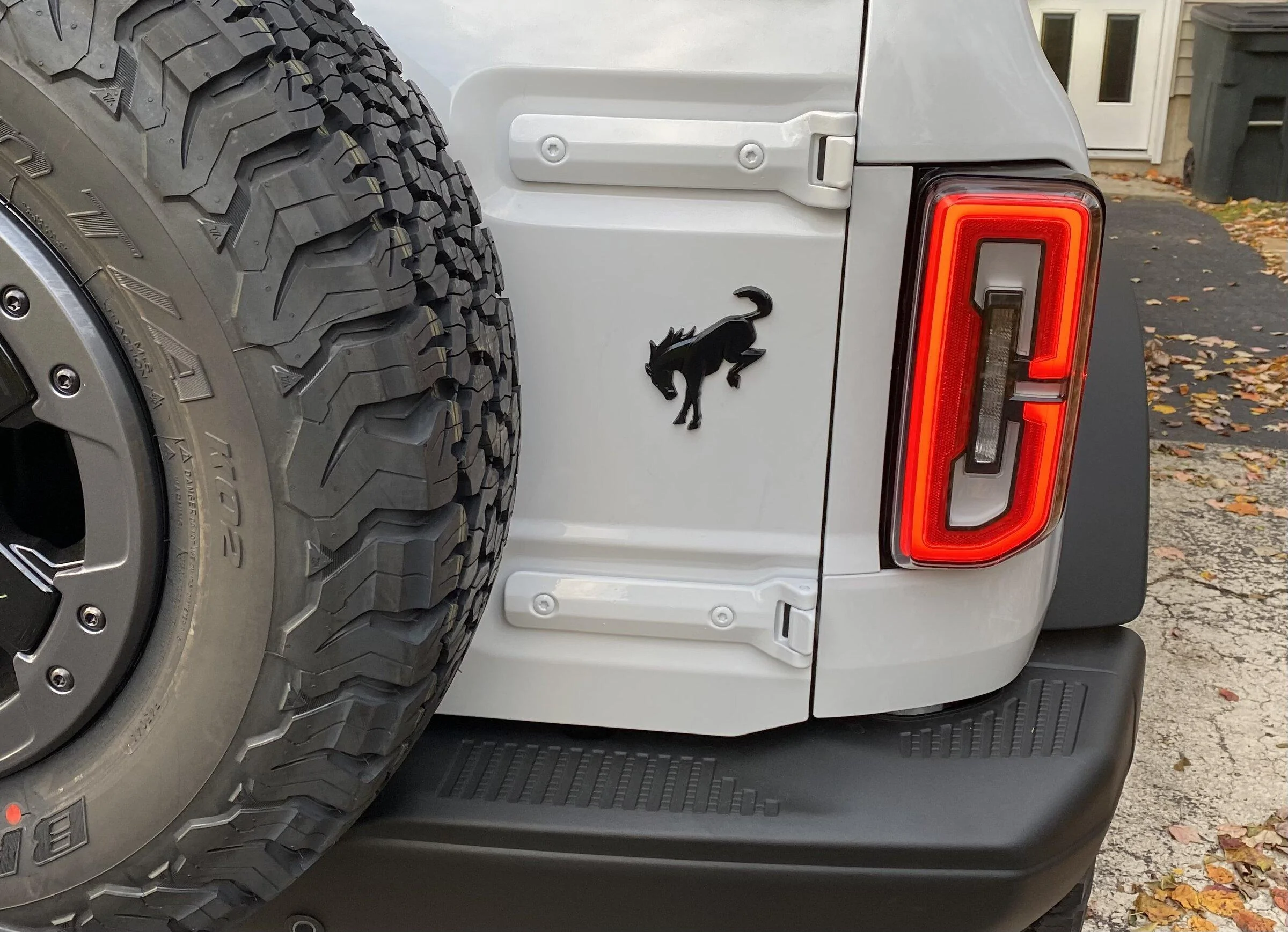

Even easier - I didn't like the chrome look of mine, so I made it black like the Wildtrak one. I have seen people mask off the logo while it is still on the Bronco and shoot a few coats of plast-dip on it as well as taking it off and painting (or plasti-dip) as well. No clips - it is only held on with tape. Same method for removal (floss/fishing line) works great. but when you go to replace the tape it is a bit more of an ordeal because of the shape of the bronco. It is easier to get the wide #M body tape and then it is a job of X-Acto knifing the cut for the shape, cleaning the surface from the old stuff, and re-applying.
I'd highly recommend putting painters tape on the vehicle and marking it so you can replace the logo exactly in position, if you want to remove it.
(this is a Badlands - but the chrome looked terrible on the white, at least to me)

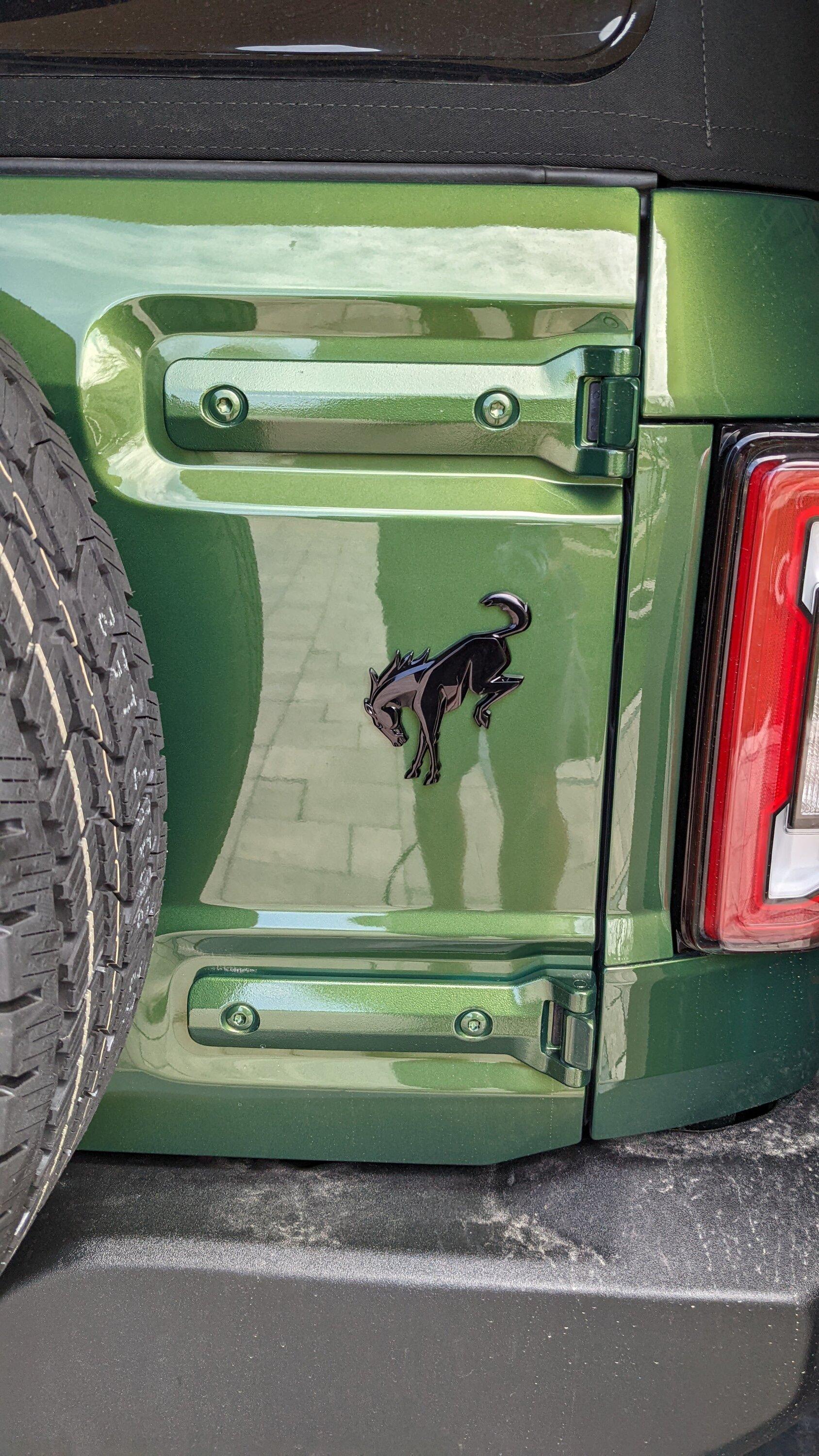

This is a Badlands - but the chrome looked terrible on the white, at least to me.
I don't think the chrome Bronco emblem looks good on any Bronco. IMHO it should be black on all models.
