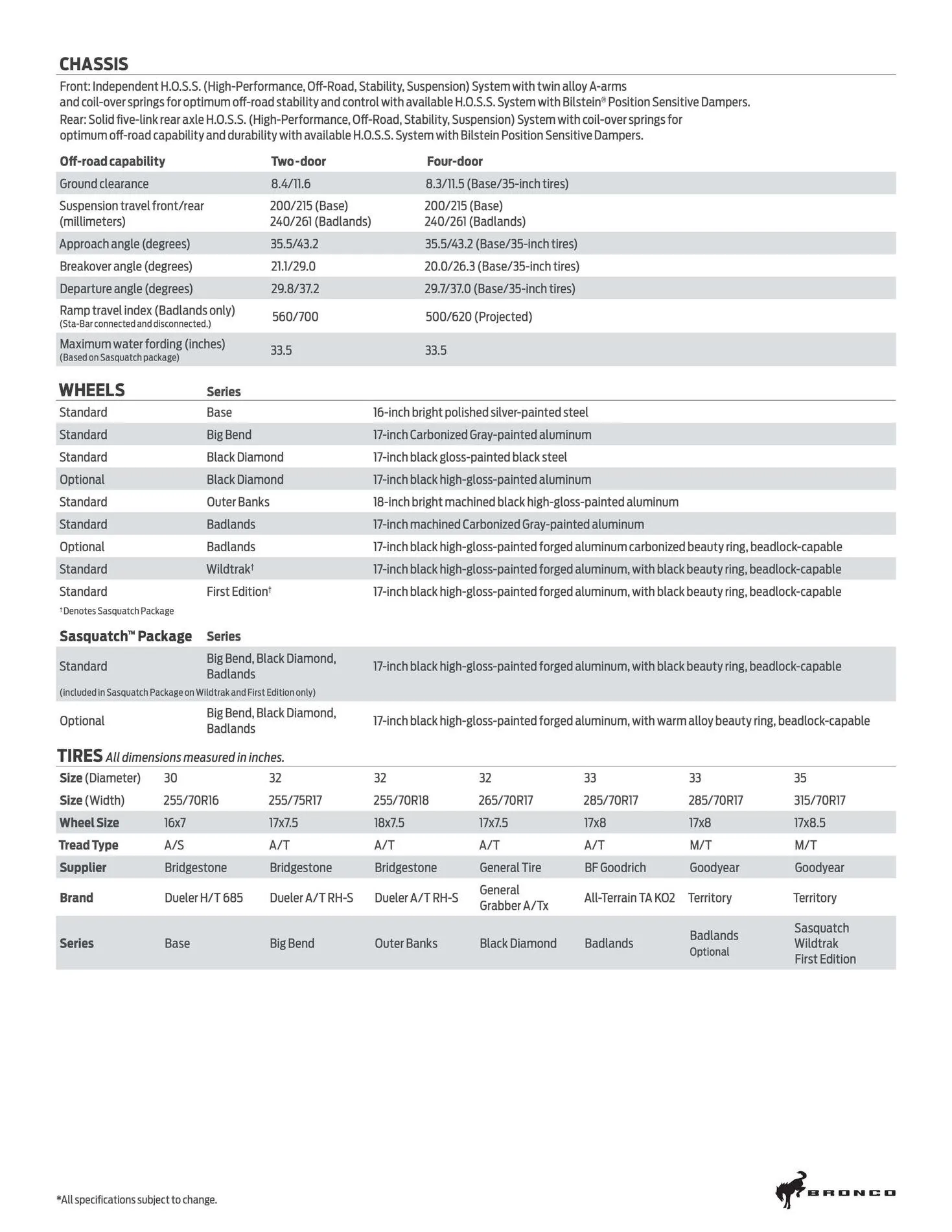

Does anyone know specifically what tire will end up on those who select the AT 33" LT285/70R17? All terrains can vary their looks dramatically...some nearly as aesthetically pleasing as an MT (...almost) and others that look like they may as well be regular all-season road tires.

BFG TA KO2 per the info thread images:

Awesome, not sure how I missed that! Those are some solid looking ATs, so that solidifies my choice. Thanks!
