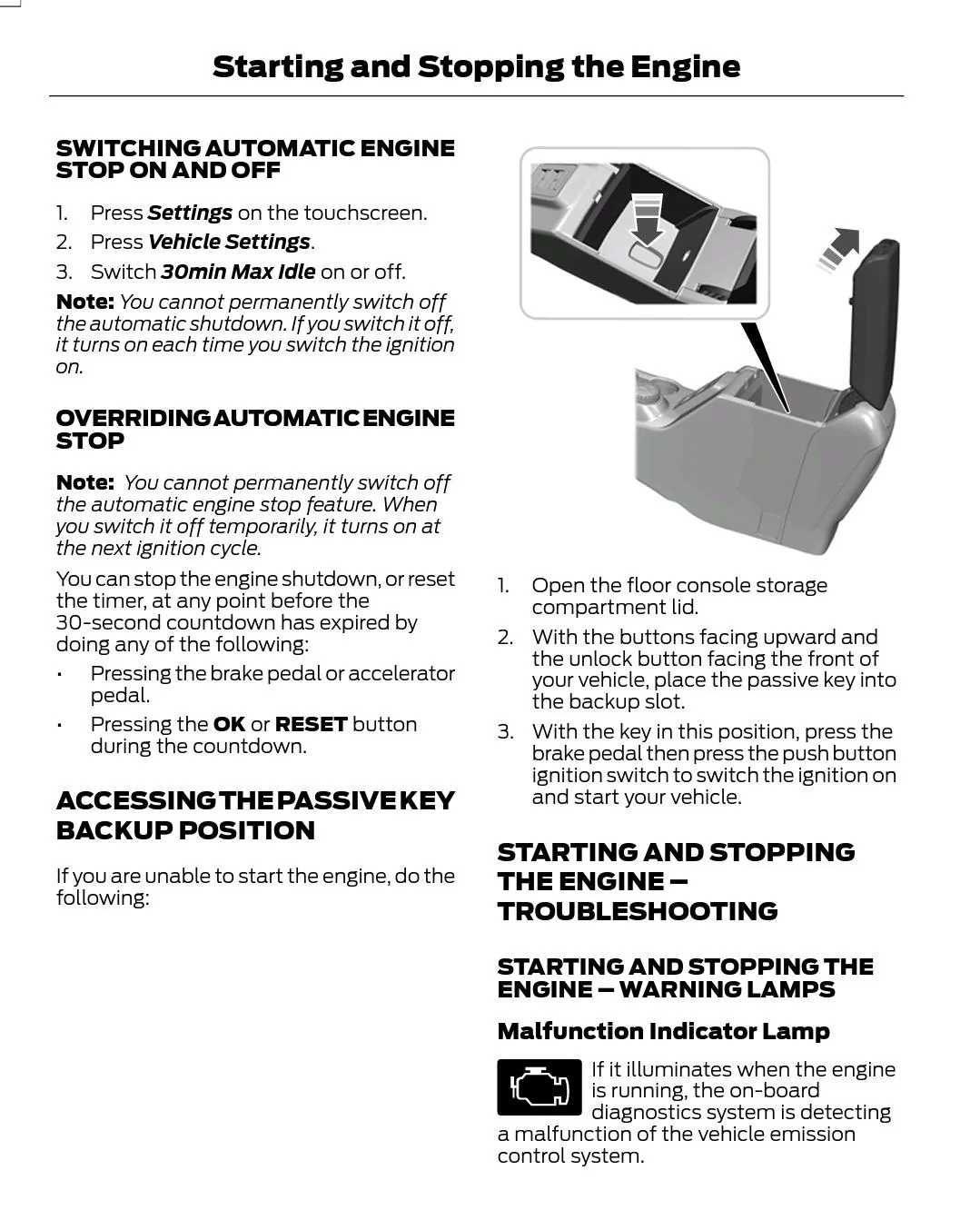

Some vehicles have a “plan B “ for when a FOB fails in starting the vehicle. This usually entails a pop out key, or the FOB end itself ( such as with Dodge). I know the Bronco will have a pop out key for the door, but I was wondering about starting the vehicle.

Look for a symbol in the steering column (where a key normally goes) or in the centre arm rest. Of course, you can always look in the manual.

Ford Bronco When the FOB won’t work. Screenshot_20210724-122726_Adobe Acrobat
