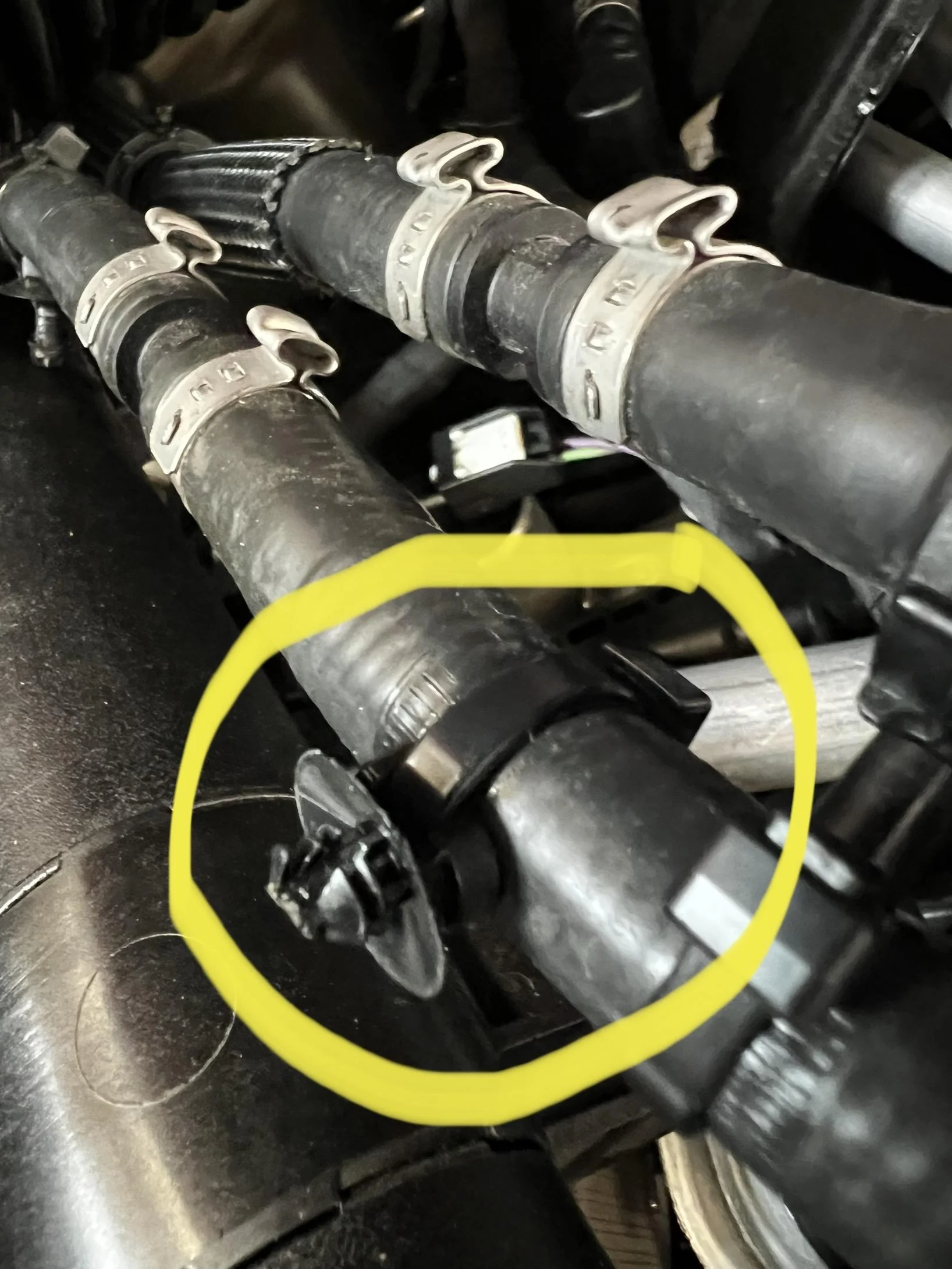

I have a 2022 Ford bronco raptor and I need the part number to the circled plastic piece that I posted. The bracket is connected to the turbo tube on the left side. There is two of them. It's basically a zip tie with a push pen style screw that secures a hose.
thanks
Ford Dealer cannot locate the part

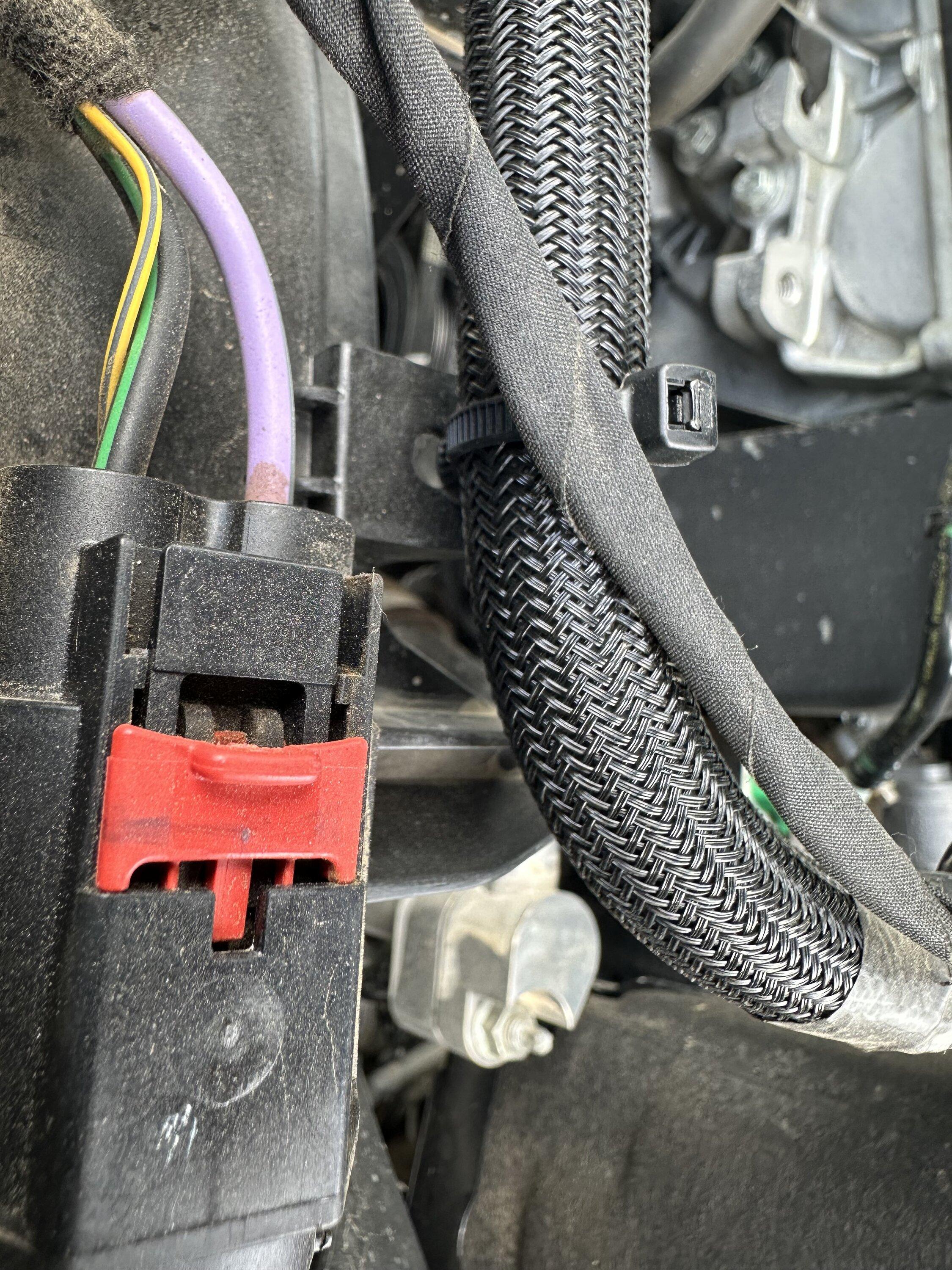

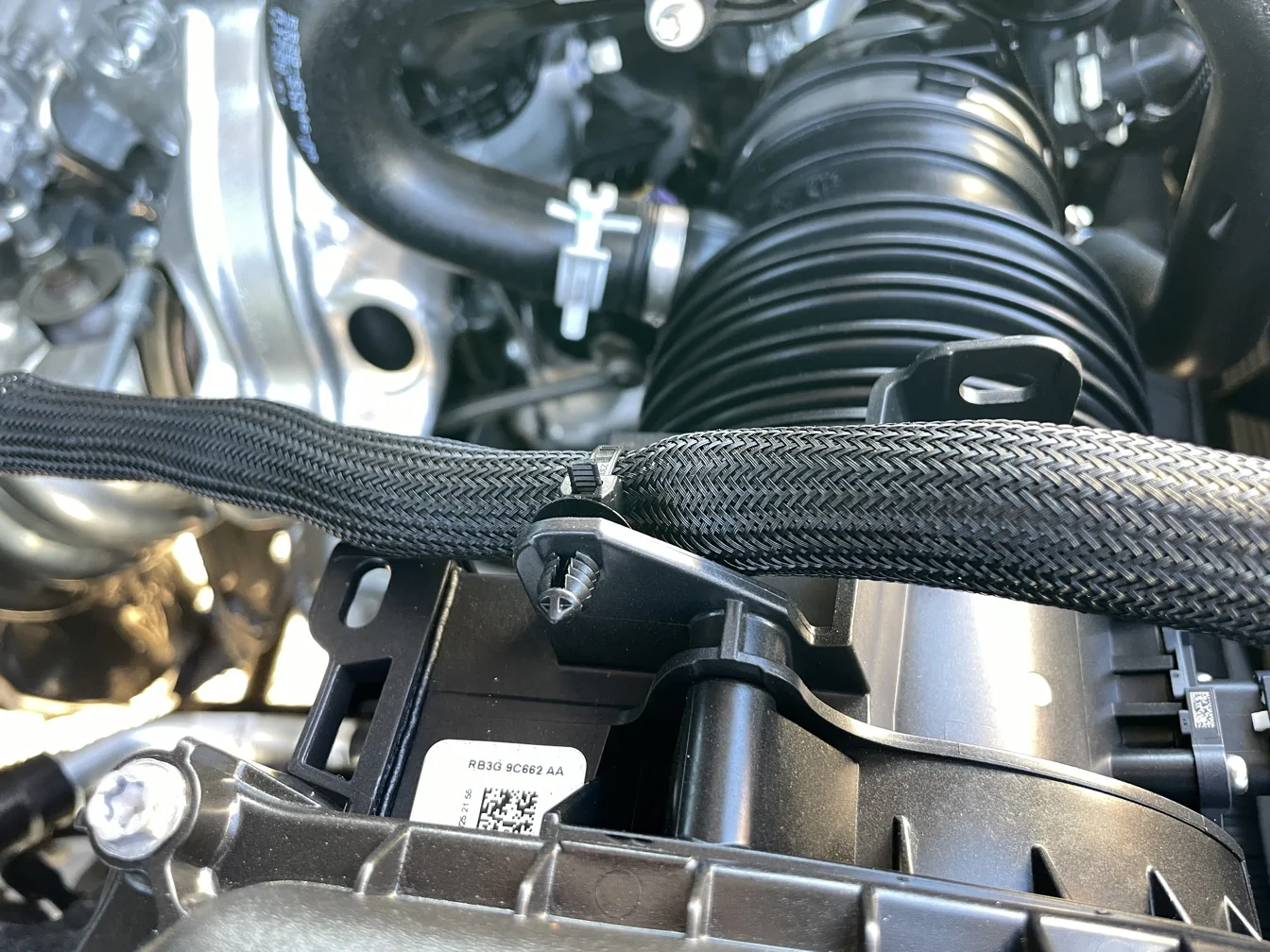

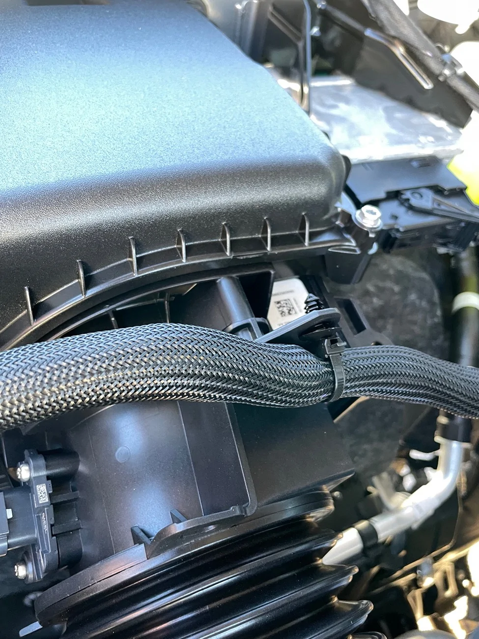

I had one missing on my truck. I used several zip ties in place of this hold down. The zip ties will probably be stronger. I send a pic.
thanks
The company that supplies these fasteners to FoMoCo is called HellermanTyton. These tie mounts come in different shapes and sizes. I'm sure you can find the one you're looking for in this catalog.
thanks
it's included in the assembly. I have the same situation. I broke it when pulling the harness free.
The one I'm looking for is for a water line that's mounted to a flange on the air intake. I have a 2.3L engine.
McMaster doesn't carry it. The have one similar but the fir tree is shorter.
2door is correct. It appears to be made by HellermannTyton. Possibly part number 126-03501.
Digikey wants you to buy thousand of them.
Mouser will sell you one or a thousand.
https://www.mouser.com/ProductDetail/HellermannTyton/T50RTM250HSM4?qs=5aG0NVq1C4xquJFdvBvvVg==
