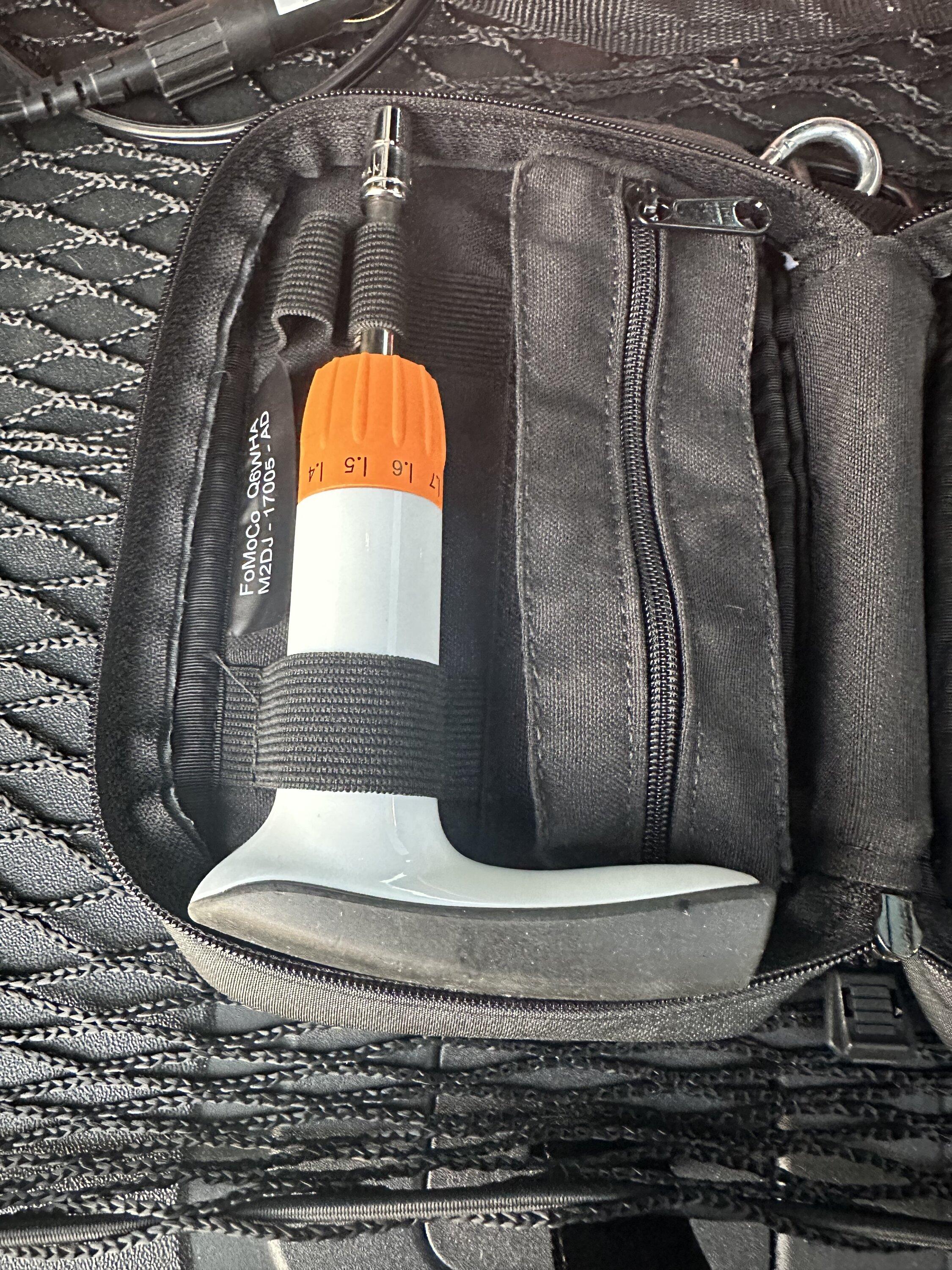

Its the roof rack driver.
Have only had my Bronco for less than 2 months and it came with a roof rack.
My tool kit did not come with this roof rack driver. Did you purchase this separately or did your tool kit come with this?
Haven‘t attempted to take roof rack off yet - do you need this to do so?

If you did not get the roof rack tool, a 7mm, 6 point, socket on a 2Nm driver works.

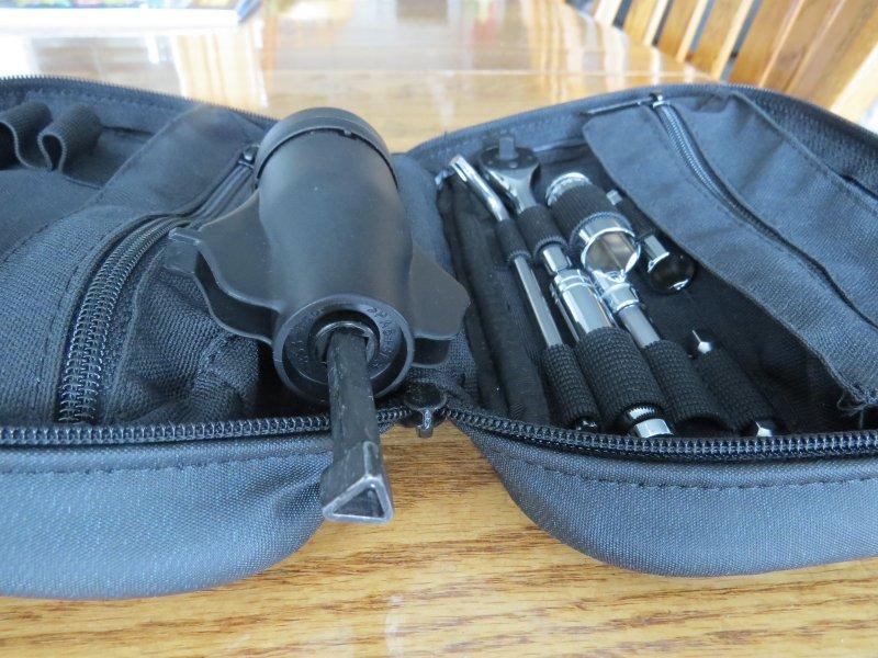

6.5mm socket fits the triangulat screw heads perfectly...
Where in the world does one acquire a 6.5mm socket? I've never seen one. I don't think I've ever seen a socket that wasn't an even number of mm.
In any case, that triangular tool is no longer in my Bronco tool kit. My son bought a 2-door Sasquatch very similar to mine except with a manual transmission and talked me into "loaning" him the roof rack. I'll probably never see it again, and I'm okay with that, as long as it gets used, which it will.
Found it in my huge drawer of misc. metric sockets while trying to remove the roof rack. Probably inherited from my dad (or maybe my father in laws)collection when they passed. Says 6.5mm on the side, I just assumed that was a normal metric socket. Fits the triangle head perfectly.
