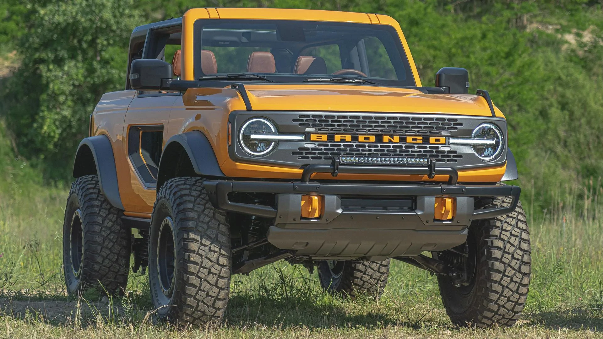

I just got my Bronco and I am new to adding aftermarket stuff to my vehicle as this is my first customizable vehicle. The first 6g bronco I ever saw was the picture of the 2 door cyber orange badlands on 37 tires and it was love at first sight. As you might guess, I'm currently driving a 2 door cyber orange badlands Sasquatch. I want to run 37s on the Bronco and from what I heard, it requires 2 inch lift with 2 inch spacers. I love the way my Bronco feels right now and I love driving 30 mph over speed bumps and the rig just eats it up.
I am not too sure what is required for a lift but I'm guessing different shocks, etc. are needed. I don't want to screw up that great suspension the Sasquatch comes with. If I want to do a lift kit that feels just as nice as the HOSS 2.0, how much should I be looking to spend on the kit excluding the tires? What specifically would I need and what specific brands would you recommend?
