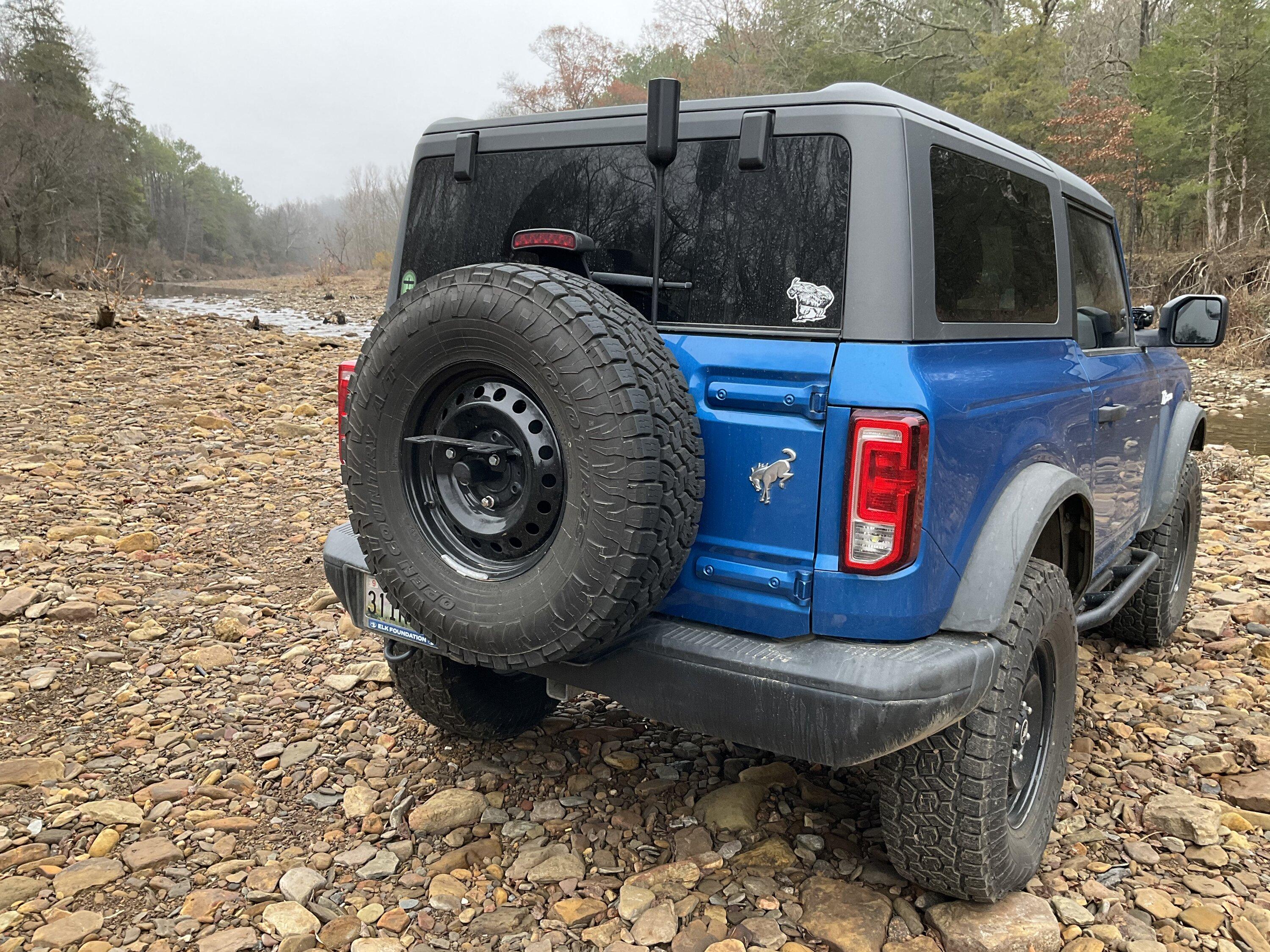

Installed the Weboost in the 2 door and I'm getting slower upload and download speeds with it on. It's got a sold green light, so it says it's good, but I'm wondering if the 2 door is too short to get good separation from the two antennas. I have the antenna mounted on a spare tire mount and the inside antenna mounted near the grab handle on the console.
Anyone have a Weboost in a 2 door and what are your results? Where are your antennas mounted?

Did a little testing with my old school flip phone and an ipad mini. An interesting thing I noticed is with the Weboost in my driveway, my ipad displayed 5G. It has only ever displayed LTE at home and never 5G, so that's got to be a good sign. Download speeds were considerably faster with the Weboost, upload speed was a little faster.
On the road into the National Forest, I really couldn't tell if I was getting a signal more often with it, but what I did notice is without it my internet speed was too slow to even get the test to run at times and looking at email was impossible. With the Weboost, the speed was acceptable and I was able to look at all my email. Downloading pictures on B6G was not really doable, but reading threads was.
On my phone, I seemed to gain about 5 dBm of service. Not much, but could be the difference between making a call or not being able to connect.
Not earth shattering performance, but what I think it will allow is the ability to do more in those marginal areas. Checking email and other internet tasks that may not be ideal but would not be possible without it.

Are you using just the stub antenna outside? Curious if you had one of the taller (few feet high, like an old CB antenna) flexible mounts if it would work better. On an RV forum they always use extended poles to get 12-15' and claim to have better service with it.
Thanks for testing and updating the thread.
What would be ideal is a folding mount on a roof rack so when you deployed it you could get several more feet of clearance. I'm using the smallest extension as I need it to not get caught up in low overhanging limbs. I guess if I was camping taking along the other extensions and using while parked would be good.
