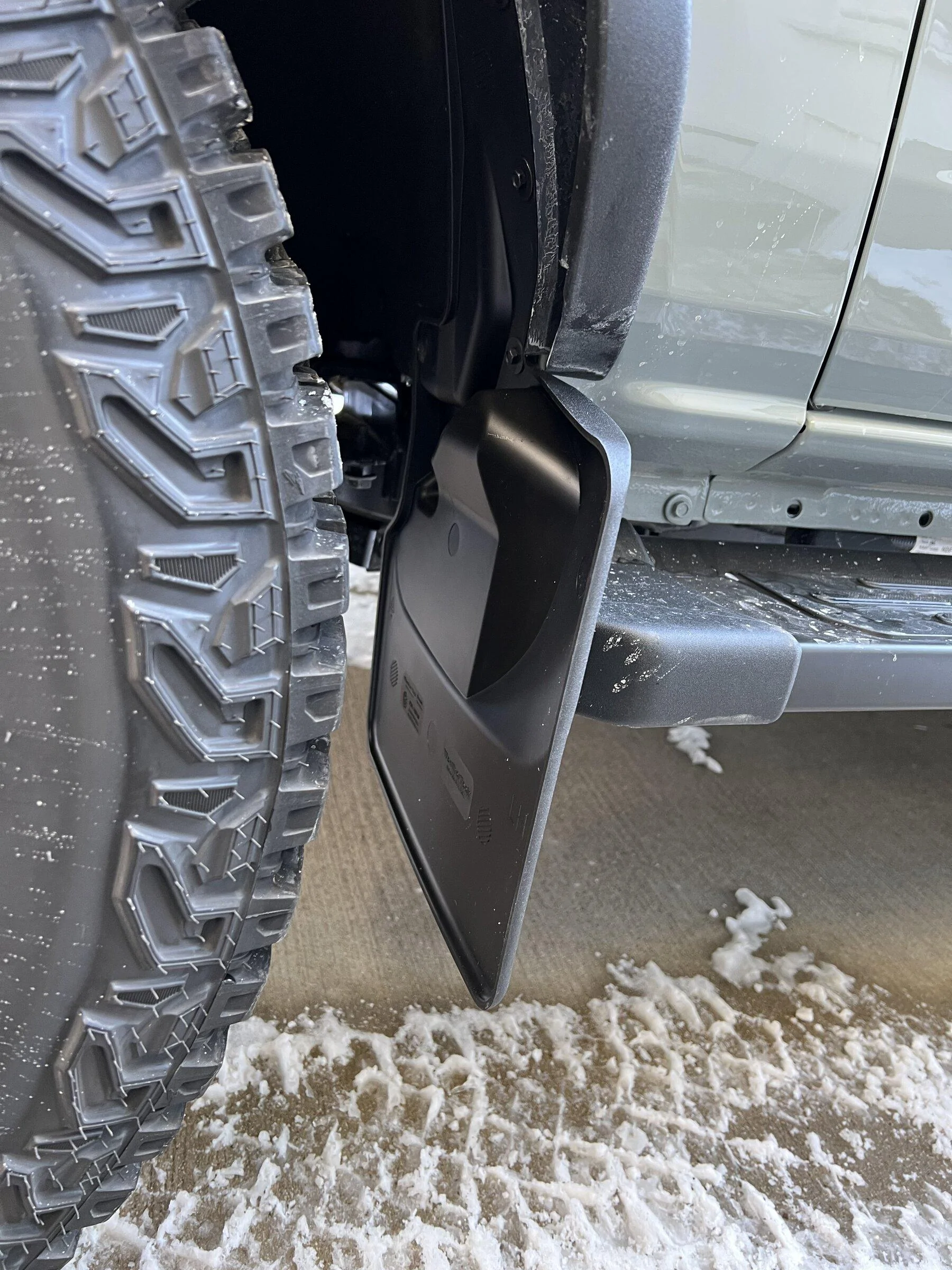

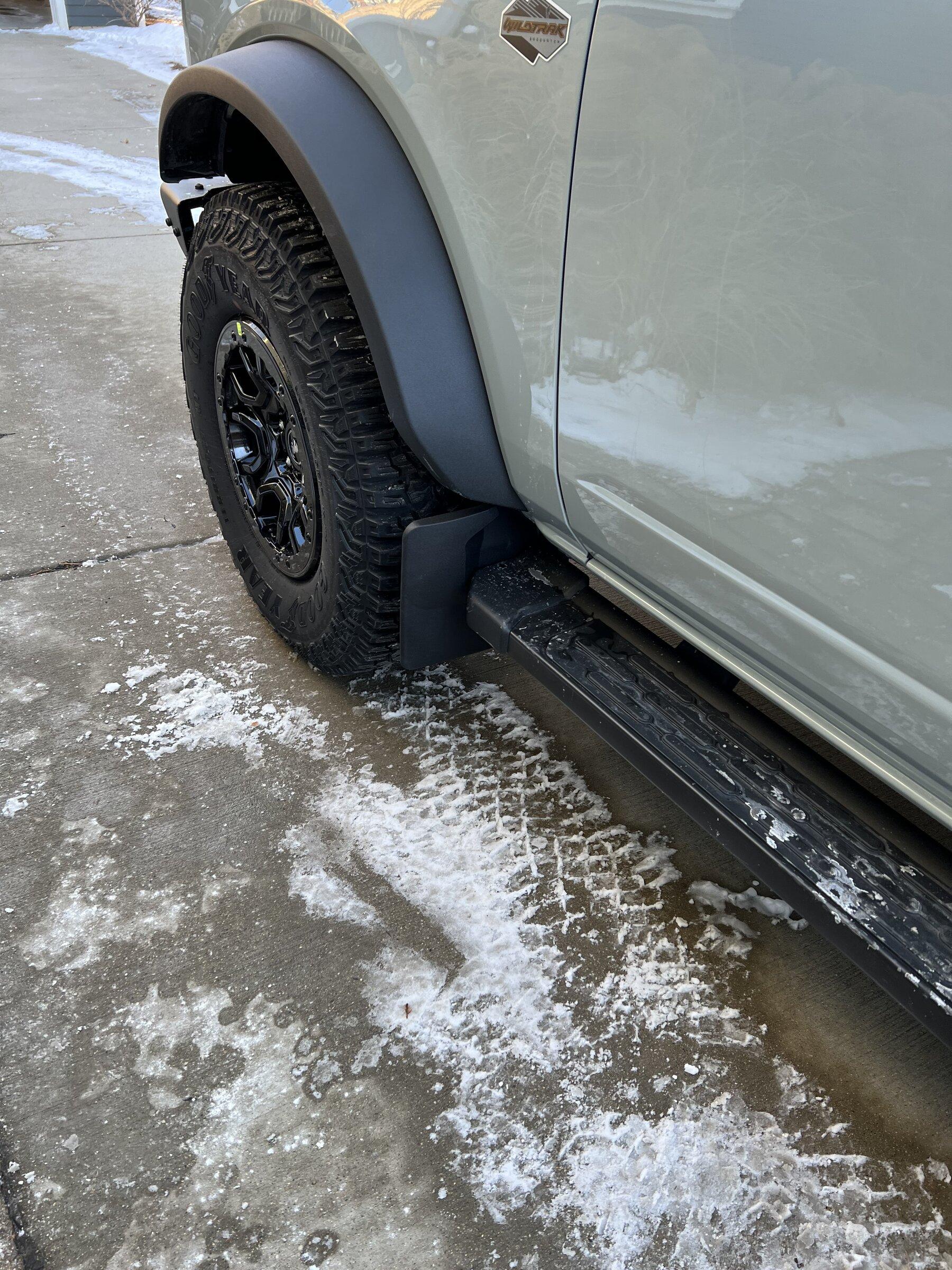

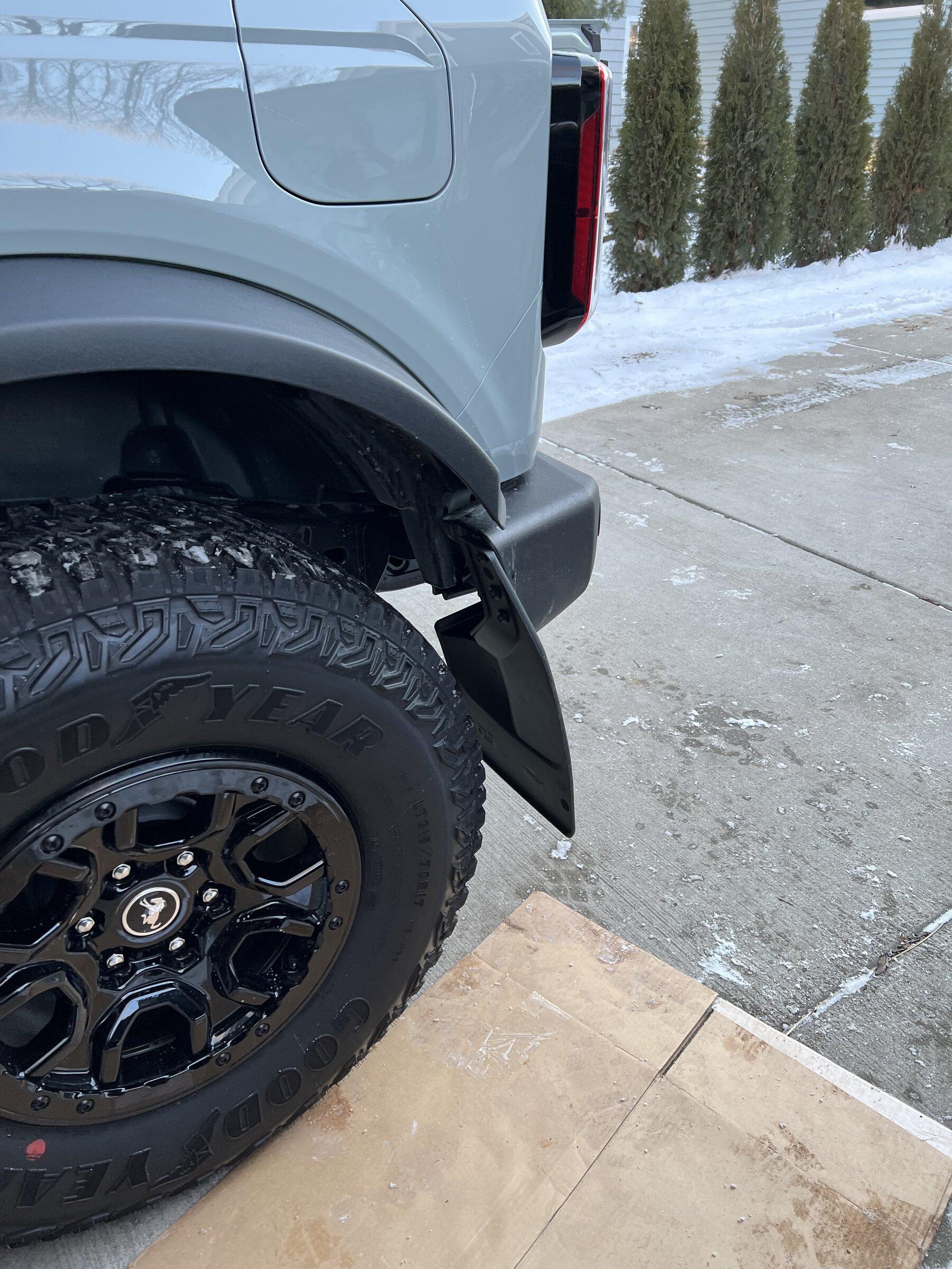

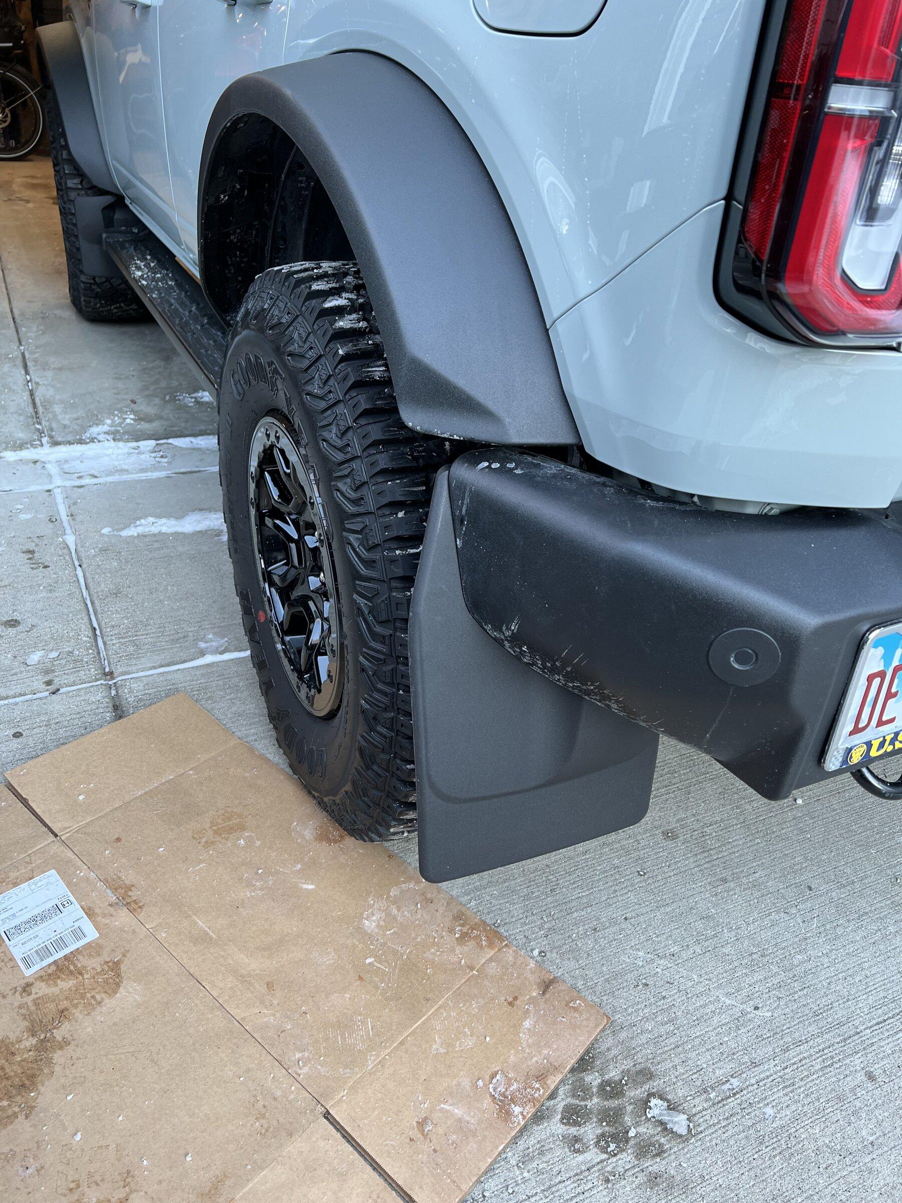

Hey all,
Promised pics ahead...

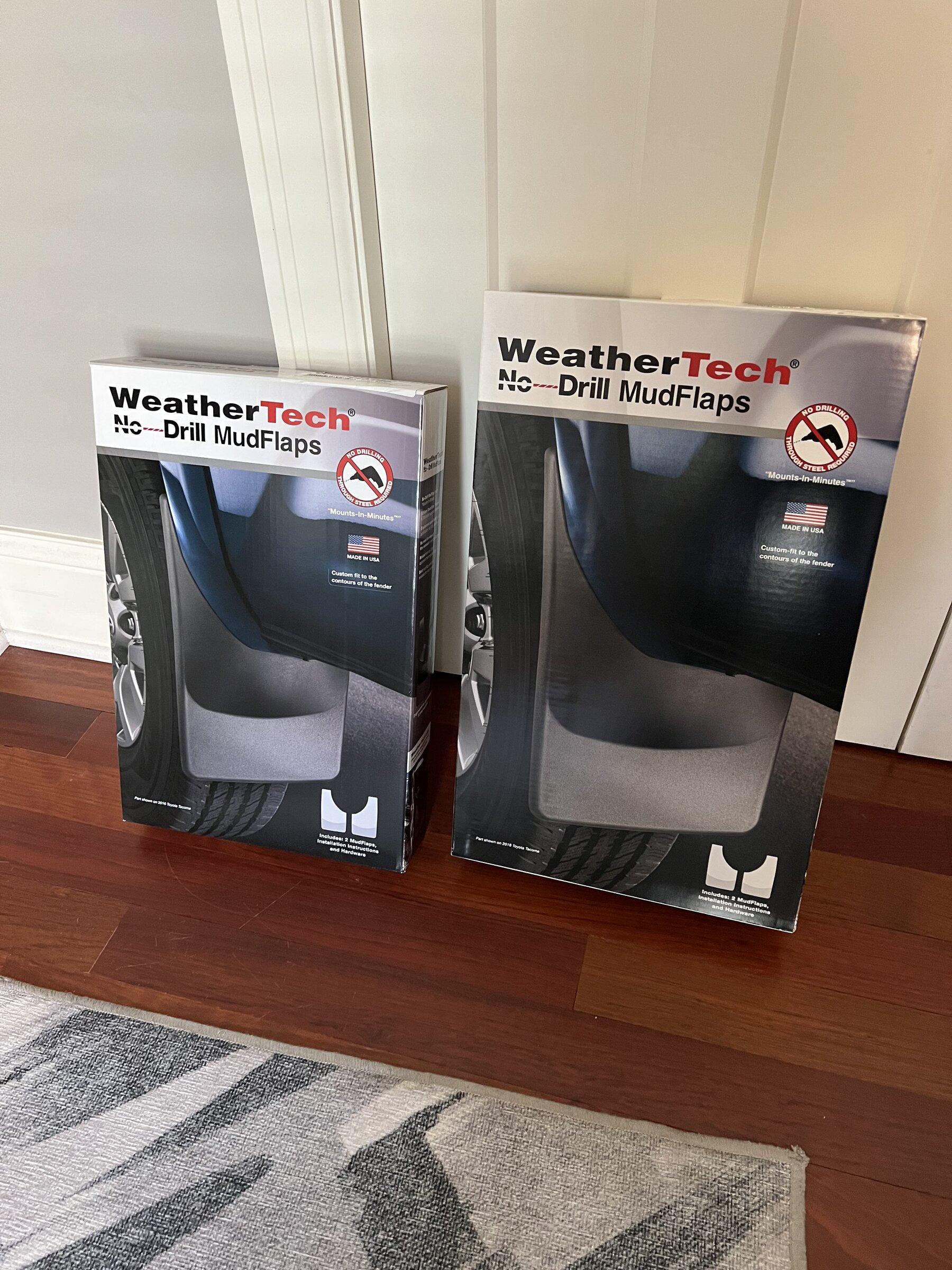

Ordered the Weathertech front and rear mudflaps Thursday evening and received them today (Saturday). I only live about 45 minutes from their Bolingbrook HQ so it was a pretty quick turnaround.
TL;DR: These look better in person than I expected.
Installation: This was pretty easy for both front and rear. The biggest challenge was that it's a pretty tight space in both locations, but as long as you have the right tools it's a piece of cake.
Speaking of tools, the instructions were straightforward and easy to follow, although they tell you you need a socket wrench (for front and rear) and a Phillips head screwdriver for the front, but they don't tell you what sizes of sockets. I'm here for you though, fam: you'll need an 8 mm for the front hex screws and a 10 mm for the rear hex screws. You'll also need a 15 mm for the two rear bolts. Oh, and you'll definitely need an extension for the rear two bolts (I used a 3/8").
In all, installation took about 45 minutes total for both sets. Once I got one side on, the other side went quicker because it was just the same thing in reverse. I found the passenger's side easier because I'm right-handed, so it made it easier with the tools. Oh, and it was 20 degrees out and I was wearing gloves, which may have slowed me down a bit. :)
It was nice to have a no-drill installation. You will end up replacing some of the original parts, so I recommend you save those if you think you might want to remove these later. Specifically, you'll replace four original fender liner screws on each side in the front, and you'll also remove three hex screws and the little plastic trim piece by the fender in the rear. These are now safely in a ziplock bag in my garage if I ever need them.
Fitment: No complaints here. They are well-engineered (as far as fit is concerned) and there were no issues at all fitting them on the Bronco. Also, you can tell that these things were really made with the tube steps in mind. The indent fits well around the end of the steps. Also, it's a very solid connection once mounted.
Looks: I know this is the most controversial area. Honestly, the gap is certainly there, but it's not as bad in person as it looks in pictures. And with the tube steps, I think this is actually not a bad look. I was honestly more on the fence about the rear flaps, since I thought it would really mess up the rear profile view since the flaps partially obscure the badass SAS tires. It does change the look, but I kind of like it. I think it gives the Bronco a wider, more aggressive stance. Anyway, let me know what you think. Again, I believe both the front and rear look better in person than they do in the pics... somehow it's just like that elusive Cactus Gray color—pictures just don't do it justice. :)
Functionality: We'll see how it is long term, but I went down the street where there was a short stretch of snow slush left. I put it in 4WD and gunned so I could get all four wheels spinning. Results? I didn't see any spray on the body. It was about to get dark so this was just a quick test, but I'm heading up to Wisconsin to do some snowboarding tomorrow so we'll see how it fares on a longer road test.
So anyway, pics...

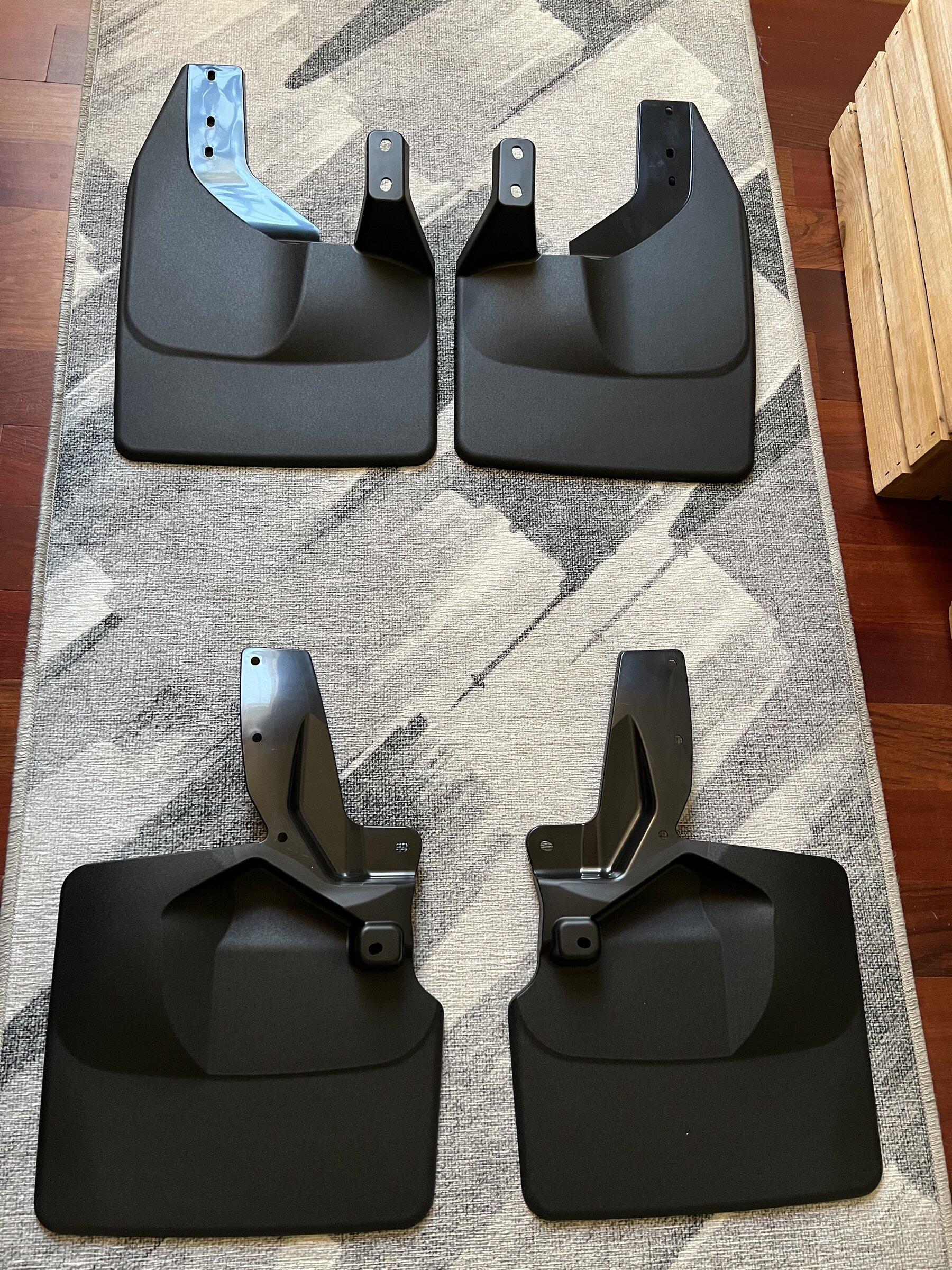

Boxed front and rear flaps
Both sets of mudflaps (rear at top, front at bottom)

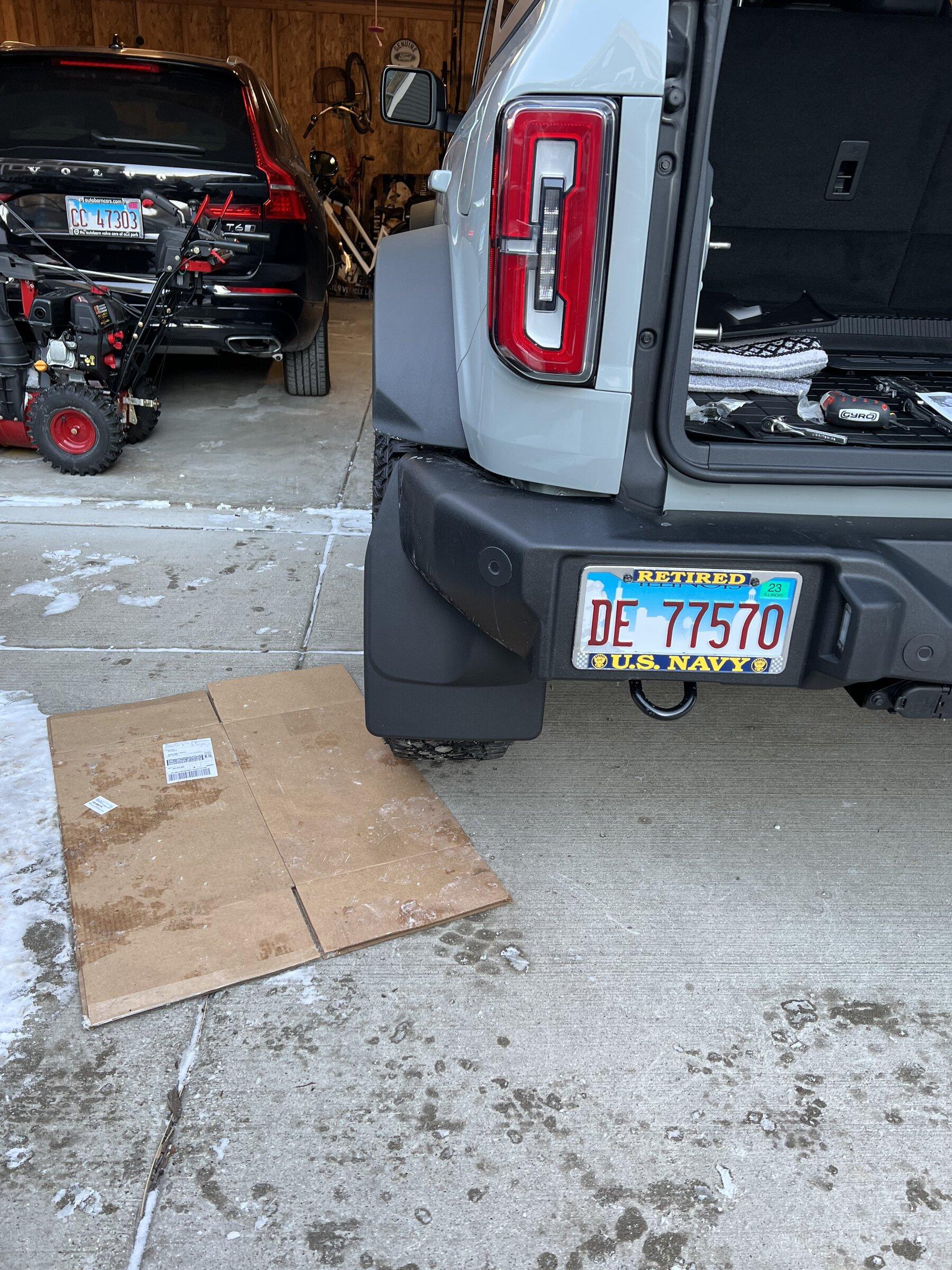

Pre-installation. You'll want to turn your tire all the way to the right to provide clearance for driver's side installation and the opposite for the passenger side.
Rear wheel, pre-installation. You'll be removing that little plastic trim tab attached to the bumper.

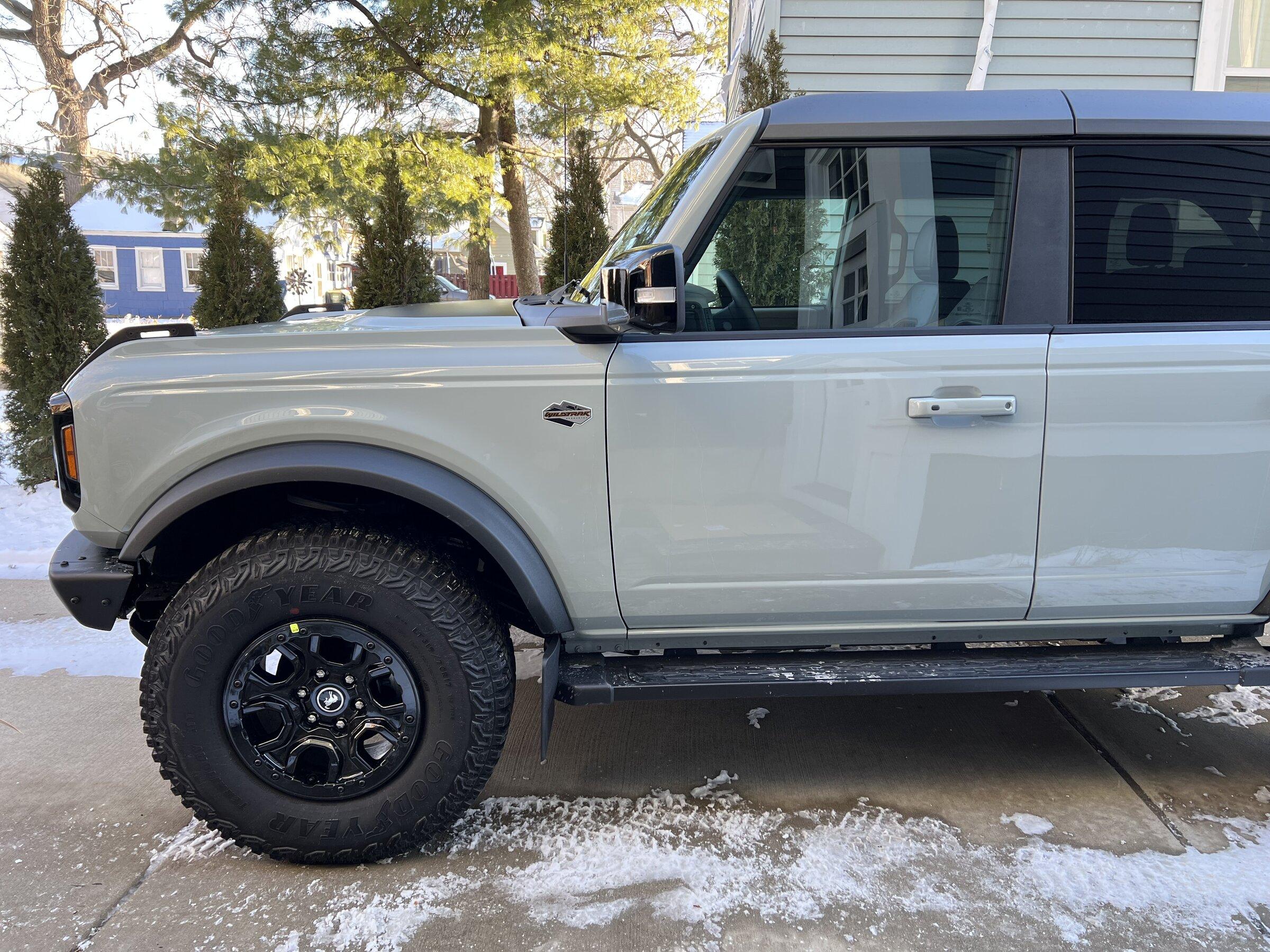

Front flap installed
This is the fender liner location where you'll remove the screws. It may have been easier if the liner wasn't frozen, but it was still pretty easy to remove the screws and put the provide U-clips on.

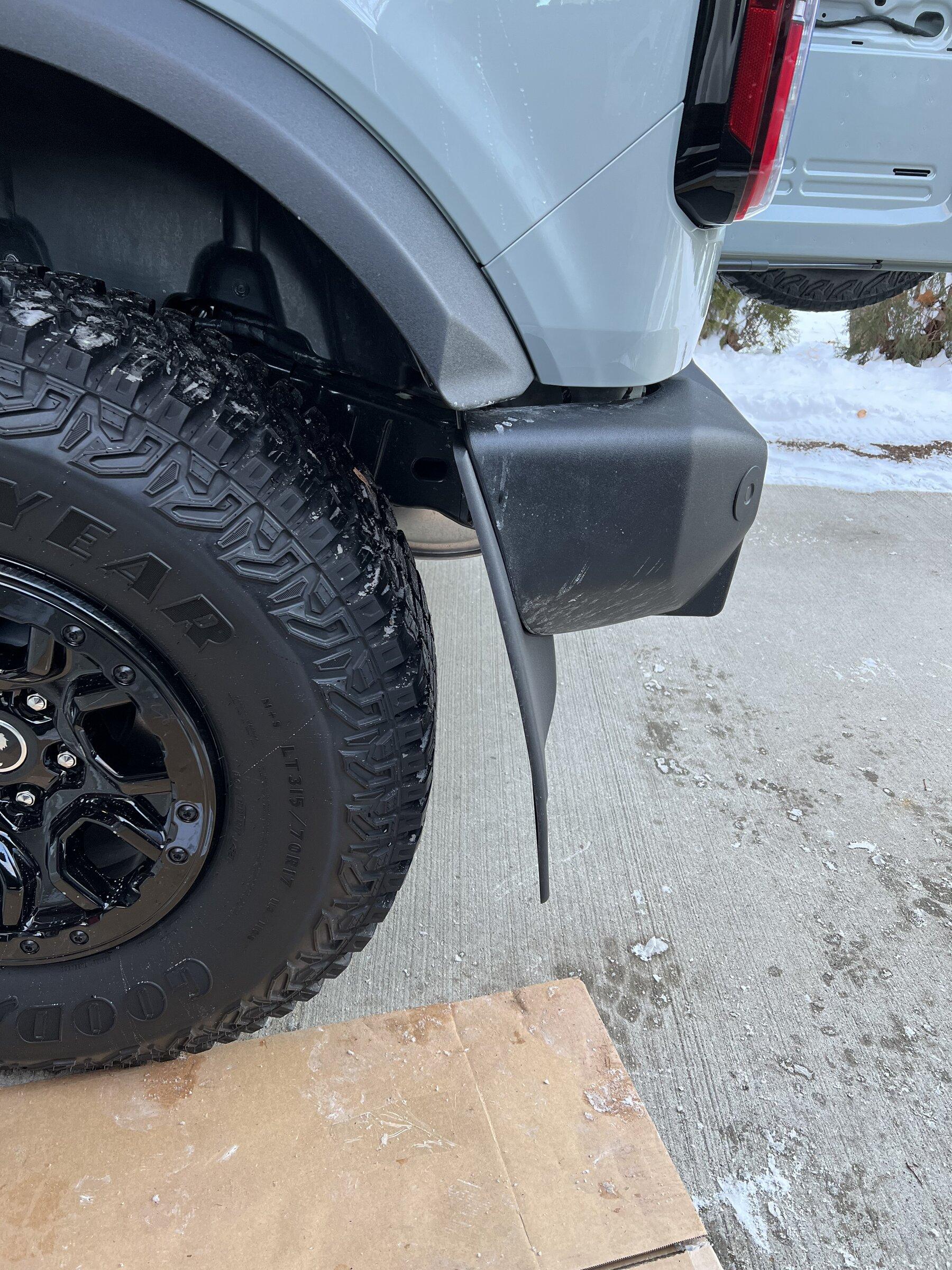

Rear flap installed. If anything, this was even easier than the front.
Well, that's it. Hope this was useful. Let me know what you think.

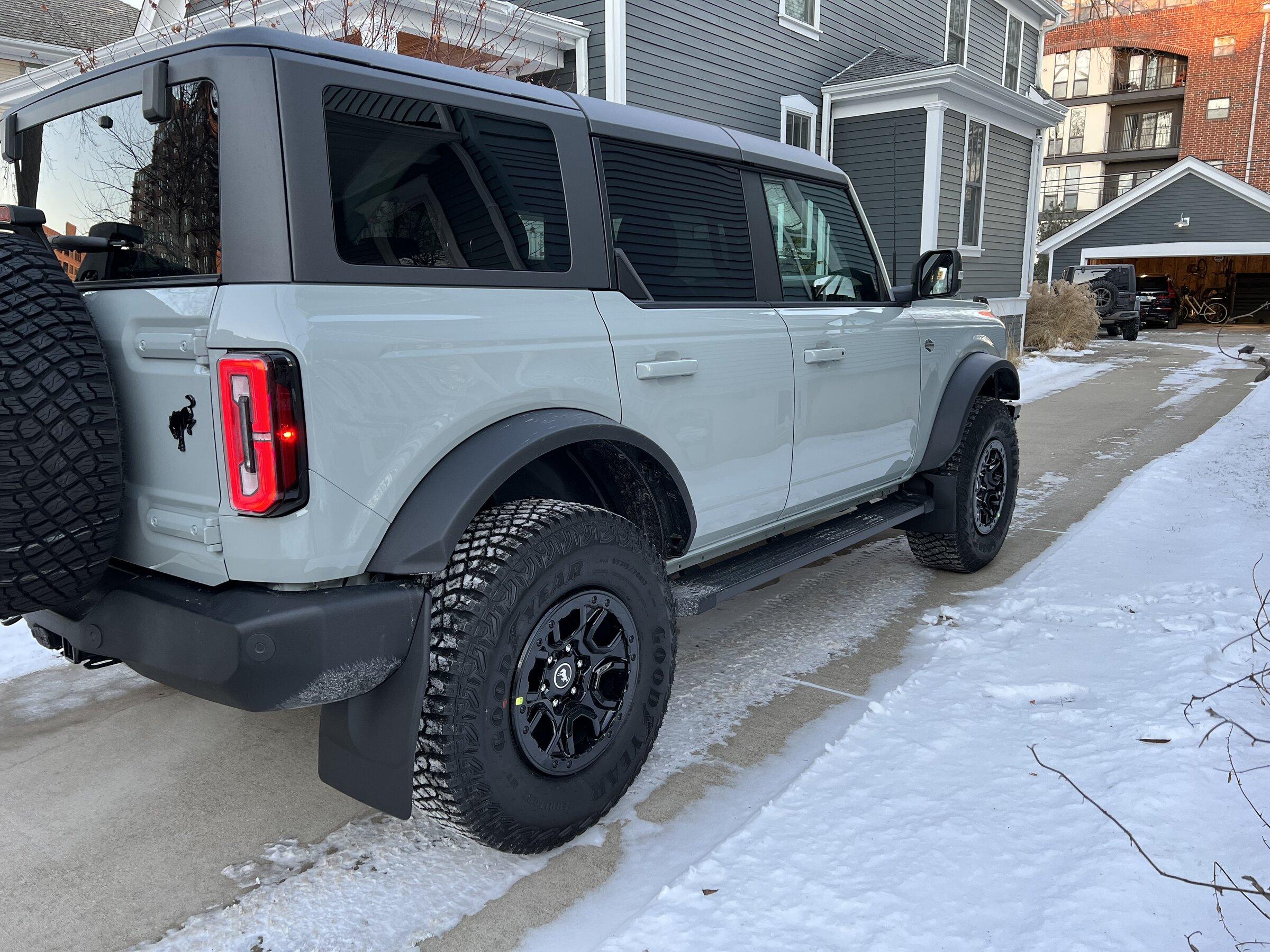

Got them installed yesterday (front onlyP) before multi day snow storm came through. Hoping they keep the slush buildup on the rear flare and the door handles cleaner. We will see after a couple days.

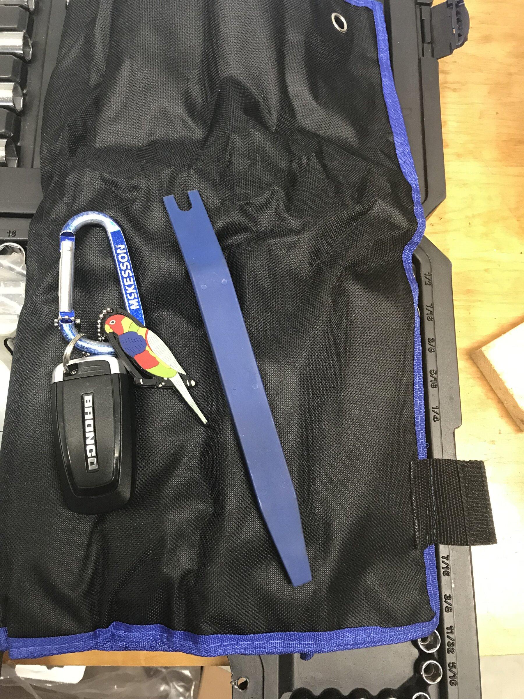

if I could add cheap set of tools for removing those plastic push pins.
This was the first project I didn’t break a single one.

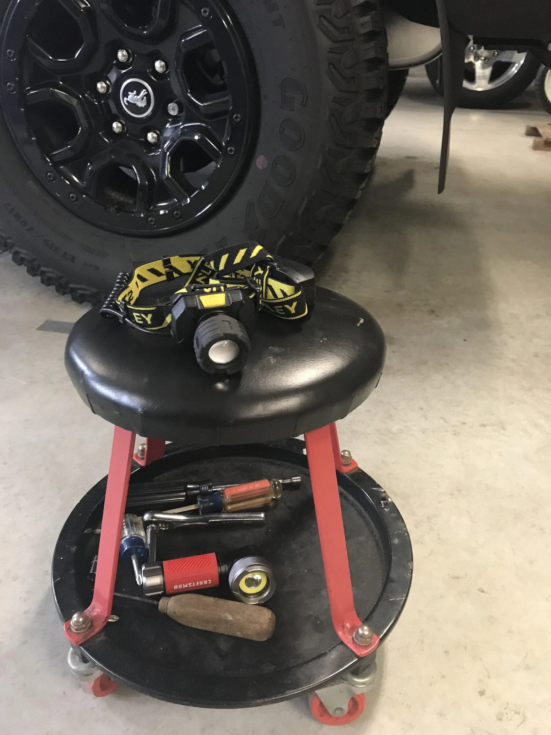

Space heater makes working in cold garage bearable.
Ford Bronco Weathertech - Mud Flaps - "Coming Soon" on Website 1645556194504
Headlamp looks geeky but helps immensely.
An awl or ice pick to punch hole through felt fender liner.
8mm deep socket for the front flaps.

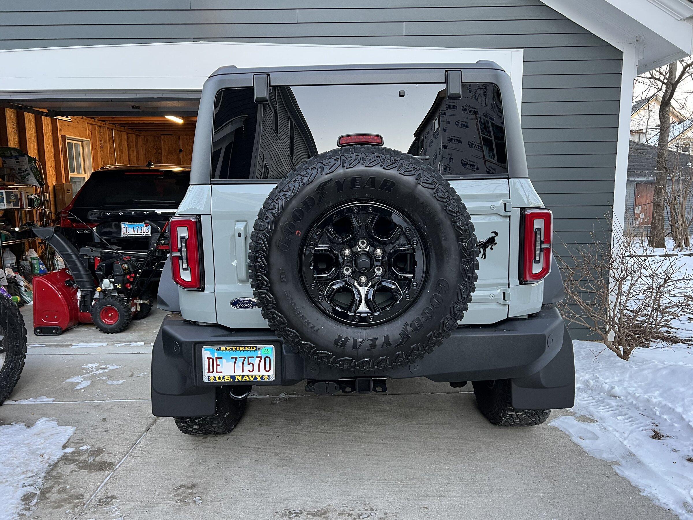

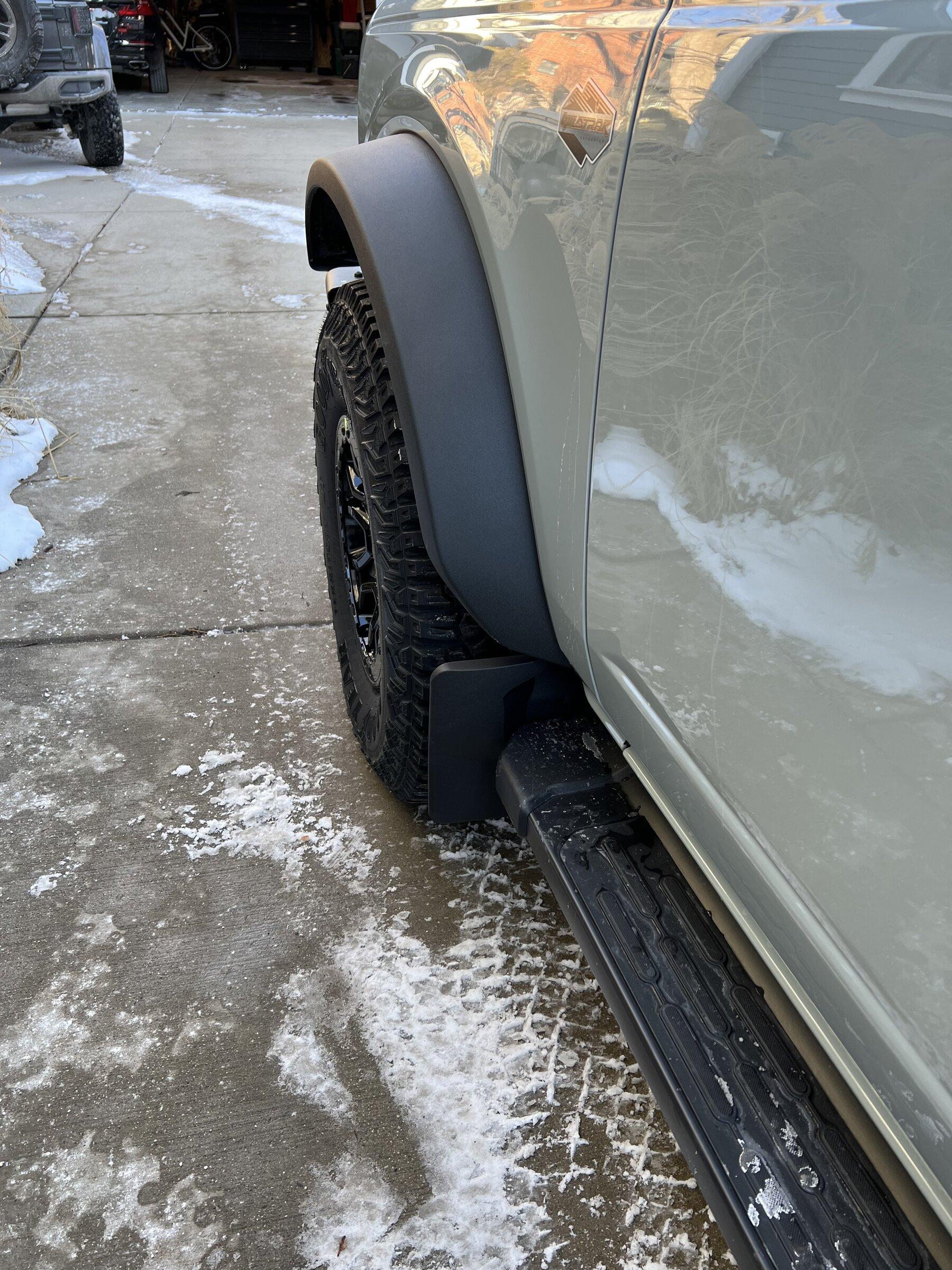

The gap on the front is still notable but I’m hoping I’ll get used to it like I got used to the gloss black grill and mirror caps.
Ford Bronco Weathertech - Mud Flaps - "Coming Soon" on Website 1645557073217

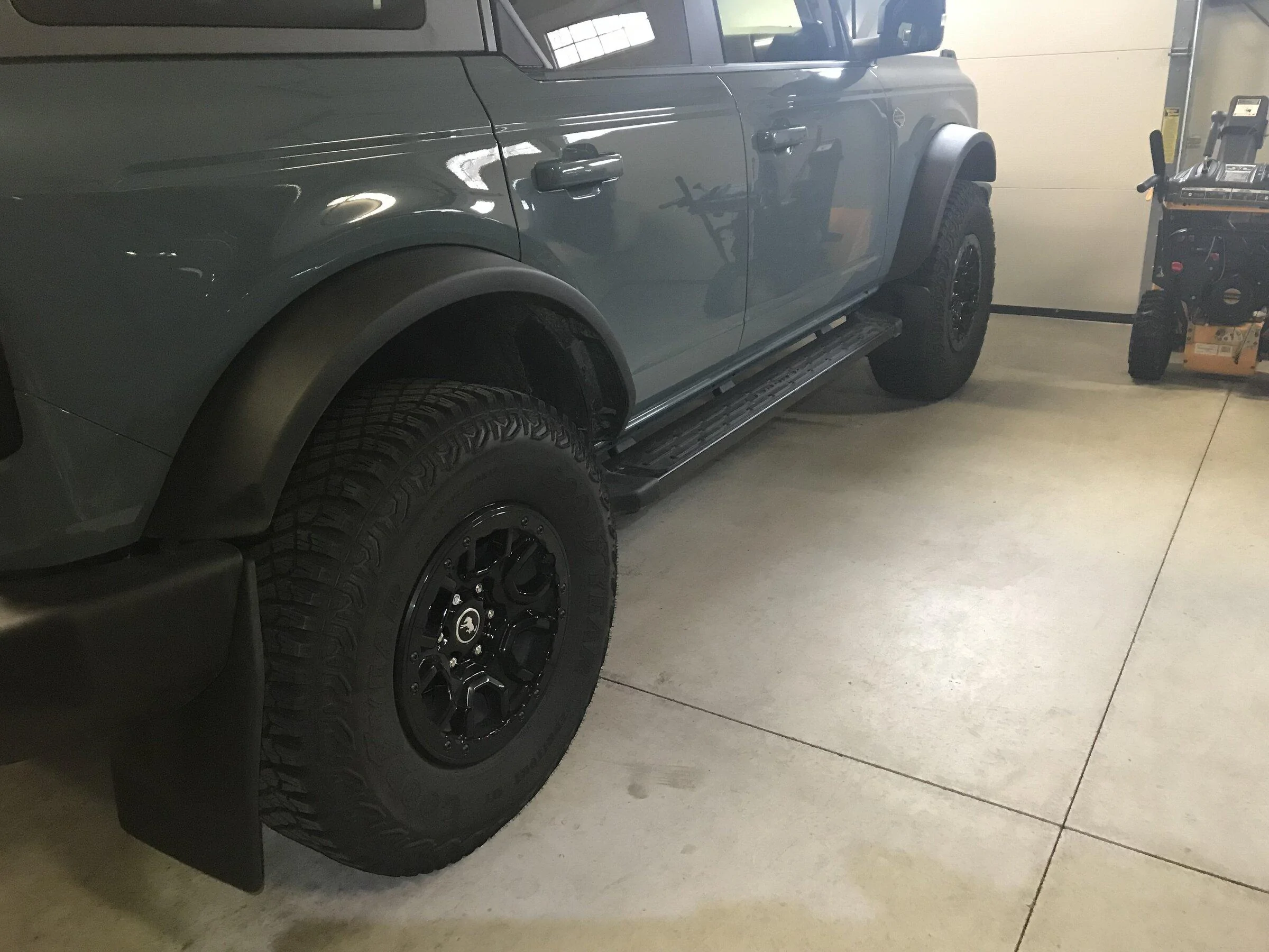

Are they perfect? Hopefully they will eliminate the winter process of sweeping slush/crud off the rear flares before allowing rear seat passengers to get out.
