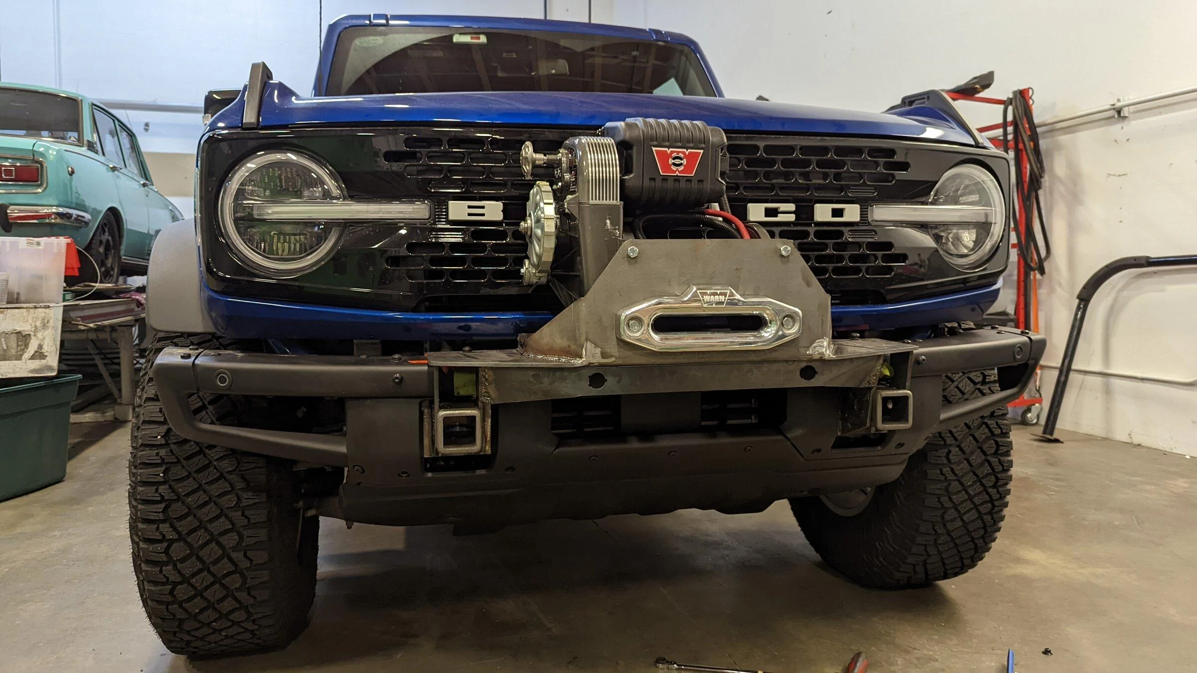

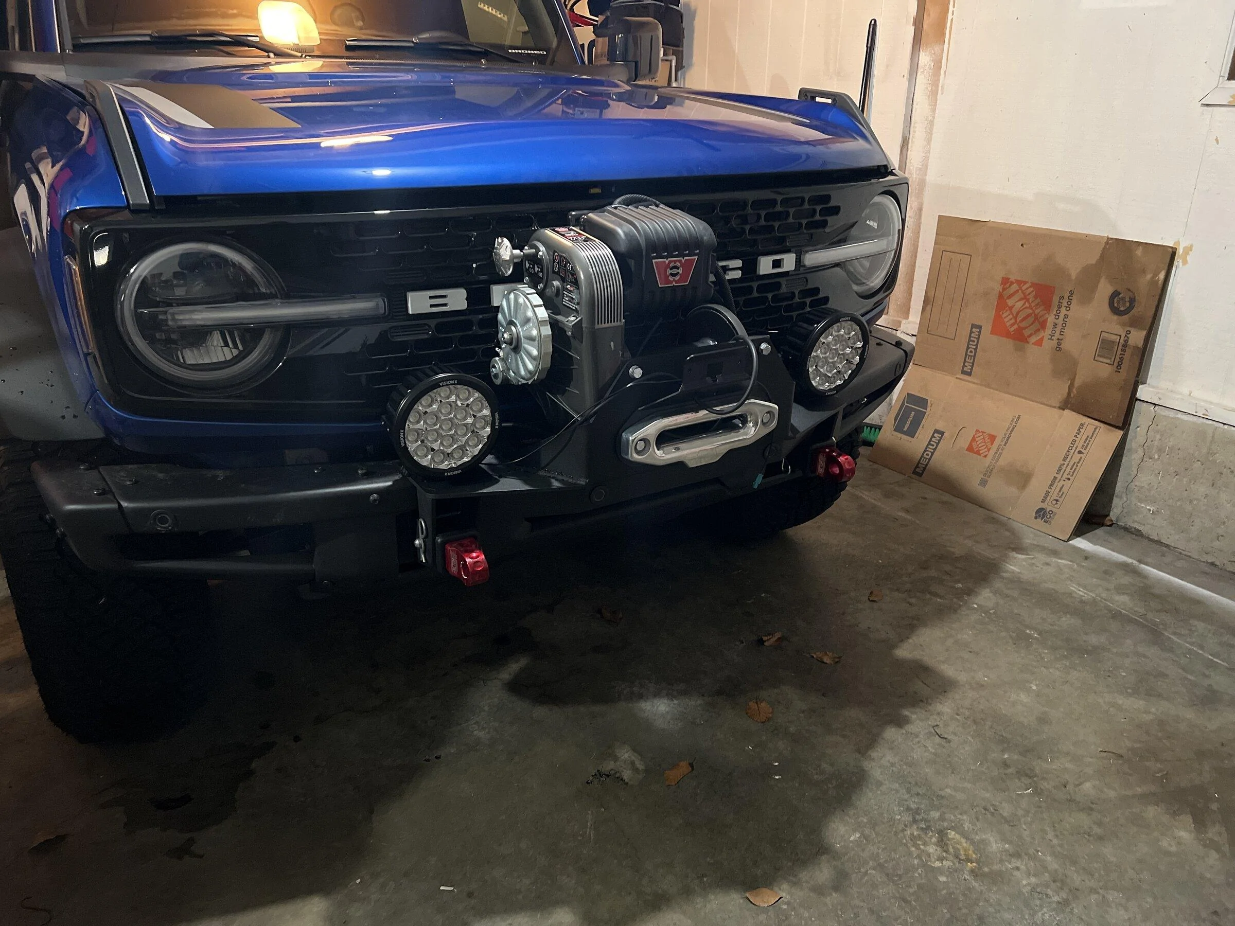

Bunch of wiring to clean up. Replace the Warn fairlead with something else (it interferes with the JCR camera relocate), aim the lights (VisionX Transporters in 18 LED and a custom 90 degree pattern, I want them for slow speed off road, not bombing down the road) Super stoked the way it turned out
ACC was not relocated and it works great, Parking sensors relocated and work great. Front camera relocate works great. I will get some screen shots tomorrow when it's light out.

Looking good. Can we see a side shot from a distance to look at the approach angle?

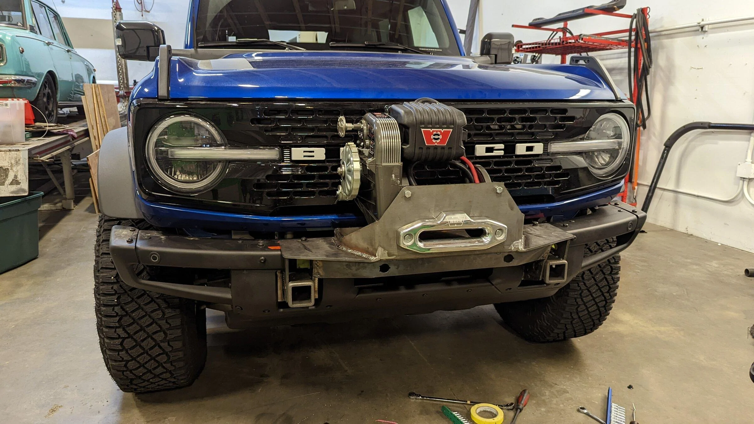

Of course, it was getting late last night... Still not happy with the power cables/camera cable... but it is getting close. When I remove the hitch links, I don't think I have lost any

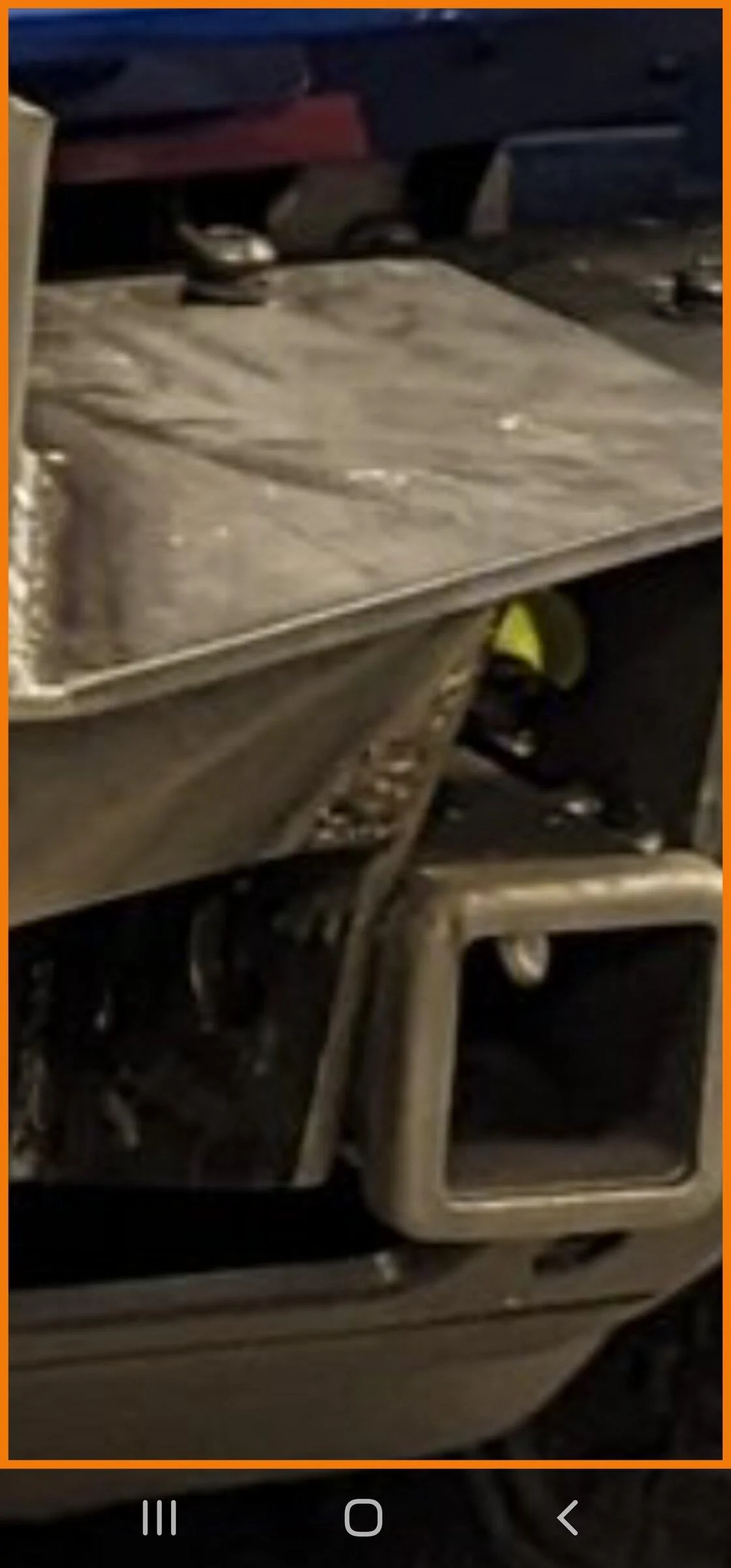

Still want to redo the power cables through the grill- waiting on some right angle battery crimps to re wire. New camera cable on order so I can drastically shrink the split loom to the camera.

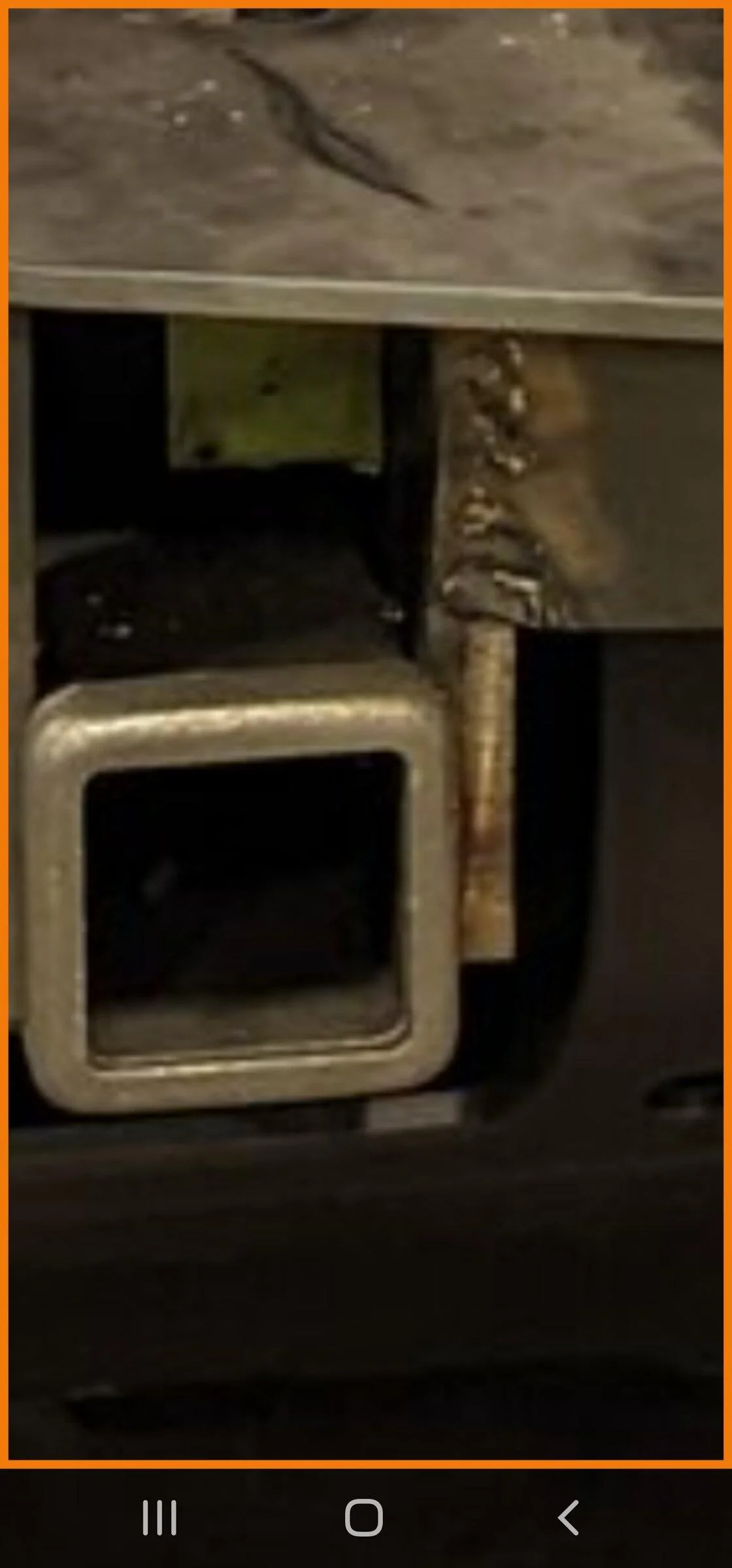

Non identifiable photo is the outside frame horn brace. I braced both the side and outside. The receiver tube is sunk into the frame and through bolted as well
