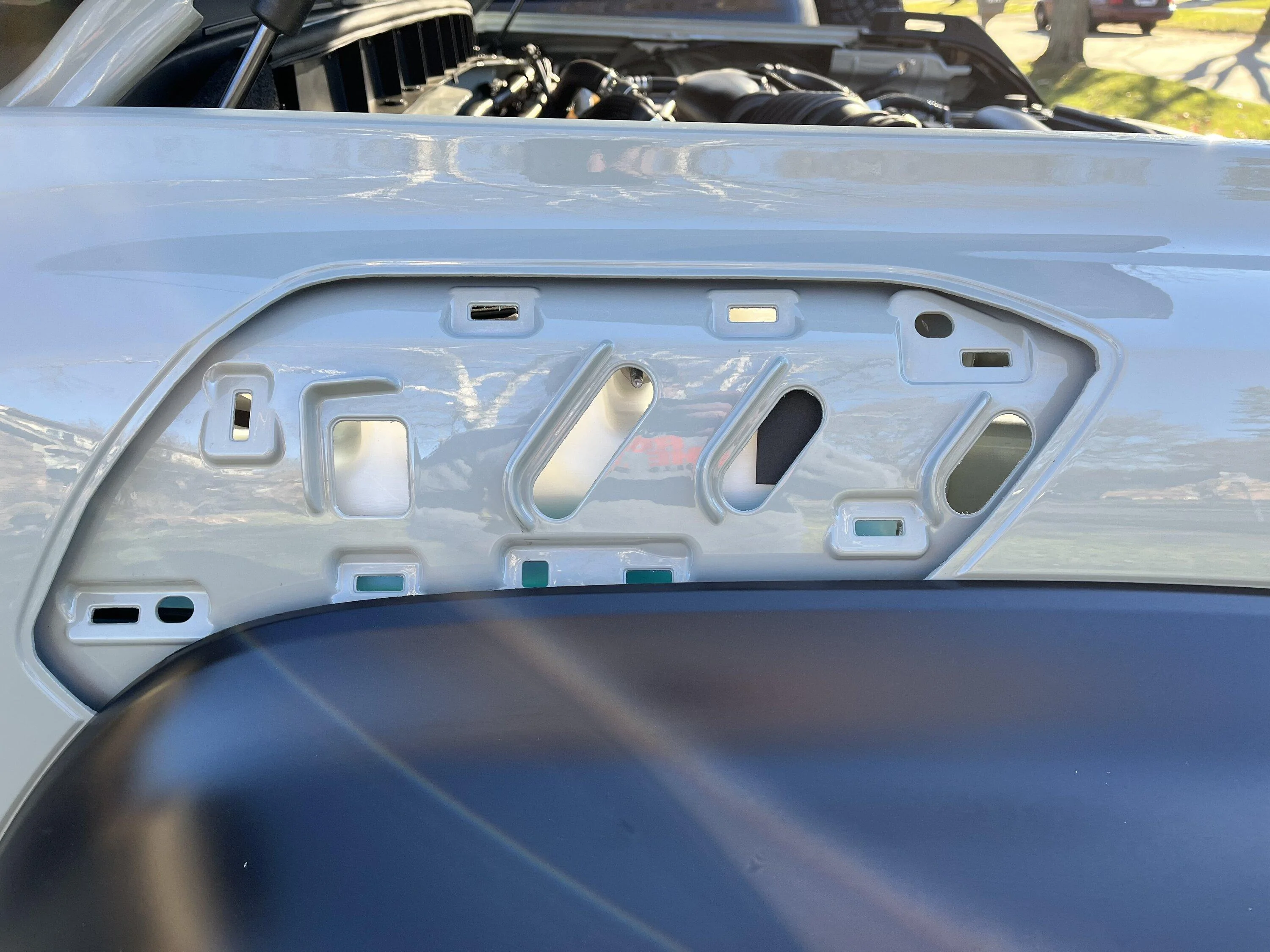

Removed my vent to wrap it. Ooh boy does that removes hard due to the long overlap that goes under the fender flare.
Concerned that I won’t be able to reinstall if I don’t remove the entire fender flare.
Anyone do this yet? Any tips on reinstall?

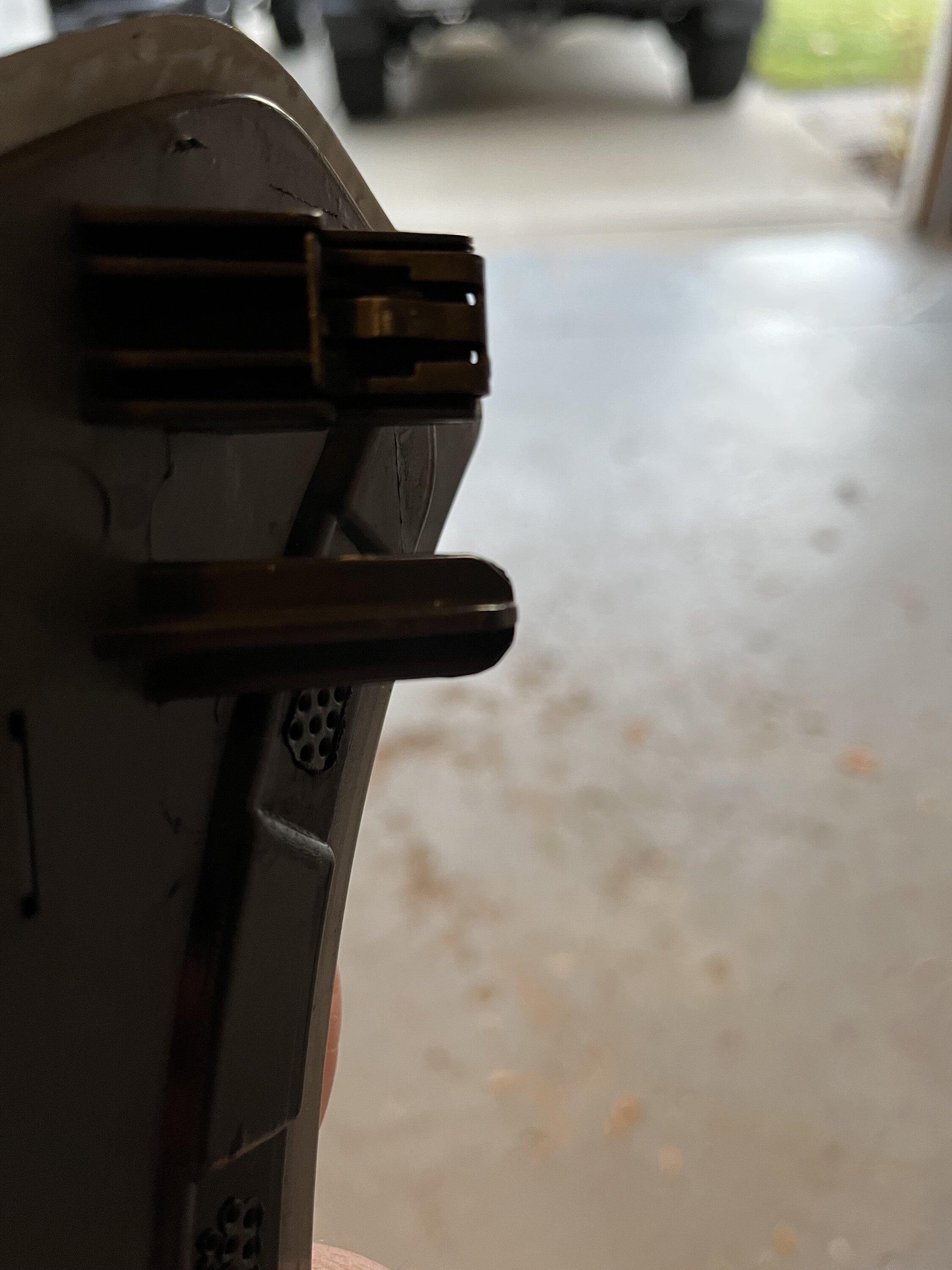

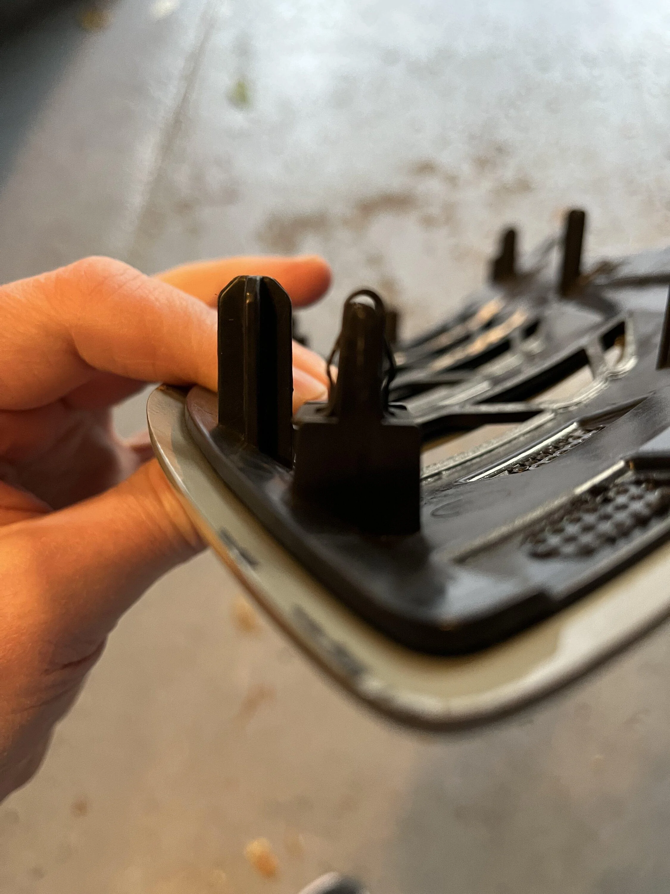

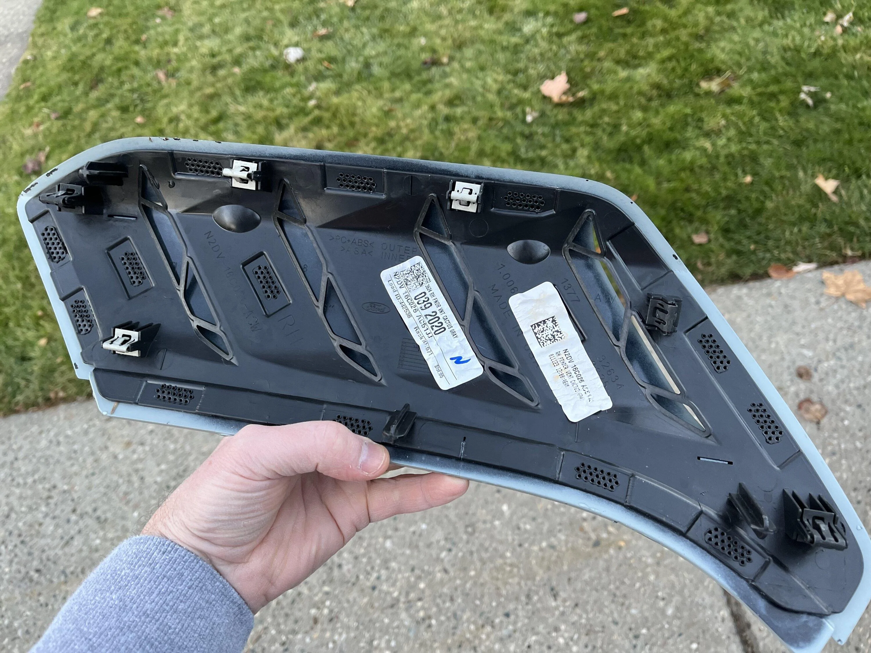

My opinion is that those very long locator pins are an assembly aid only and if I trim them off completely the fit will be no worse as location is done by the 6 clips. Will study the design a little more but might try that before pulling the flares
defector69
Apr 17, 2023
43
2023 Braptor
The locators are slightly longer than the nearby clips so they are for assembly. Two locators fit into horizontal slots so they don’t set position; one locator fits into into a hole so maybe I will keep that one if I can make it work. I might be the Guinea pig on this and cut the locators. 6 clips - 5 horizontal and 1 vertical seem overconstrained. With that modification, I think I can reassemble. No rush. I will look goofy in the meantime.

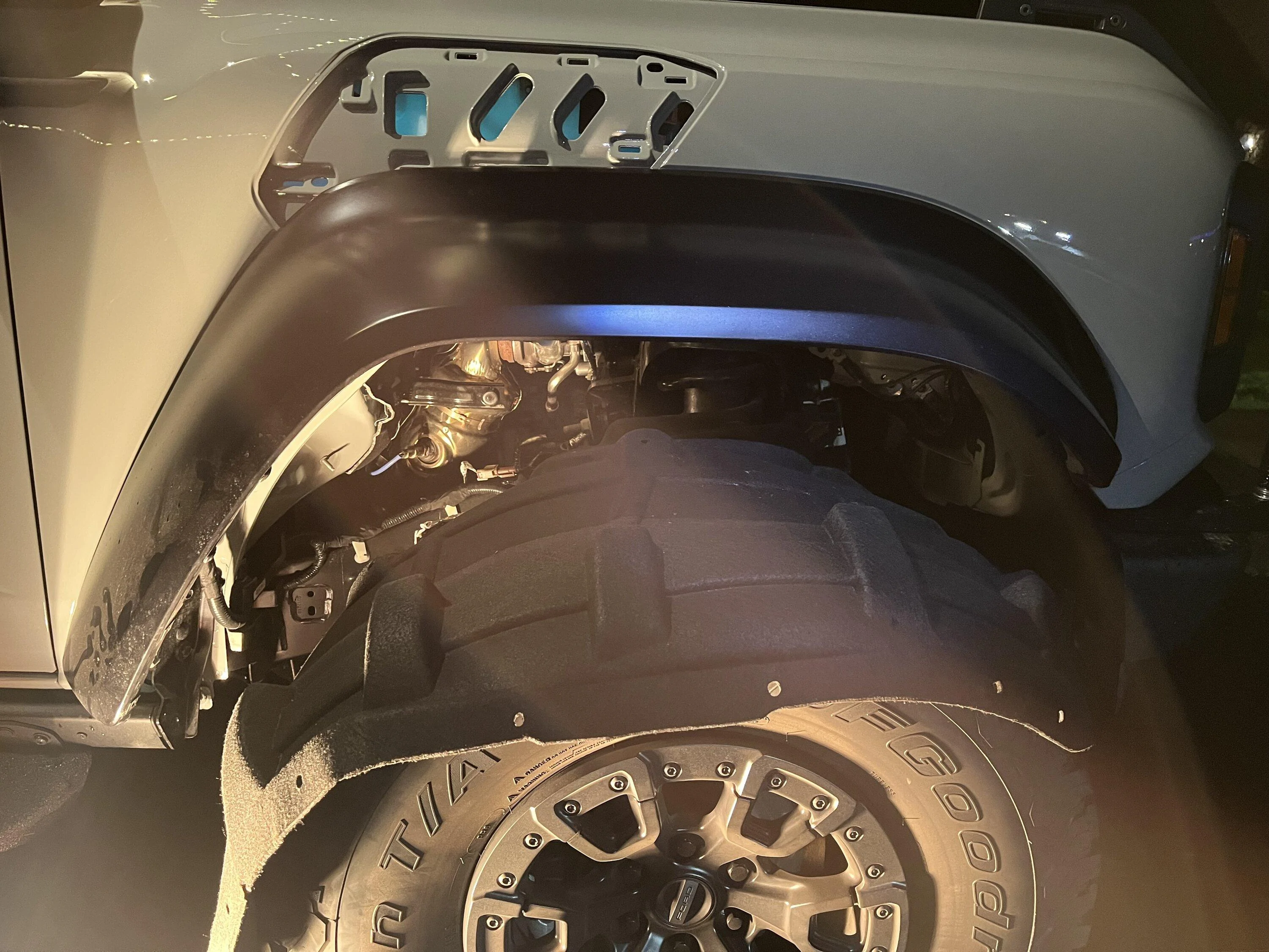

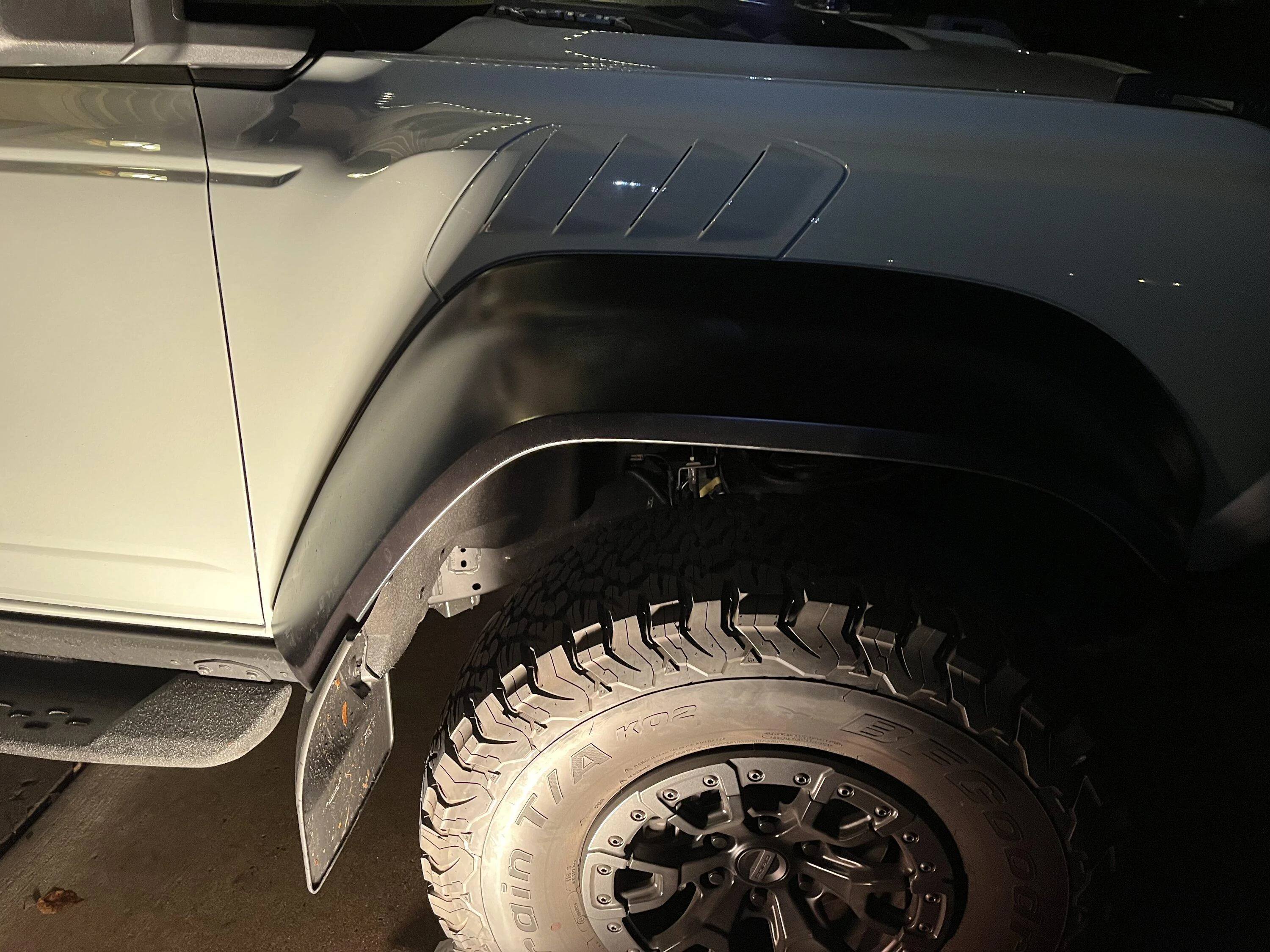

Well.

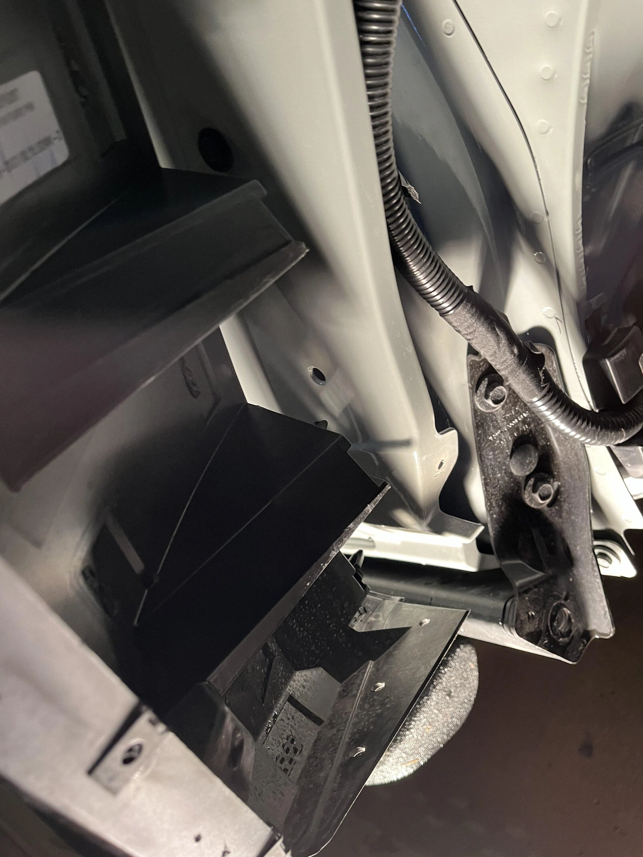

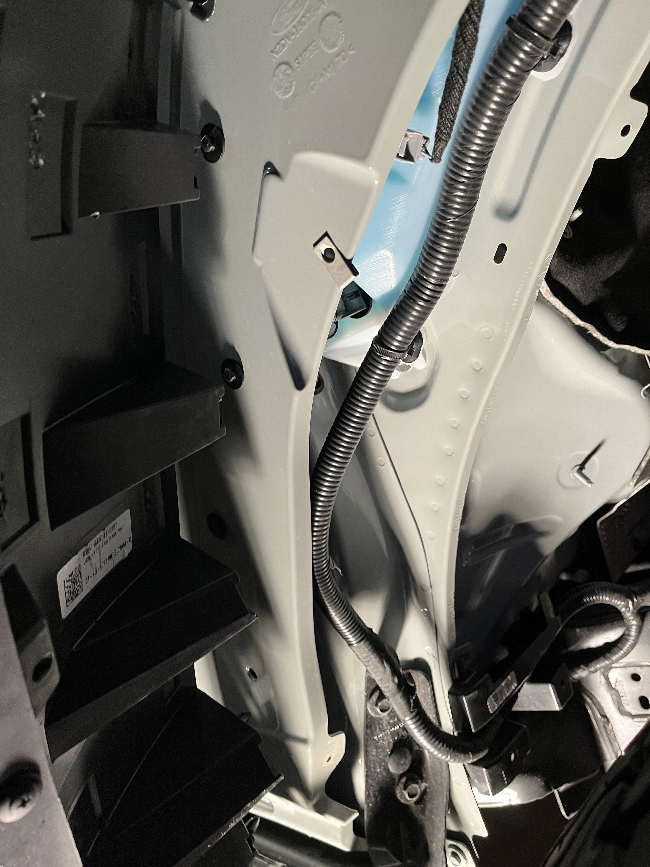

I took the fender liner out and pulled off the flare enough to install the vent and put it back together.
The clips that hold the flares on seem to need to be rotated after reinstall as the head that slides into the flares are not symmetrical so I figured if I rotate the back of the clip by 90 degrees they would hold the flares on. It seems to work as everything is tight. But I could be full of shit.
Broke only those stupid fender liner clips with the plastic screw head. What a dumb design. I had some spare Ford/Nissan Dorman 1/4” clips which worked in one or two spots and I had some spares from my mudflap install.
And I never plan to touch these silly vent/gills again. They will remain Cactus Gray. 😂

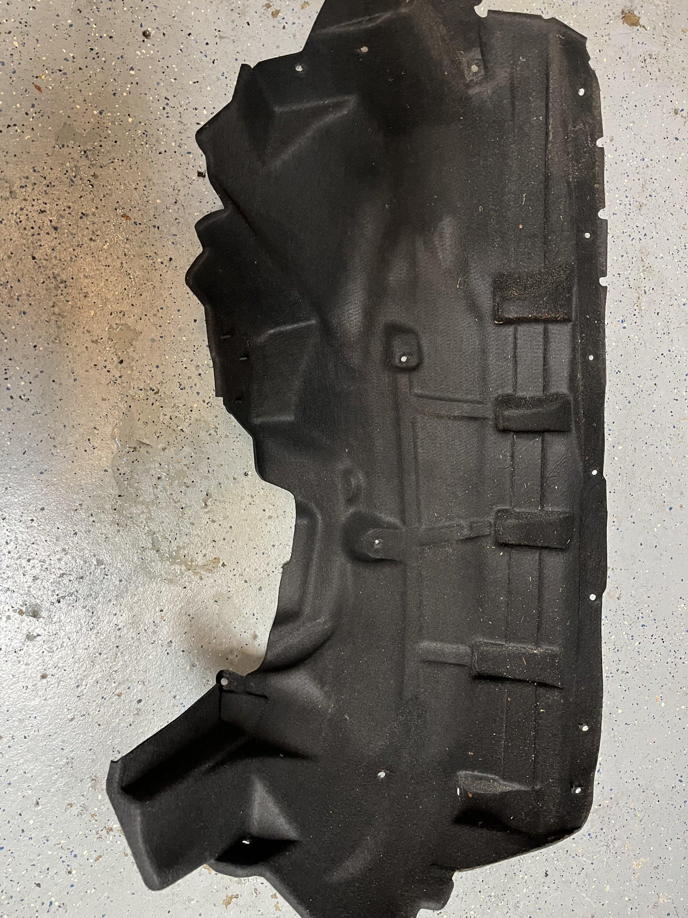

Any tips/tricks/caveats to taking out the fender liners? I'm gonna need all the advice I can get as I attempt to install my rock lights.

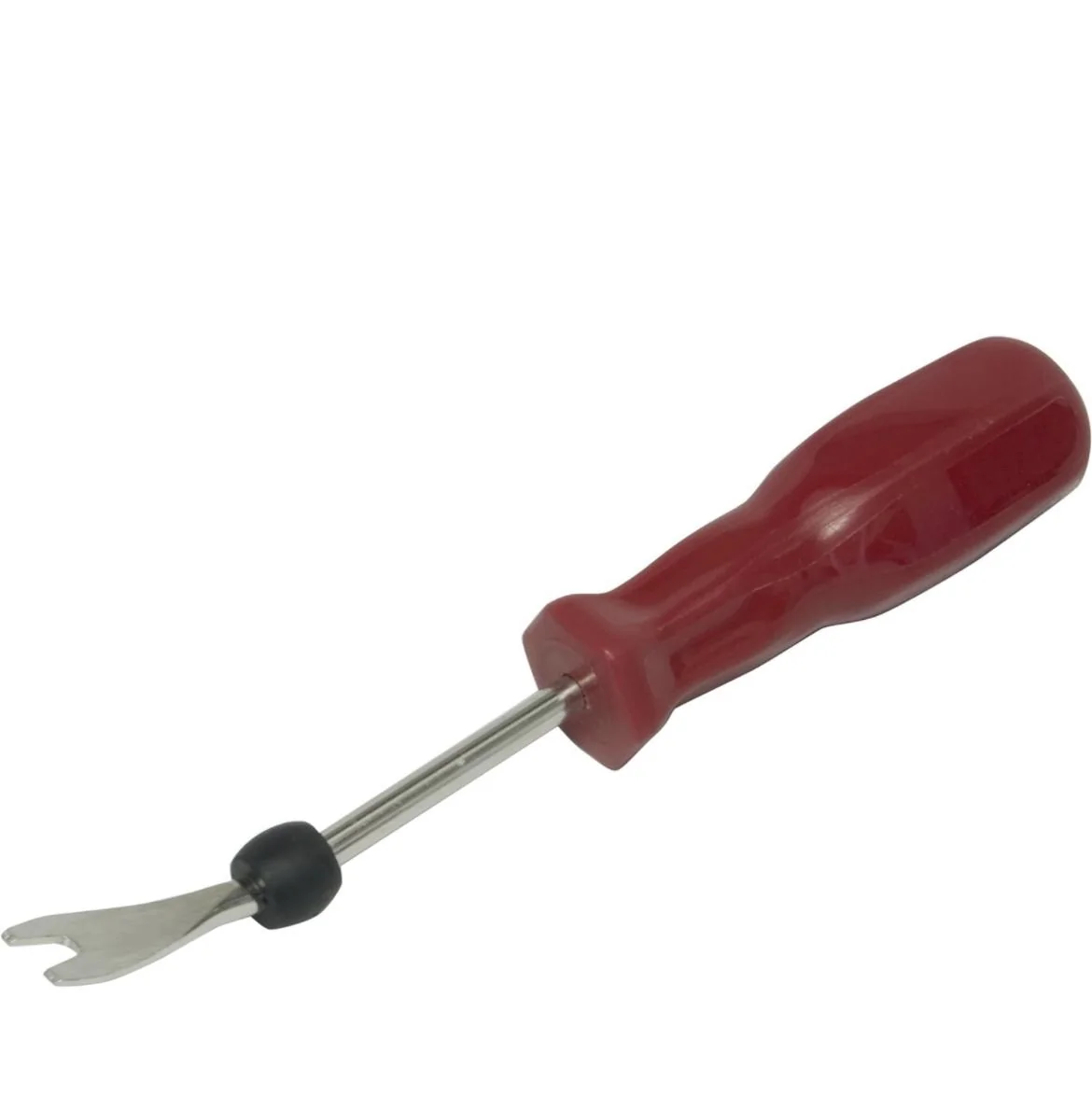

Removing the inner liner was relatively easy. Buy spare plastic clips ahead of time (I did not but I had some spares from my Weathertech mudflap kit) as you will break some.
7 mm socket and a rubber ball style clip removal tool bought at O’Reillys / that rubber ball permits a lot of leverage to be applied.
