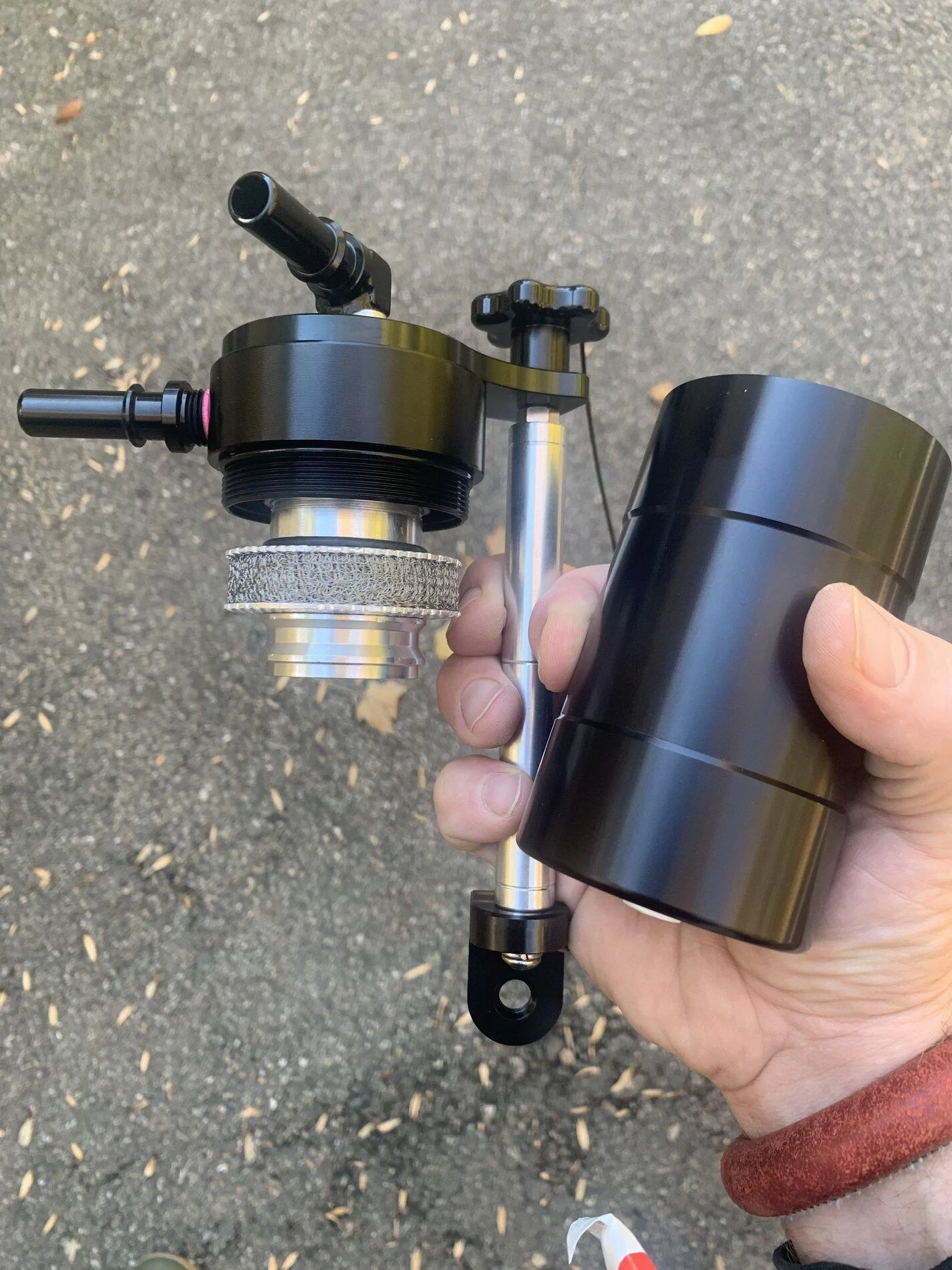

Mine showed up yesterday. Really nice design/materials used. Going to install it after 2nd oil change/Blackstone report at 5k (next week).

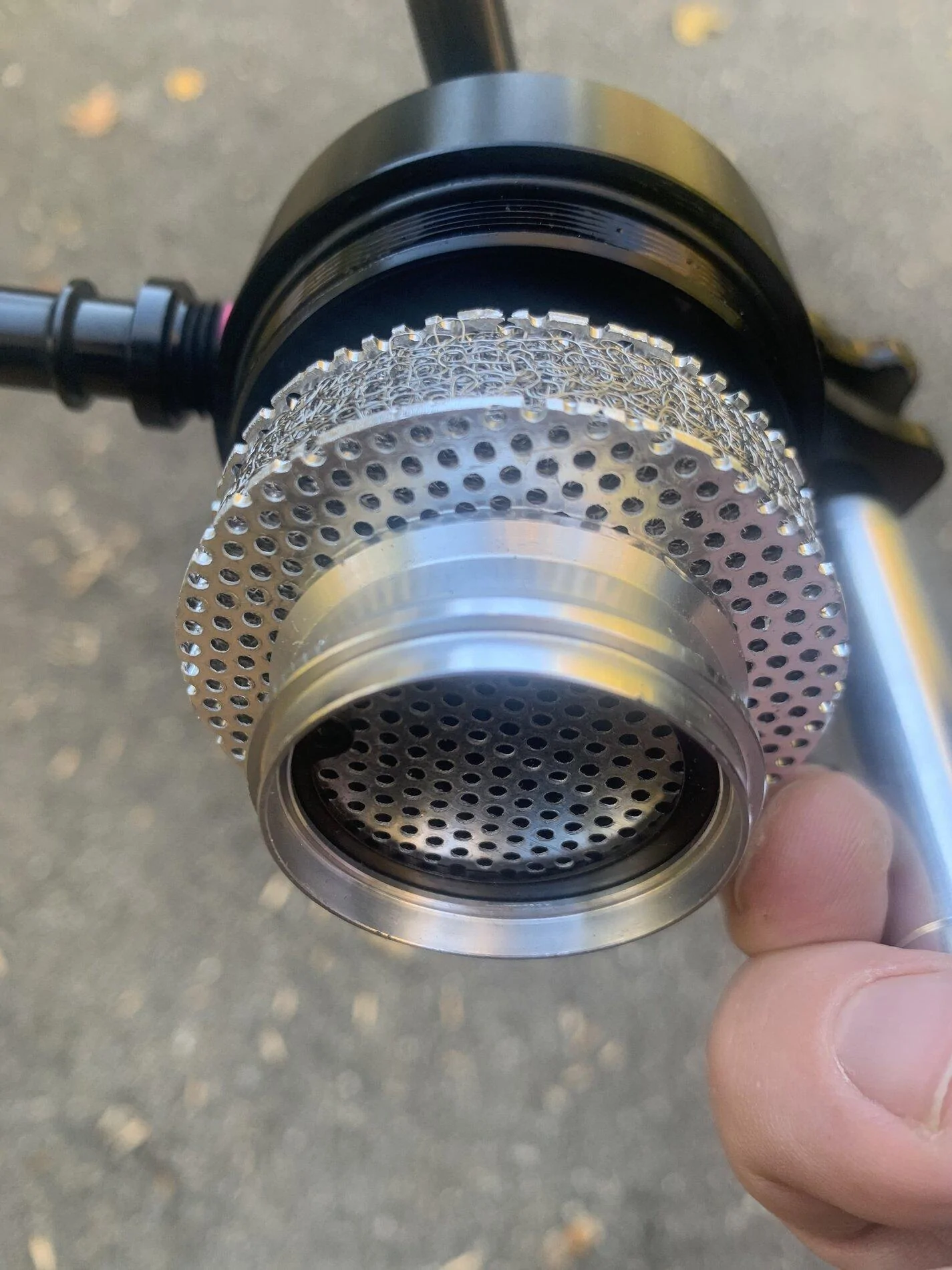

Information on the methodology and materials used for filtering, vapor savaging and isolated containment should be mandatory for all catch cans advertised.
There are a number of filtering mediums in common usage and while they all have a reason to exist, some are better than others in application.
In addition: The magnetic drain plug or remote drain kit should also have the bare minimum of info. What type of magnet, are you using a petcock valve? What materials is the valve made of?
This product being on the extreme high end of pricing for catch cans, they should have actual information on their unit. rather than "we're pretty cool and make a ton of catch cans, trust us!"

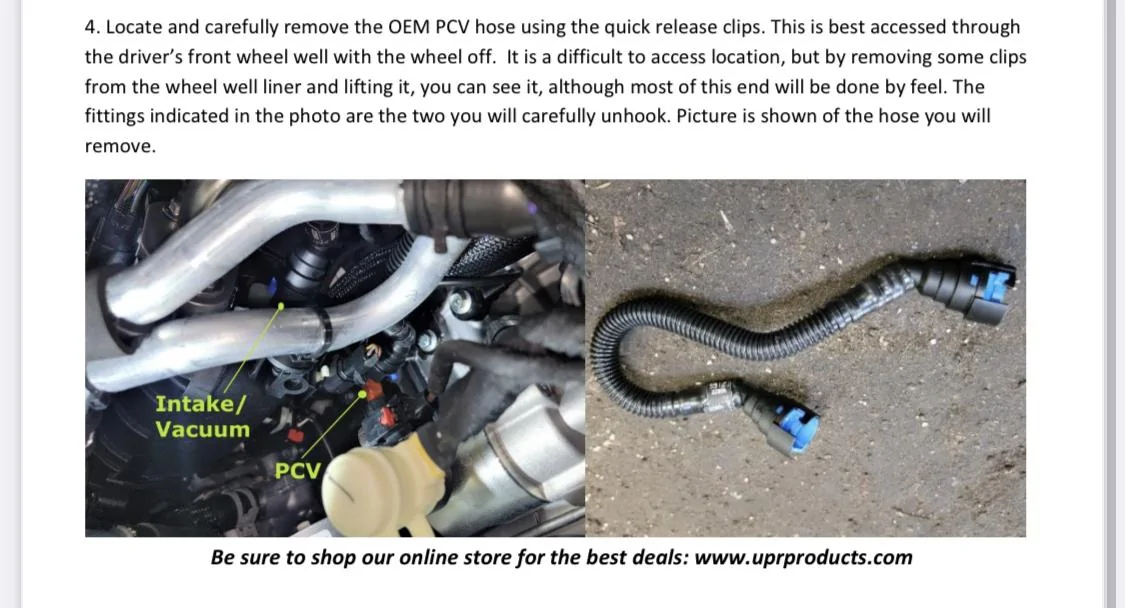

The can itself has been mounted for a month…but, I tried to connect the hoses on a 20°F day and gave up after an hour. UPR has since released videos of how the locking harnesses work - so, I plan to give it another go as soon as we have a warmer Monday (only day off).
The PCV/Oil Separator hose that gets removed is on the side of the engine and you have to access from the wheel well. Even then, it’s hardly visible and mostly by feel. The locks are thin plastic and I didn’t want to risk cracking them.

I’ll tell you what. That sh*t is a pain in the ass to access the fittings on the motor side. I’m never removing those damn hoses. Sure as shit hope my dealer is cool with catch cans šŸ˜†
Before installing I realized the one hose was slightly longer - maybe 2-3ā€. Assumed it was for the intake side. Turns out it was probably for the PCV side because that fitting has to reach a bit further on both ends. There was no way I was getting them off once they clicked. Zero room to get any leverage to press the buttons to release from the vacuum fitting. I made it look neat and zip tied it to avoid hitting the control arm or steering shaft.

I’m getting mentally prepared to install mine. I am putting it in with a drain line and valve (similar to the one I put on my F150) so you only need to put your tray or bucket under the valve and drain it without removing anything. As you said, once it’s installed it’s staying there!
I’d recommend practicing the connections on the can side so you get familiar with how they release before you try to remove the OEM connections behind the motor.
Once I saw what it takes to access the motor connections I realized how nice it was to do on the transverse-mounted 2.0 in my Focus ST. At the time I thought that job was a PITA!
FWIW, I’ve never had Ford say anything about the UPR can I installed on my F150. You should be good.
Question: could you do the install without taking the wheel off? I have skinny arms but I don’t think I could contort them enough to reach those connectors.
