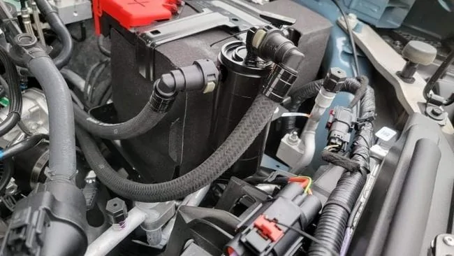

Even more info from @thecatchcanman below. I suggested they mention this in their instructions. I should have realized. But, the PCV is set a bit deeper - so, I assumed that needed the extra length. Measure twice and click once. I gave it a good try removing once I realized the error - but, it’s really hard to get any sort of leverage to press the buttons on the sides of their fittings once they’re seated. I even tried their suggested push in, press buttons and then pull.
The hoses are different lengths. Typically, the 'dirty side hose would be longer and go to the top of the catch can, but it really doesn't matter.
Now my return/clean line has to sit up along that other hose instead of along the side of the battery and down.

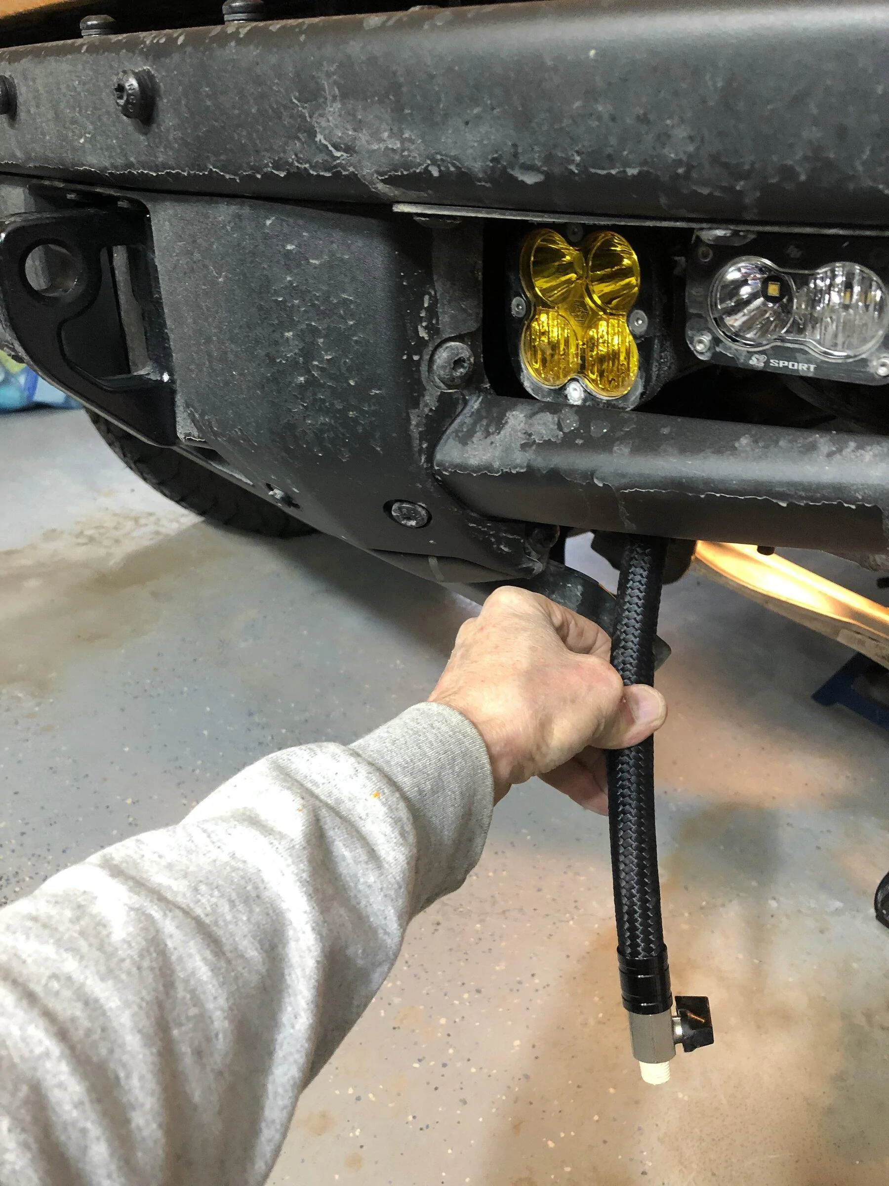

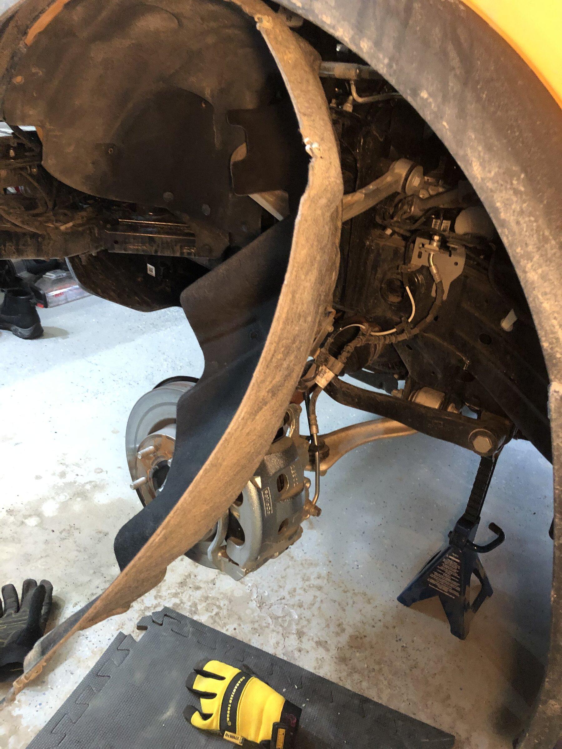

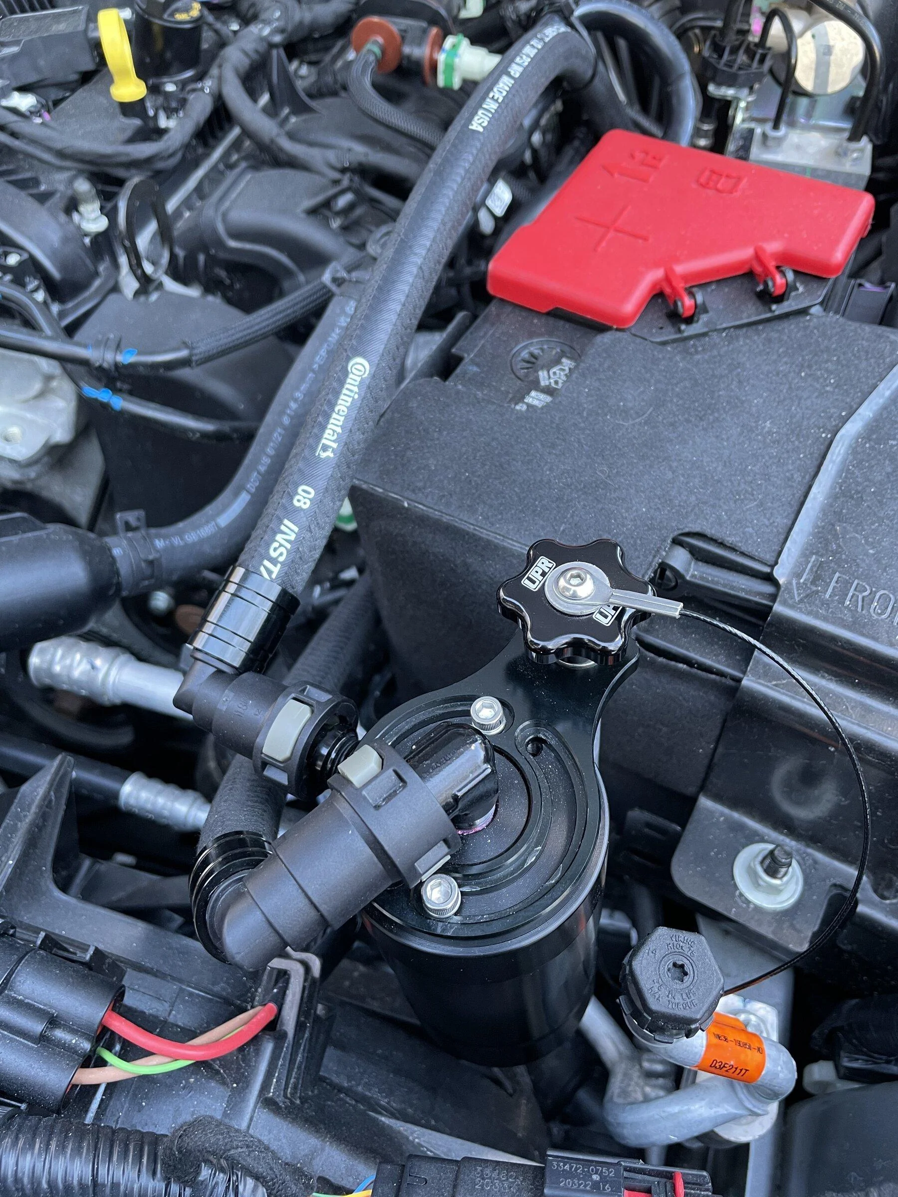

Thanks for all the tips given here, they helped a lot! I just finished the install, and thought I’d share my .02 to help the next installer(s).
1. After removing the driver’s side front wheel, take the time to remove most of the wheel well fasteners and remove it at least to the lower front connection point. Being able to see into the work area and have as much “blockage” out of the way is worth the extra time needed to remove the wheel well.
2. Study the UPR video posted above on how to work the OEM clips. The existing hose are the “blue ones” which need to be opened as shown in the video. You have to do the removal (and install of the new hose connectors) completely by feel.
3. I found it was easier to work with loose hoses (not connected to the catch can) to ease alignment for the engine and crankcase connections. Connect them per the instructions (follow UPR’s routing recommendations for the hoses through the heater lines) and then feed them upwards to the catch can.

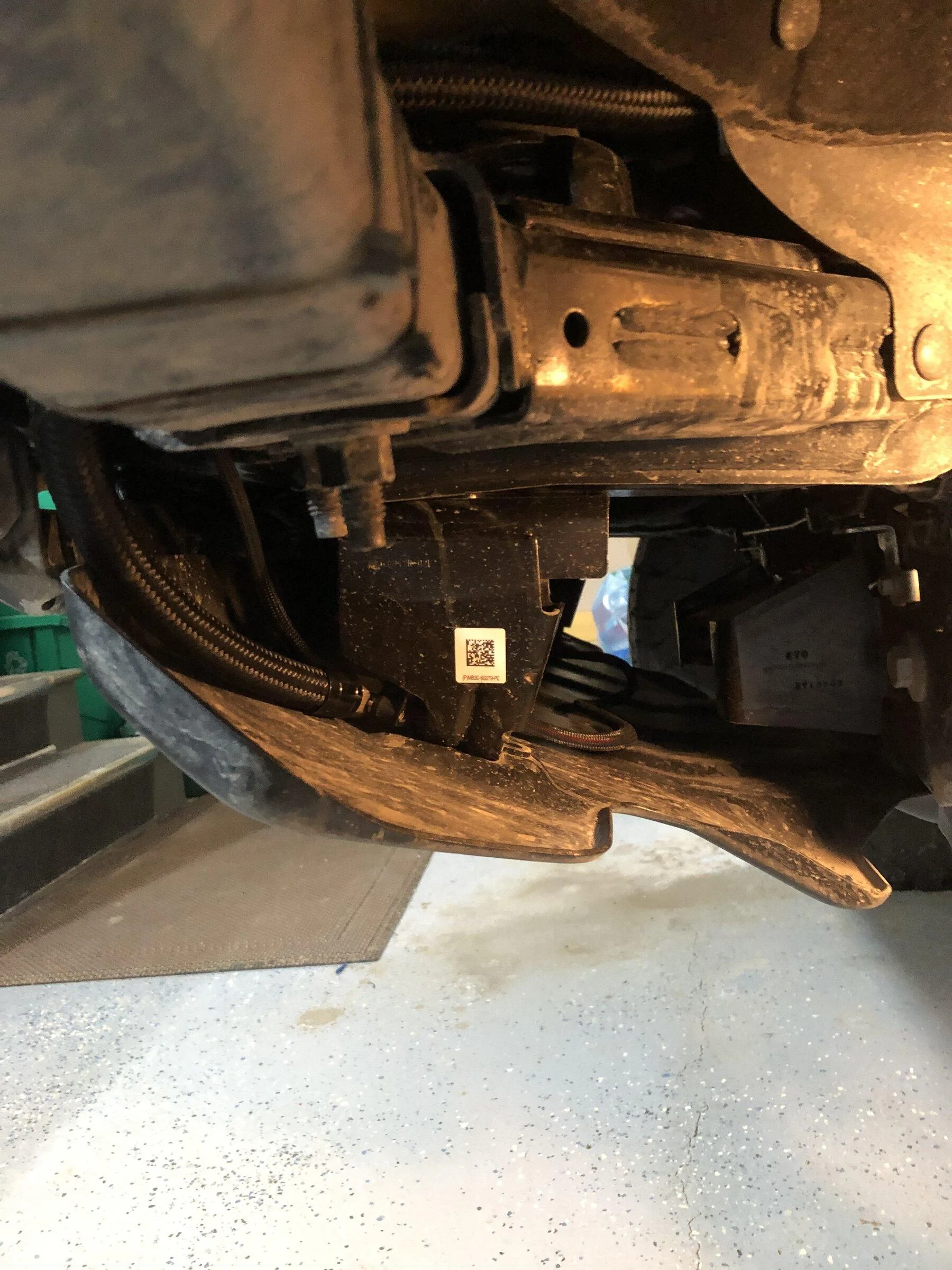

4. I installed a drain line on my catch can. I routed in down behind the wheel well moulding and out between the front crash bar and the bumper mount. It tucks up inside the bash plate and is easily retrievable when I want to drain it. Do this routing while the wheel is off.
5. Keep your Zen - your hands are not going to like the contortions they’re needed to be in, and the hose connectors need to be aligned right and the right pressure needs to be applied for them to click in. I will say that when you get that 2nd “click” for the last hose connection, it’s almost orgasmic.
Photos attached.

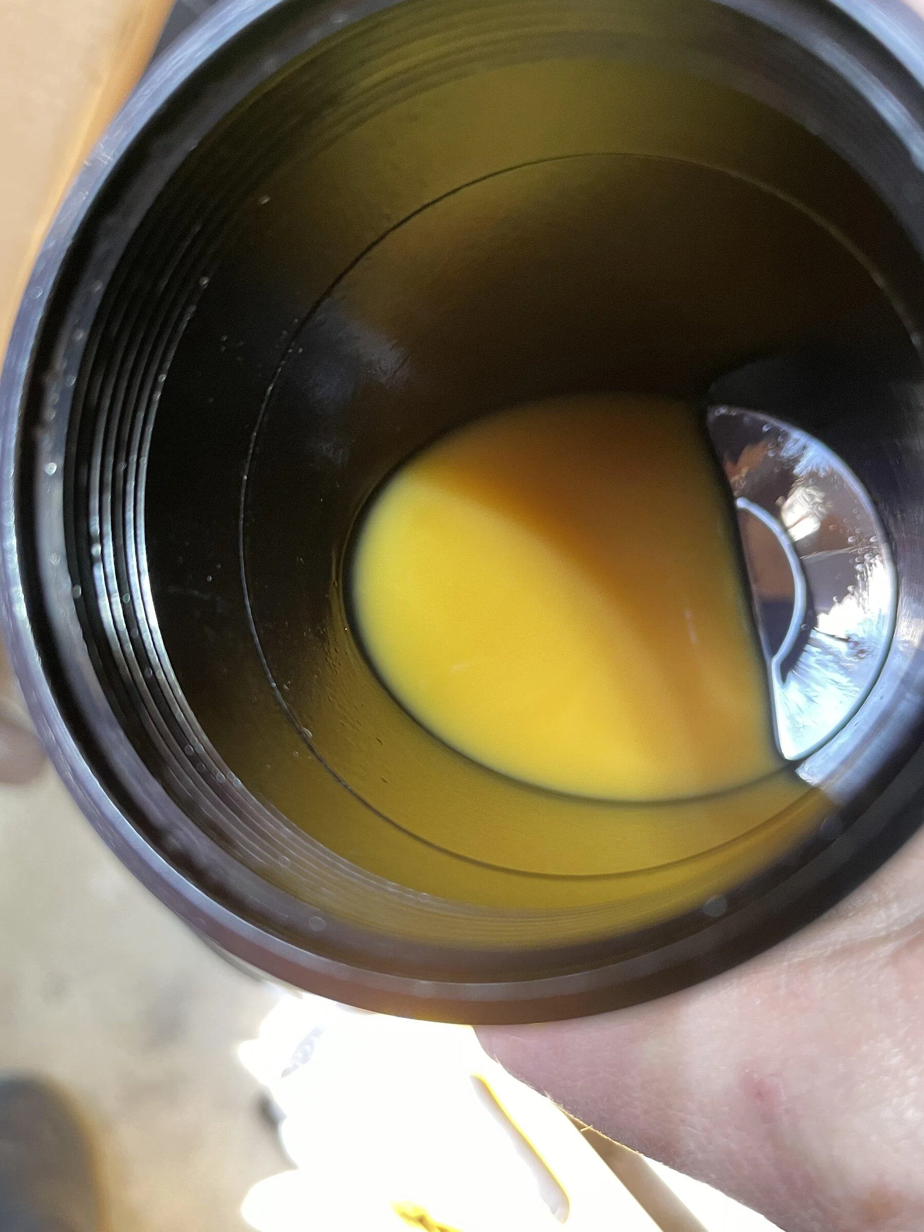

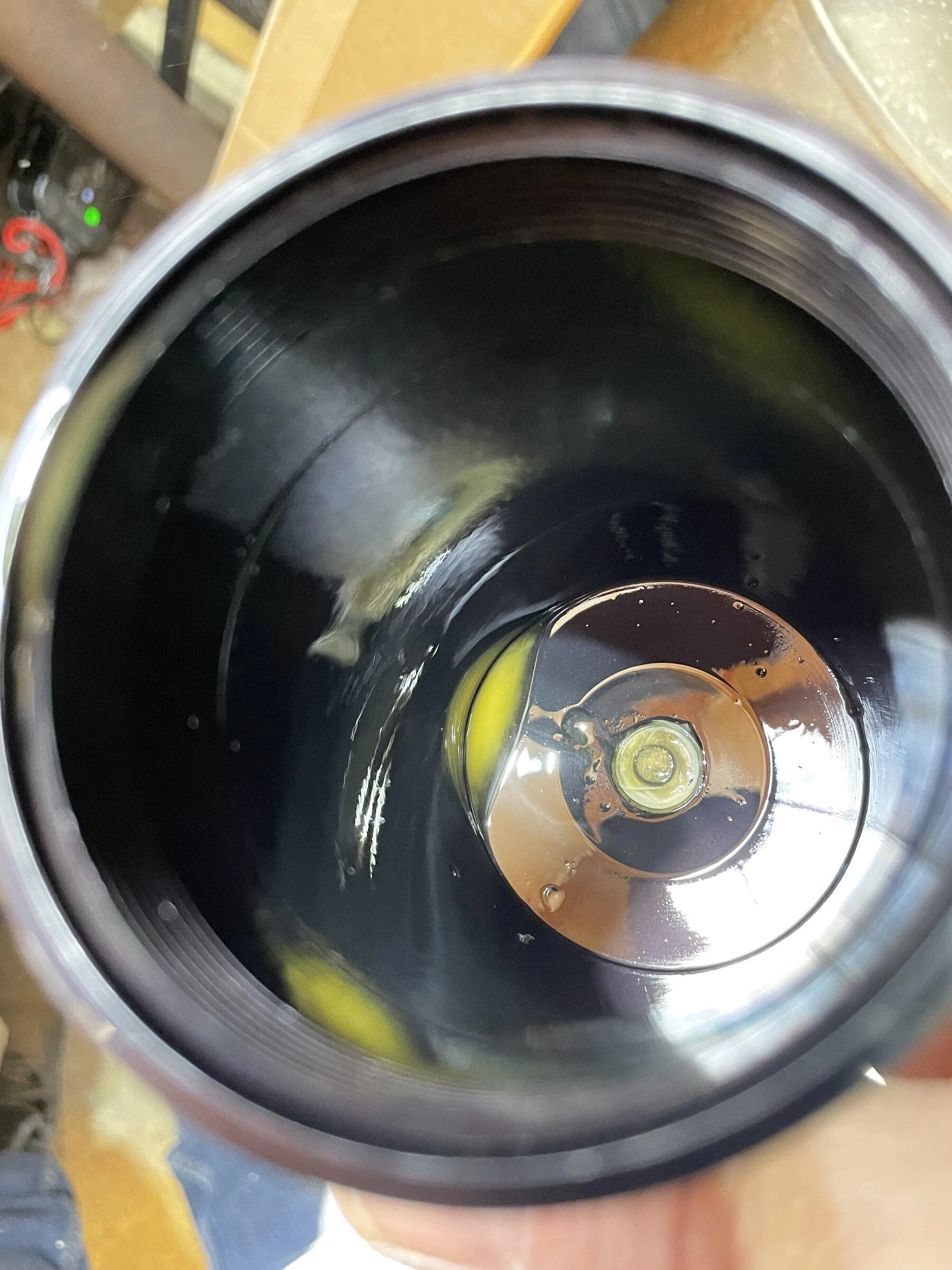

After about 700 miles (I had to replace a gasket that was missing).
Ford Bronco UPR Plug N Play Oil Catch Cans! 2C9E6951-4BA9-4F3B-911B-6DDEA6B6B3B7
After I poured out the condensation:
Ford Bronco UPR Plug N Play Oil Catch Cans! 8B270010-01BC-4E67-A18C-A027A5973384
Definitely a bit of oil in there and some debris.

Looks like the catch can is definitely doing it's job. Thanks for sharing!
