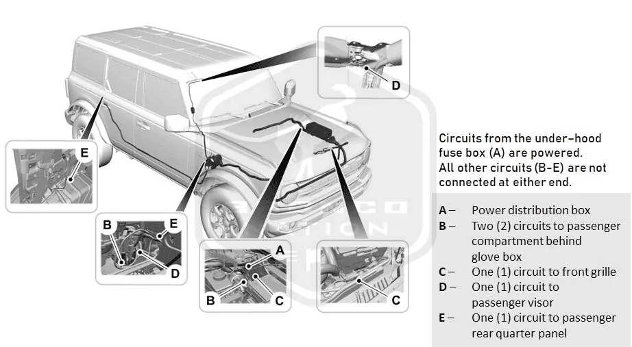

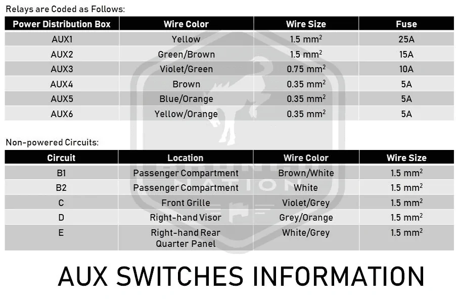

I first connected to the violet/green wire by master cylinder which is switch #3. No power when turned on with engine on. Then I connected to brown wire which is switch #4 with no luck either. I also have raptor grill lights piggy backed on fuse for switch #4 and they turn on and off. So I’m figuring there is an issue from load side of fuses to end of wires???

My pass through wires are not the same color as my powered wires. I have the same color coding as diagram above.
The first and only thing I wire it up I decided to put on number three. It's violet with N.... Looking under the hood, there are 2 violets and the gray/green were close enough in color it was hard to tell.
But maybe it is something else because it doesn't sound like it's the fuses because those are individual.
