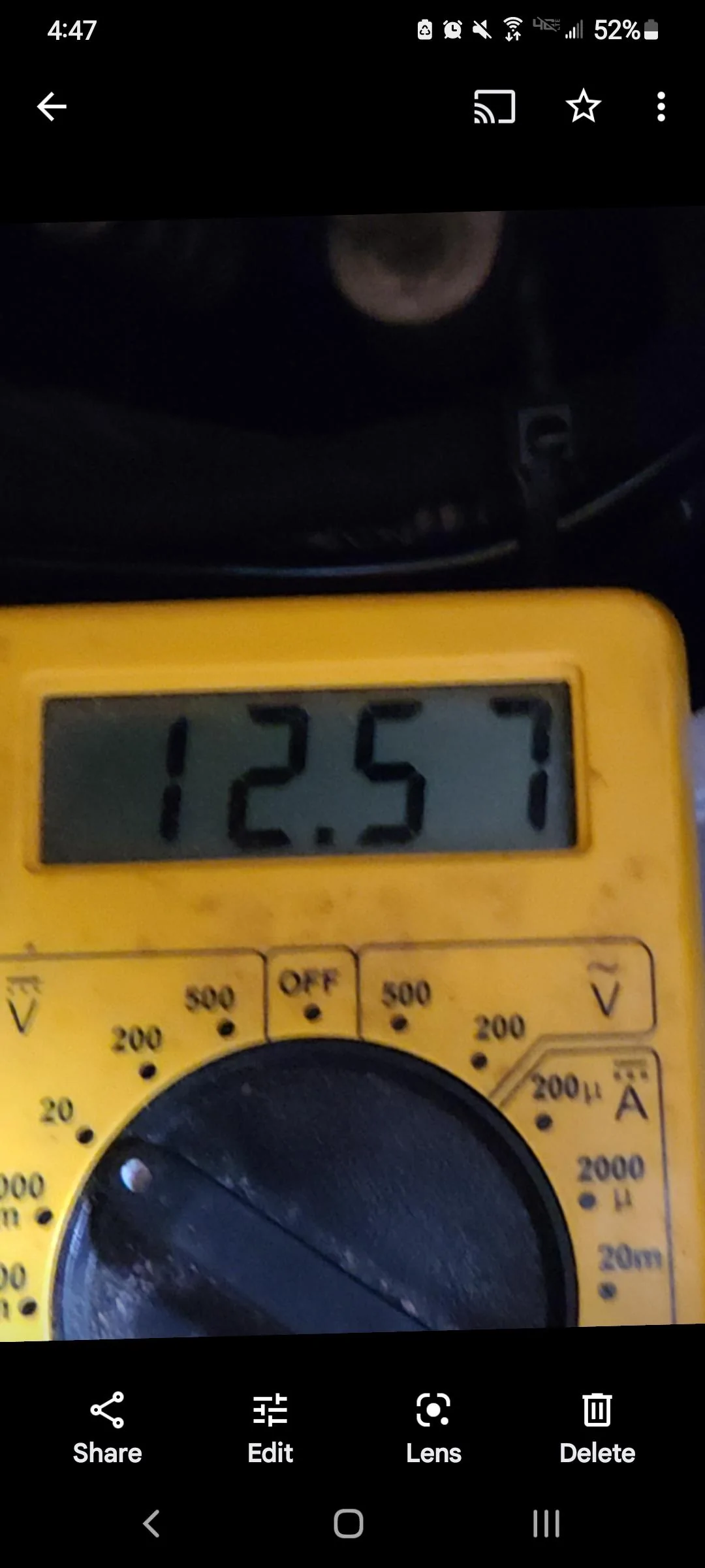

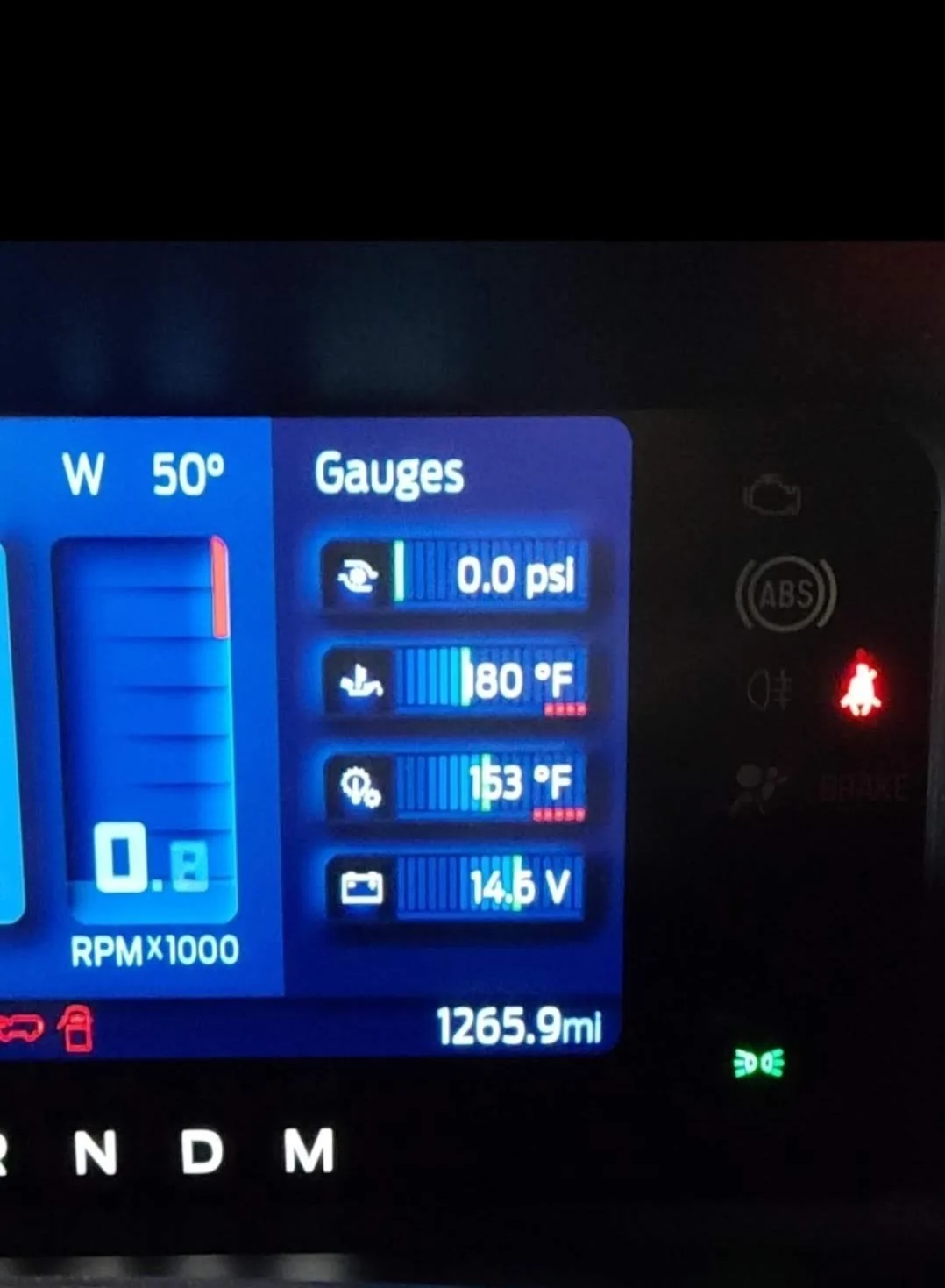

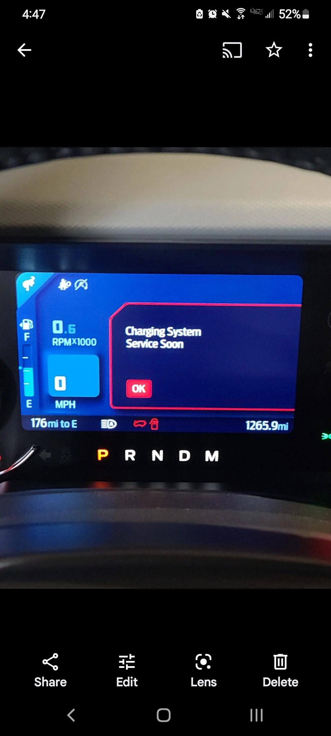

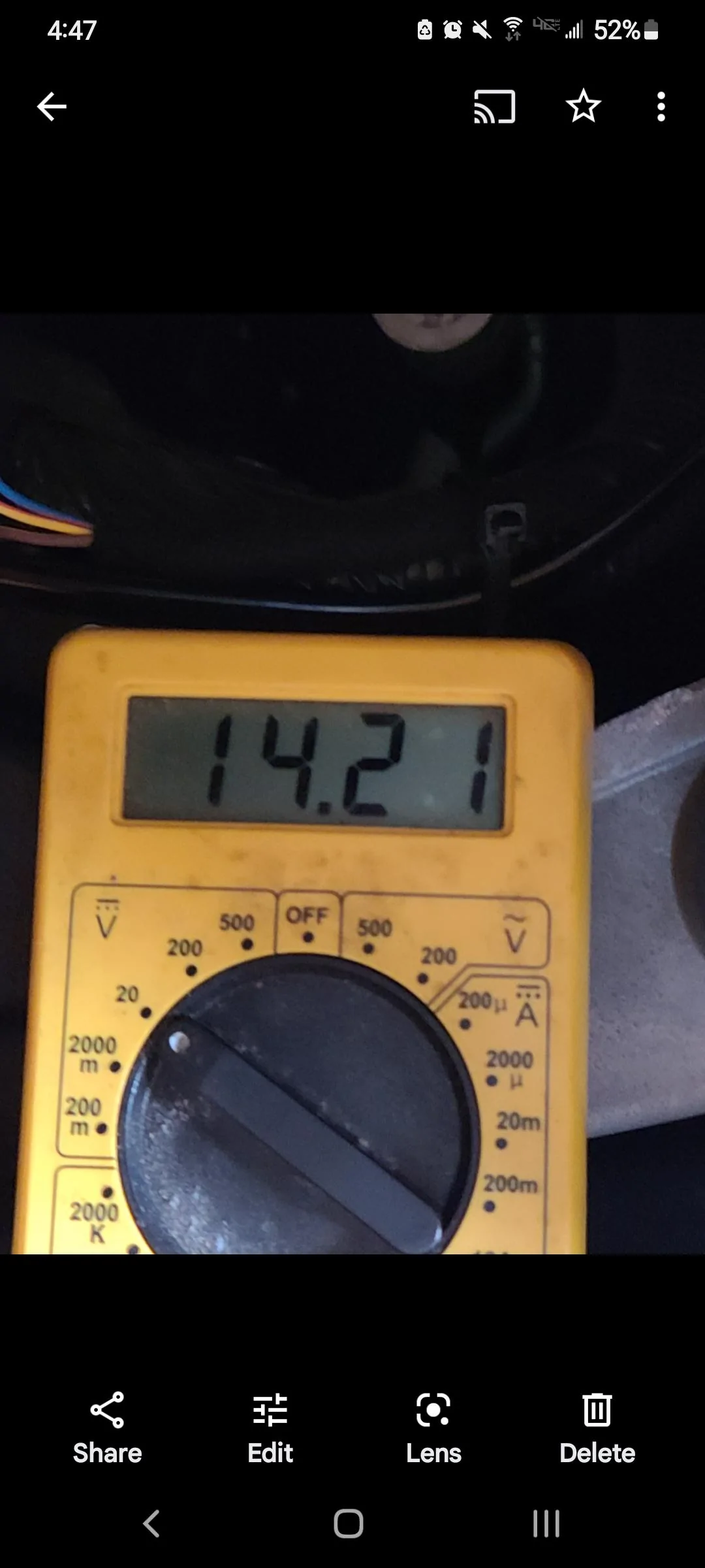

Have you had any problems with the 2.7 yet? Mine just broke 400 miles and I'm getting the "Charging System Service Soon" message now for the last couple days. Battery holds a 12.6-13V charge while off and a steady 14.1V charge while at idle. Moves around between about 13.7-14.4V while in different driving conditions. Also, no Ford Pass notifications, everything is green on the app as well.
I just started getting this same thing over the past few days. My code reader says no codes. Ford pass has no alerts. Here are some photos. 12.57 is when the engine is off. 14.21 is with it on. And it says 14.6 on the dash guages. I have it on my trickle charger currently to see if that changes anything.
