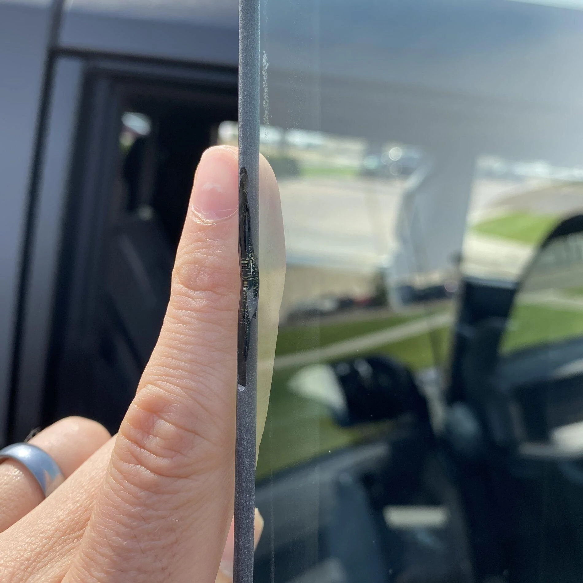

Noticed AUG3 and delivered on July 25 so 8 days. Not something i would need to check, so i thought. It is what it is. I just want others to look before signing papers for delivery. Im not mad being the guinea pig. Just more of a heads up to others.
if you noticed it 8 days after getting it, how do you know it came like that? Could have been someone trying to break in anywhere from CA to your home? Not sure any dealer would just happily pay to repair that, after the car has been gone for a week. Also pretty incompetent and odd break in attempt, most just use emergency window poppers you can get at any hardware store. Quick and quiet. Still a bummer on a new rig, but you seem to have the right attitude to deal with it. At least you found it before somebody cuts their fingers on it.
Good to know there's an other thing to look for. I'll give it a good once over at the dealer and once I bring it home I'm going to try out everything I can find, see if it works. Already picked the dirt lot to try out the off road modes, might also take it to an offroad park that's more for bikes and ATVs but has some wider trail stuff to test things.
Someone else asked in this thread, do we have a checklist here somewhere for which issues to pay attention to when taking delivery? That would really be handy.
Hope you get it fixed quickly!

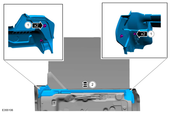

  1. Remove the rear door window glass inner belt moulding.
    1. Release the retaining clips.

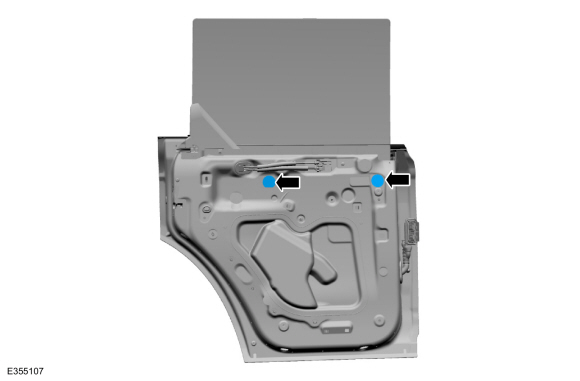

  1. Remove the rear door window glass adhesive covers.
Ford Bronco ***UPDATE***Chipped Door Glass Hel
Ford Bronco ***UPDATE***Chipped Door Glass video

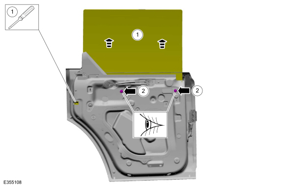

  1. NOTICE: Make sure to release the rear door latch to the open position before closing the rear door. Damage to the rear door latch may occur.
    Raise and align the rear door window glass.
    1. Position the rear door latch into the closed position and the rear door window glass will raise to the full up position
      Use the General Equipment: Flat Headed Screw Driver
    1. Confirm the rear door window glass screws are aligned with the access openings.

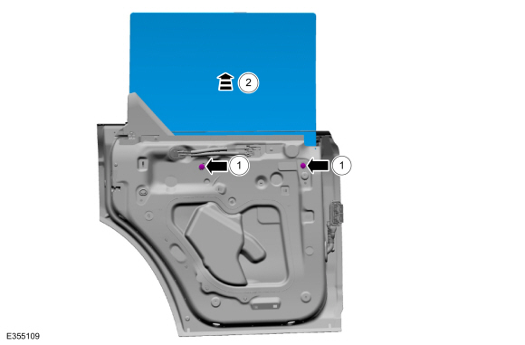

  1. Remove the rear door window glass.
    1. Remove the bolts.
      Torque: 93 lb.in (10.5 Nm)
