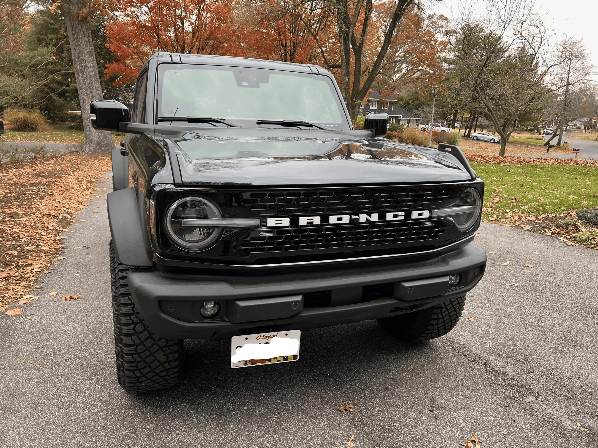

There’s multiple ways one could attach a license plate to both bumpers (especially once you include zip ties =] ). However the mount I got from Fishbone Offroad fits directly to a shackle point like on the mod bumper versus what the d-shackles are connected to on the capable bumper
I bought the Fishbone shackle license plate holder. I did plenty of cursing trying to get it to work on the bronco shackle. Unless you are handy and have a few tools I wouldn't recommend this assembly. They need to make one for the Bronco, this is a Jeep accessory.

I bought the same one and waiting for it to come in tomorrow, what were the issues you had installing it?

I like the bumper but don’t like how the OP didn’t stow the shackles before taking the pictures

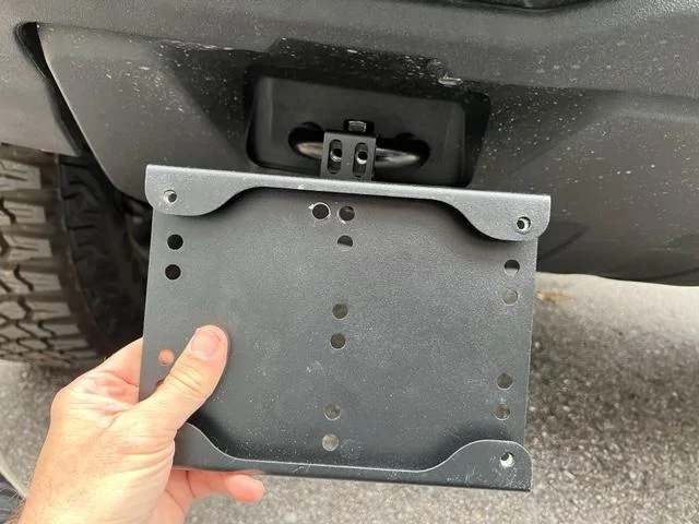

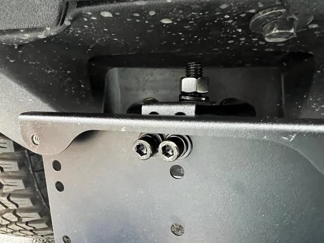

Had to drill a hole because it is built for vertical shackle, not horizontal. The spacer isn't the right size. I tried a couple of things and then eventually just left it off. Put the bolt in from the bottom, nut on the top. Didn't have deep enough socket the other way and couldn't get socket on the top. I wanted to mount it on the end to center it closer, but it wouldn't fit in the bumper cut out area that way. I'm concerned it is going to eventually come loose. We'll see.
