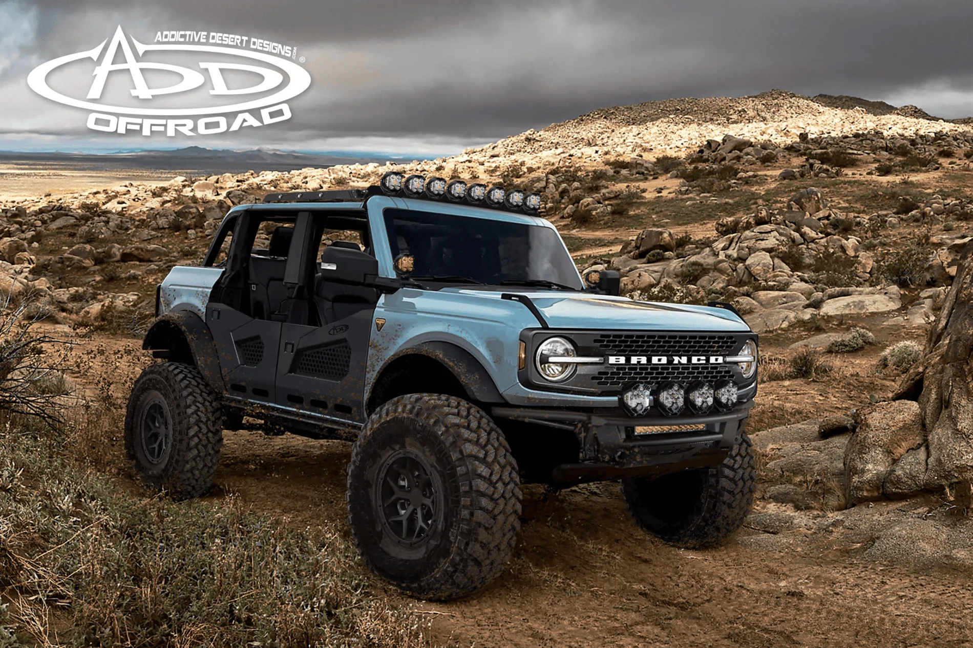

ADD's Stealth R and Pro bumpers (which are the ones in those rendered images on their site) aren't bad looking, at least on the Ranger and Raptor, but beauty is in the eye of the beholder.
If they hold true to the look in those rendered images, I'm leaning towards the Pro version that's on the 4-door. I'll also go the extra distance to have it sprayed with Line-X.
