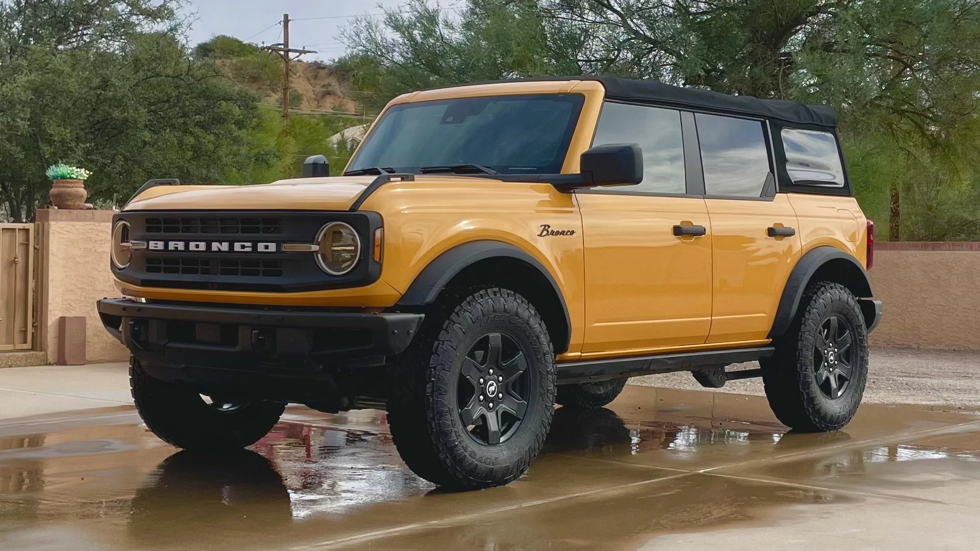

Toyo ATIII’s installed, 285/75-17. Love how the BD looks now! More here
That looks perfect. Im surprised you dont have any rubbing. I thought that size rubbed the swaybar. Maybe thats a 295 tire. I may have to find me a set of alloy black diamond wheels now. I was gonna do a 275/70/17 but these look awesome too.

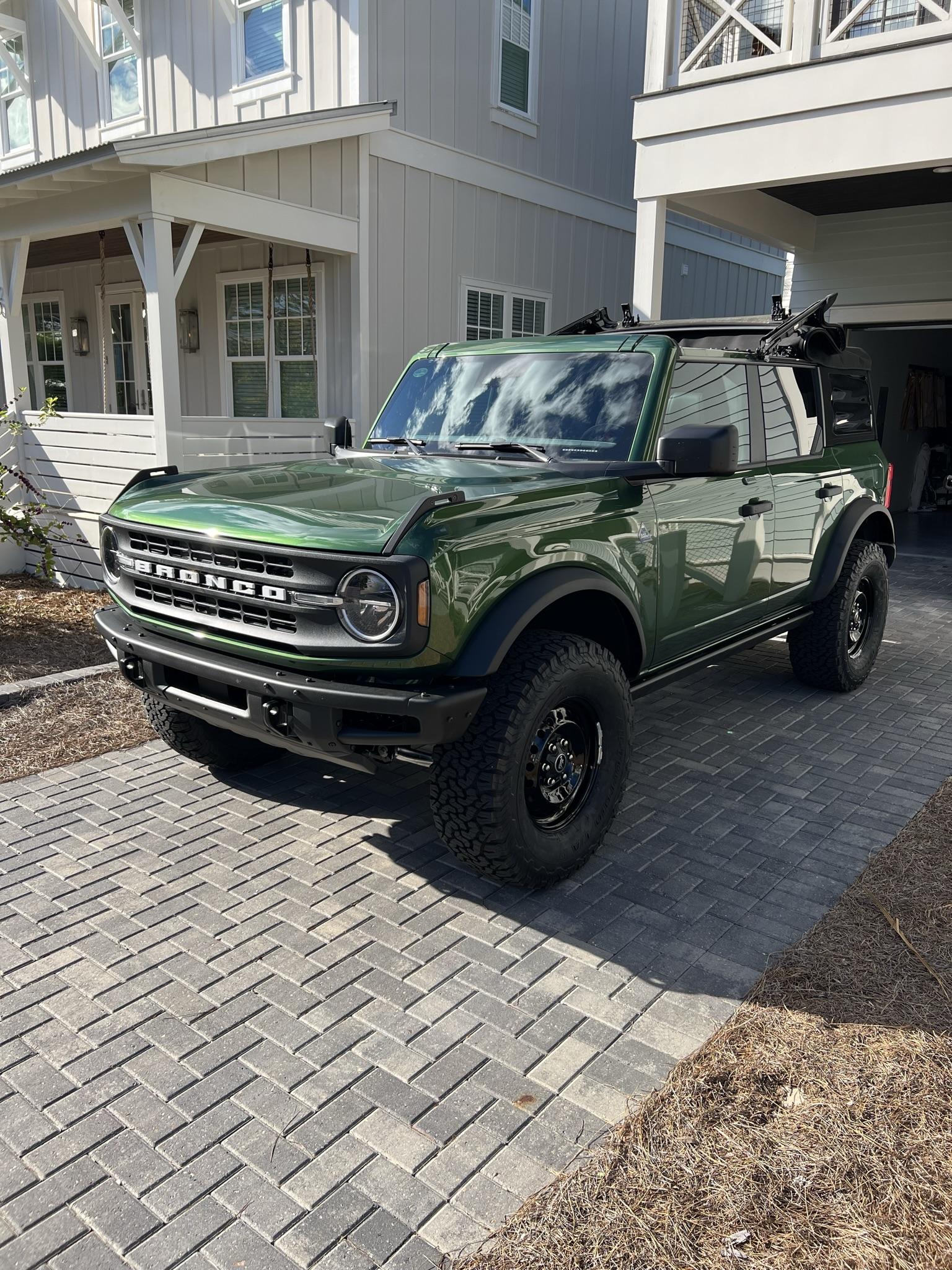

2” lift from factory(I think it’s RC), 315,70,17 KO2’s and Bora 3/8” spacer (to relieve rubbing at full lock). Love that I was able to keep the steelies. Parking next to the Sasquatch it may even sit a bit higher.

Crash bar delete too? I love my steelies and refuse to get rid of them, but wasn’t sure 315s would fit

Yes. Have to take off the crash bars. 315’s do rub on the upper control arm at full lock. The 3/8” spacer from Bora is perfect for the steelies and pushes the tire away from the UCA just enough that it eliminates all rub.

^^ Looks great. Love that you kept the steelies. Thats probably what i will do too.

Any more pics from the side and back, this is exactly what I want to do. Looks great
