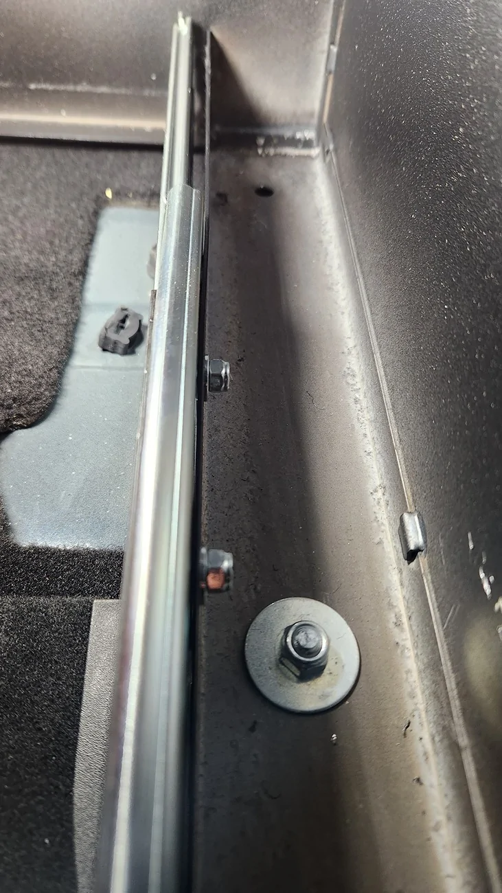

I need to clear the rear seat bolts that protrude up from the floor, so I added two washes to the mounting bolts supplied with the drawer. One when I screwed the mounting bolt to the floor and then one on top.

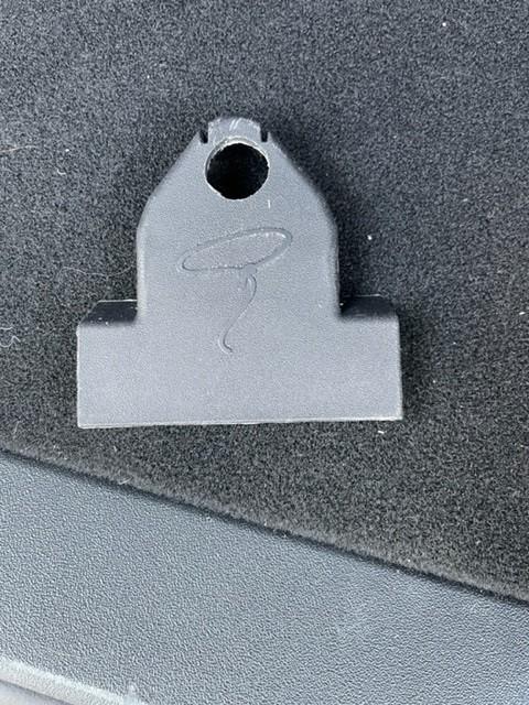

Lastly make sure to drill the hole in the two rear cover plates this will hide the exposed floor.
