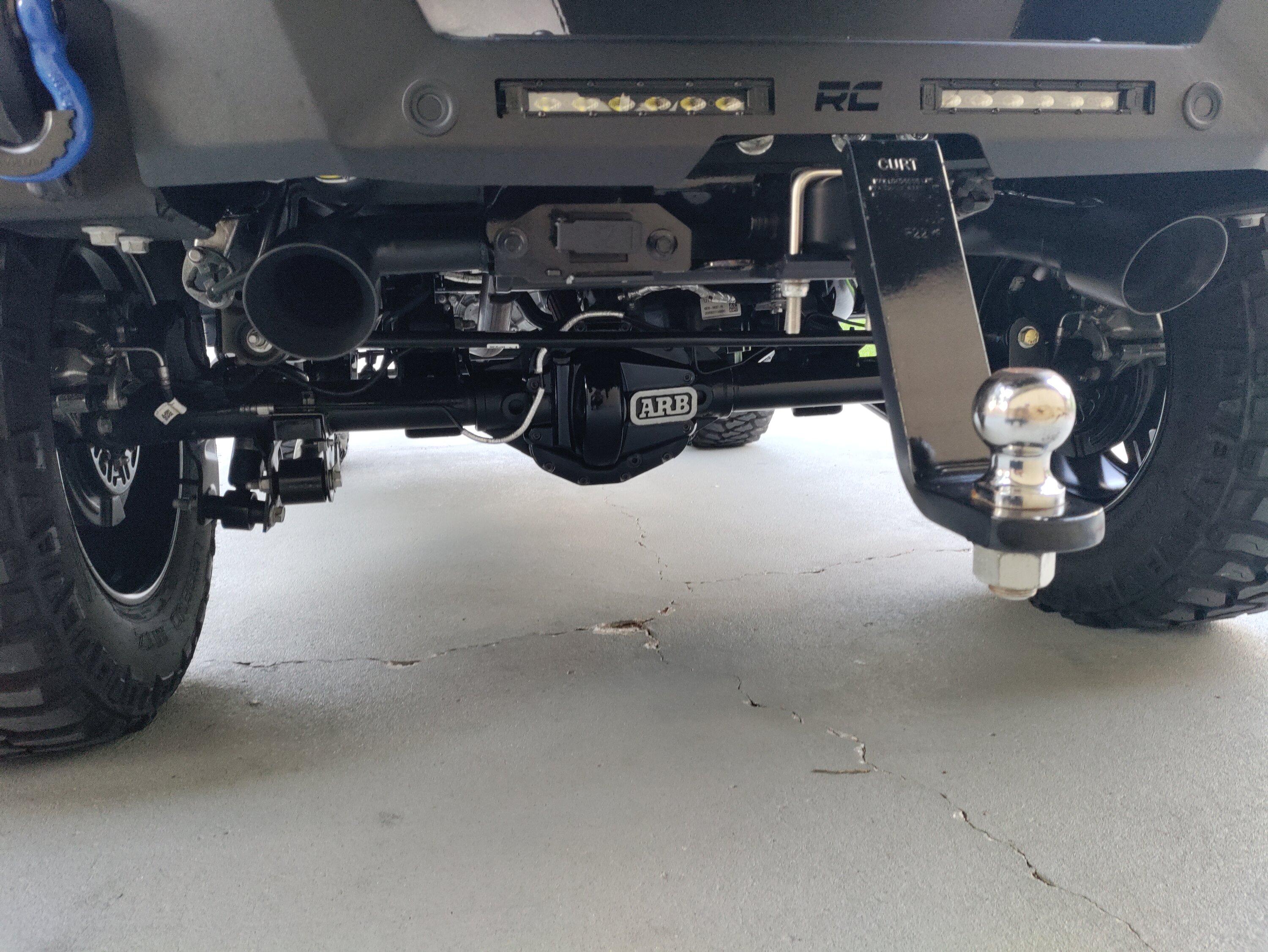

The Curt plug n play harness installs pretty quickly. I purchased mine from etrailer.com
If you have LED lights then this is the harness you will need.
https://www.etrailer.com/p-C42WR.html?hhyear=2022&hhmake=Ford&hhmodel=Bronco
They also sell one without LED lights too.
I also bought this on Amazon so that I would have clean secure inlet on my hitch without having to drill into the bumper to mount or elsewhere.
https://www.amazon.com/gp/product/B07Z6RZCVF/ref=ppx_yo_dt_b_asin_title_o09_s00?ie=UTF8&psc=1
The hitch I bought is also from Amazon and I have had no problem at all with it. I tow my boat 5 days a week with it.
https://www.amazon.com/gp/product/B09Q5V2LNC/ref=ppx_yo_dt_b_asin_title_o09_s00?ie=UTF8&psc=1
