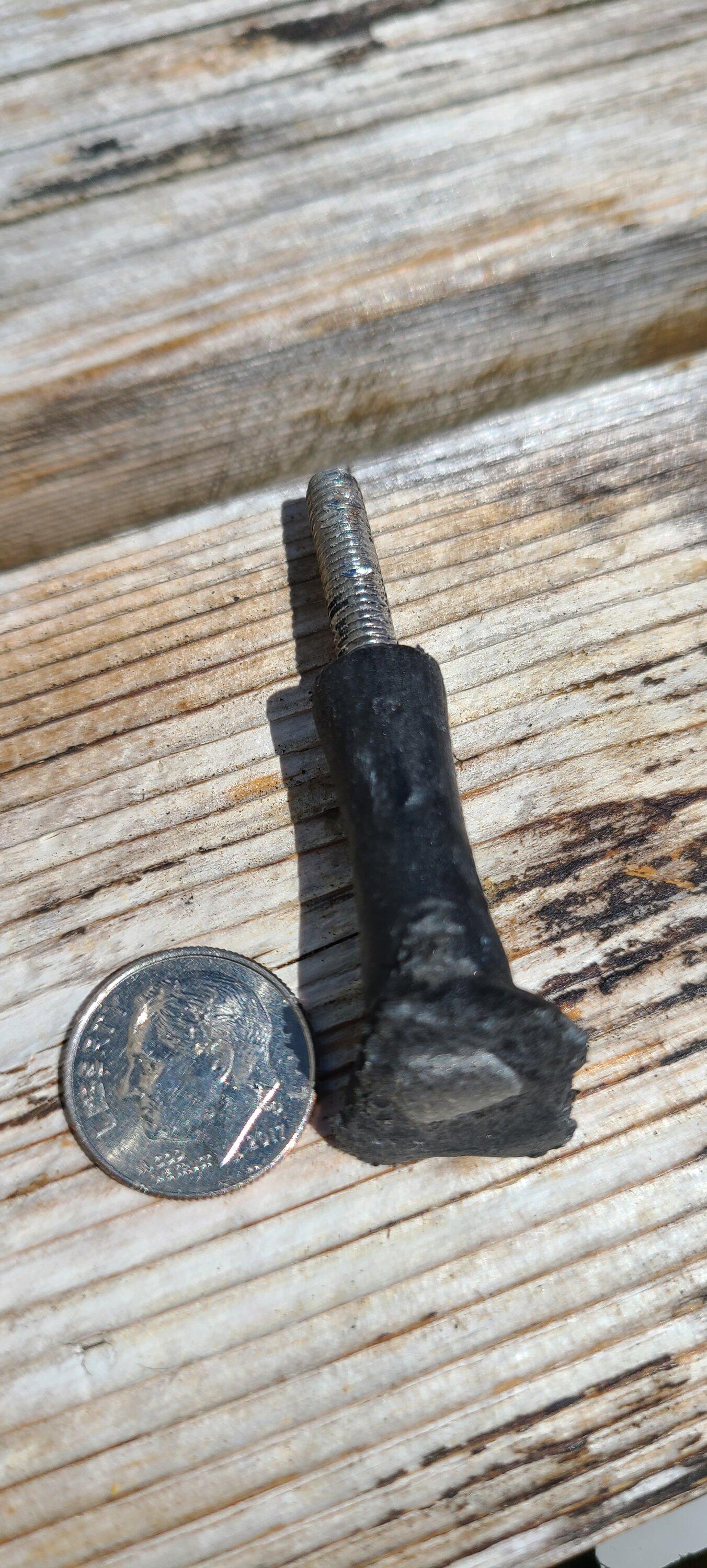

Traveling on Highway 1 and 101 from Carmel, CA to Seattle, my stock SAS Goodyears picked up some gnarly foreign objects. Lots of construction happening.
The first event started yesterday with a TPMS alert at 27 psi on the front pax tire. Pulled over, used my engine-mounted ARB and filled it back to 35.
Less than a mile later, that tire dropped to 6 psi. Whatever I ran over became dislodged and left a good-sized hole allowing air to escape. Pulled over, and immediately an awesome construction worker installed the spare, which had 35 psi.
Stopped at a nearby Les Schwab; they patched and plugged the bad tire...no charge (love that company).
The TPMS light never went out, tho, and indicated the replaced tire was still low, even tho the gage read 35 psi. Today, when the tire heated up and the gage read 36 psi, did it clear. Thus, my lesson about the TPMS light finally extinguishing seems to be the tires must be inflated to above 35.
My tire trouble wasn't over. As soon as the replaced tire indication was restored to normal, it was replaced with a TPMS alert for the drivers left rear tire; gage says 29 psi.
Limped into another Les Schwab. Look what they pulled out; buried to the hilt... Un-freaking-believable!
Ford Bronco TPMS Lesson Learned; Two Flat Tires in Two Days! 20230715_144942
So, now I have two patched and plugged Goodyears. Wonder how much more mileage I can get on them. I am at ~14K now.
And a GoPro thready boy! 😂
Assuming they were properly plug patched, I’d feel comfortable driving them till replacement is required

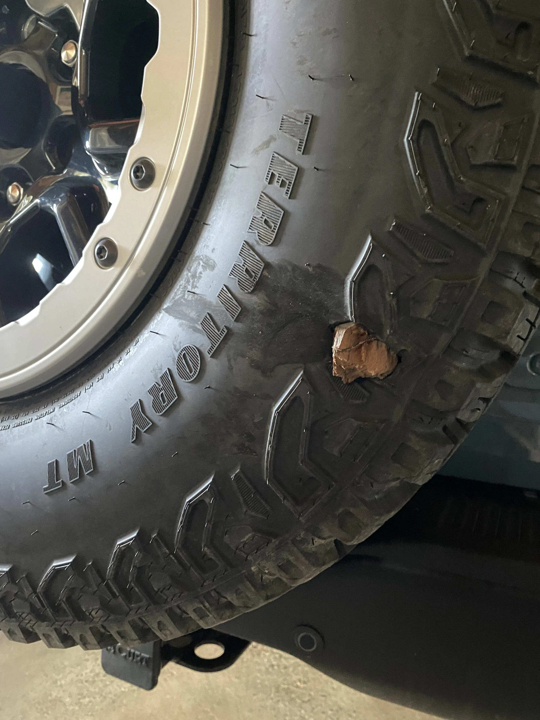

I’ll bet they last you. My tpms didn’t have to say a word when this one happened. It was like opening a can of Busch x 1,000.
YIKES! Was that a chunk of wood?

Oh, I have aired down plenty of times. Never had the lingering TPMS light before, tho.
It looks like it...So much for tough side walls....These are great tires for the road, but I'd never offroad in them.

There was a rotten log next to the trail, the front tire missed it but somehow that piece of heart wood jumped out at me. The trails were known to just be muddy/grassy so I didn’t bother airing down. Not sure if it would have made a difference but it had to have been at a perfect angle to spear it like that!
