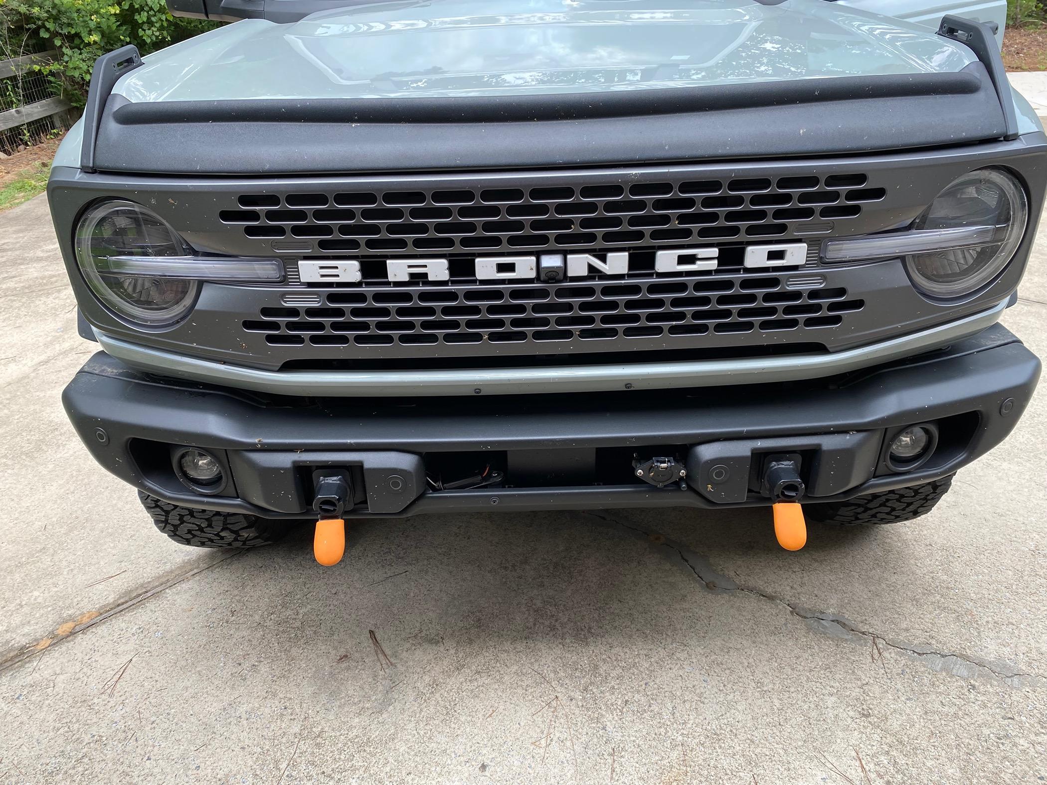

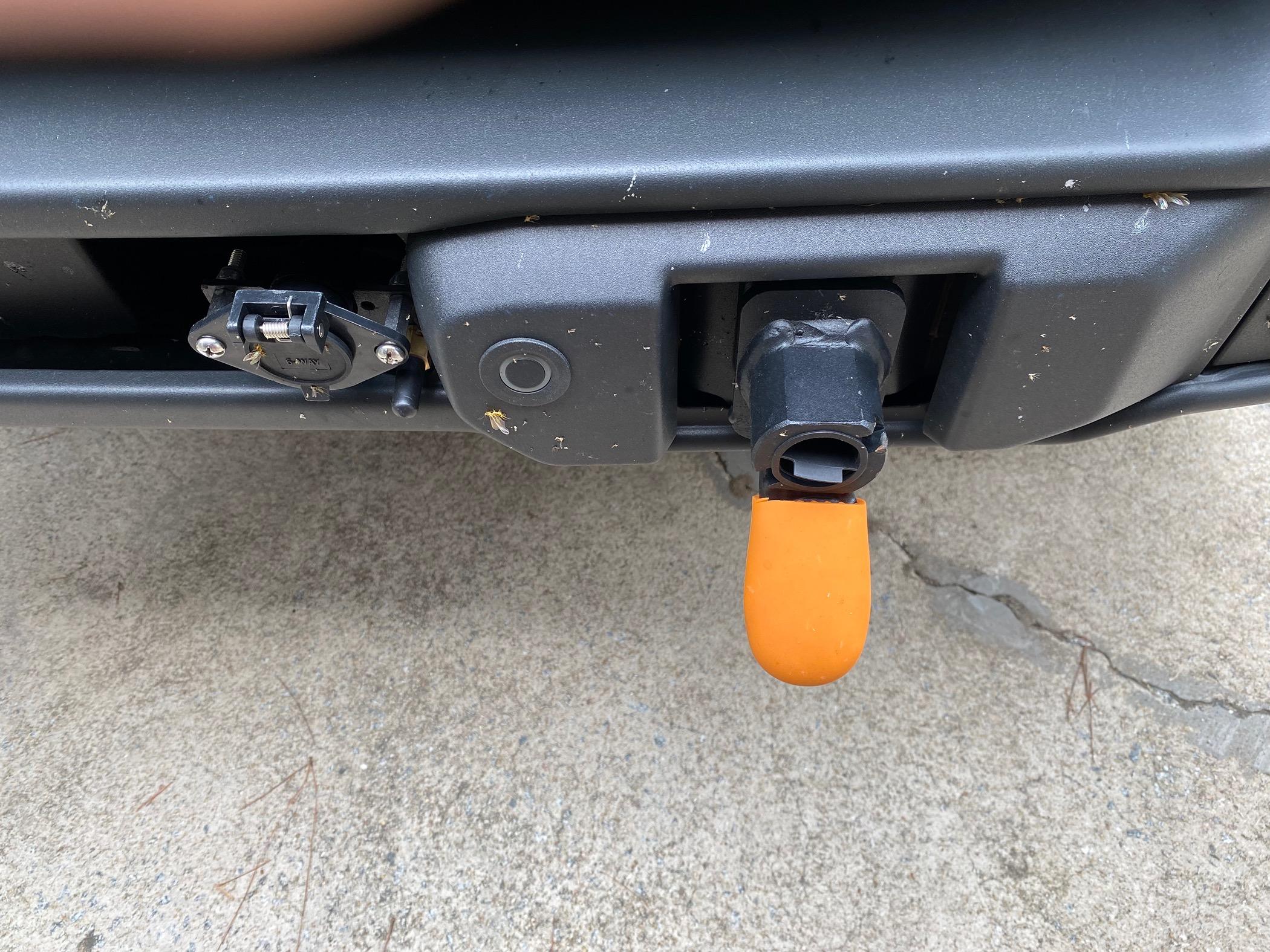

I have the Blue Ox set up as well. L as of trying to make it look better and met out of the need to protect my shins, I came up with using silicone handle covers. Got mine fro Lodge
https://www.lodgecastiron.com/product/silicone-handle-holder?sku=ASHH41
they have multiple colors but I went with orange. It’s the BL trim color and it stands out. I simply cut them down to length and added a drain hole on the front bottom edge.
Ford Bronco Tow-bar Connection Points IMG_2284
Ford Bronco Tow-bar Connection Points IMG_2285

I see some yellow ones in my future... ;)
