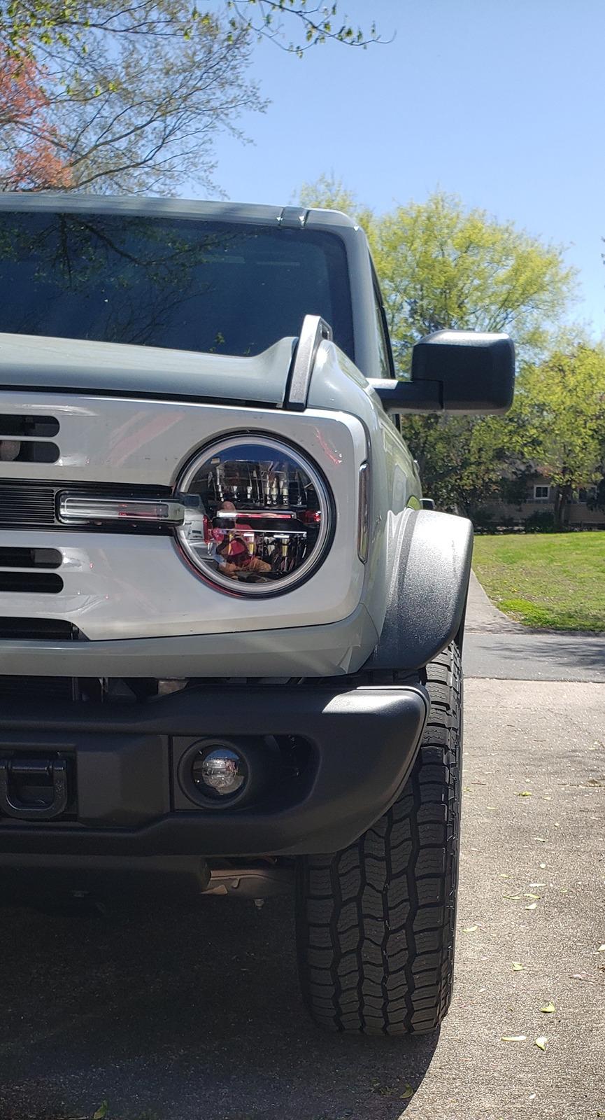

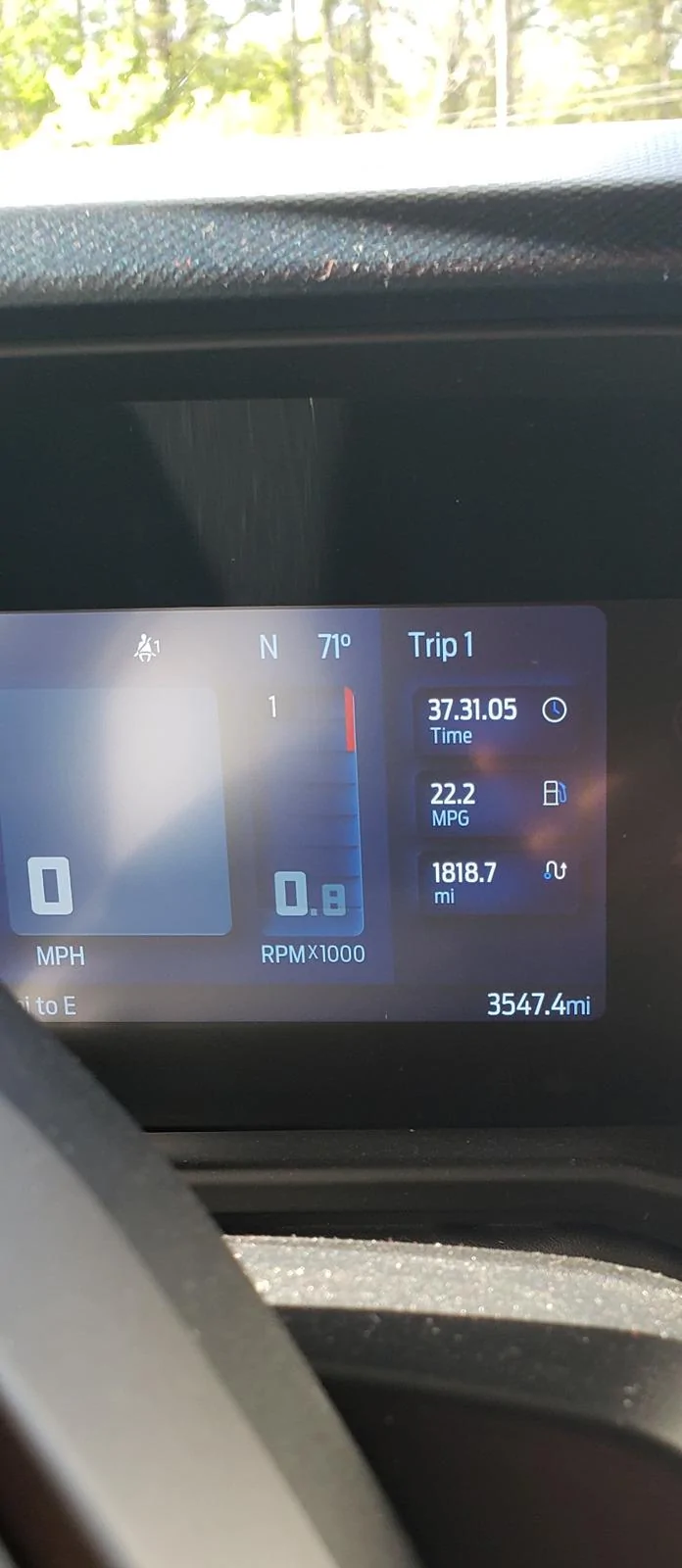

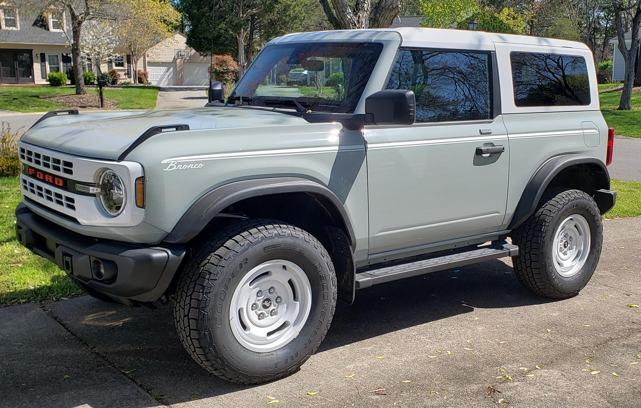

I had your same issues and goals, and swapped the Goodyears for Cooper Discoverer AT3 4S in size P285/70-17 (33" nominal). From some recent posts:
Stats on P-metric 285/70's, 85% non-interstate roads. 48.5 mph avg for the math folks, cruising in 5th gear @2300-2500 rpm.
Ford Bronco Tires 2024 Heritage 20240411_173121-jpg
Ford Bronco Tires 2024 Heritage 1713277451013-pq
Ford Bronco Tires 2024 Heritage 1713277497587-dl
Changes to the Forscan settings are required:
Switched out 315/70-17 OEM Territories to P285/70-17 Cooper Discoverer AT3 4S, used 2525 mm (was 2653) circumference (Thx um . . . @Tricky Mike ?)
and 35 psi (was 39 psi) TPIM settings. Speedo reads 1 mph over GPS reading, perhaps due to minor differences of LT vs P-metric spec. I'm good with it as is.
Note that if going to passenger car tires (vs light truck), the P tire load index is de-rated by 10% to be comparable to the LT tire load index, so the de-rated P285/70 @ 117 load index 2833 lbs x 0.9 =2549.7 is greater than the stock LT315/70 @ 113 load index of 2535 lbs. 117 is the lowest P-metric load rating equivalent to satisfy the de-rating spec. For this reason, Discount Tire would not install a lower load index tire set (P255/75) I had initially purchased.
