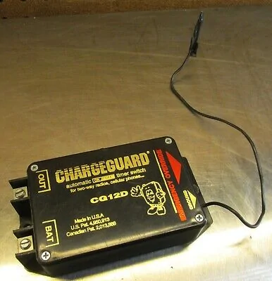

I would install something like this with a 50amp relay feeding it.
This was one of my exact ideas. I was thinking of running two fuse blocks... One directly to the battery and the other to the timed circuit so that it would still be powered after shutting off the Bronco but for only so long.
At work, we used these to wire up all the electronics in the trunks. They have a timer that will shut everything off after X minutes OR If the voltage drops below a certain amount.
Ford Bronco Timed circuit power tap accessory? s-l400
