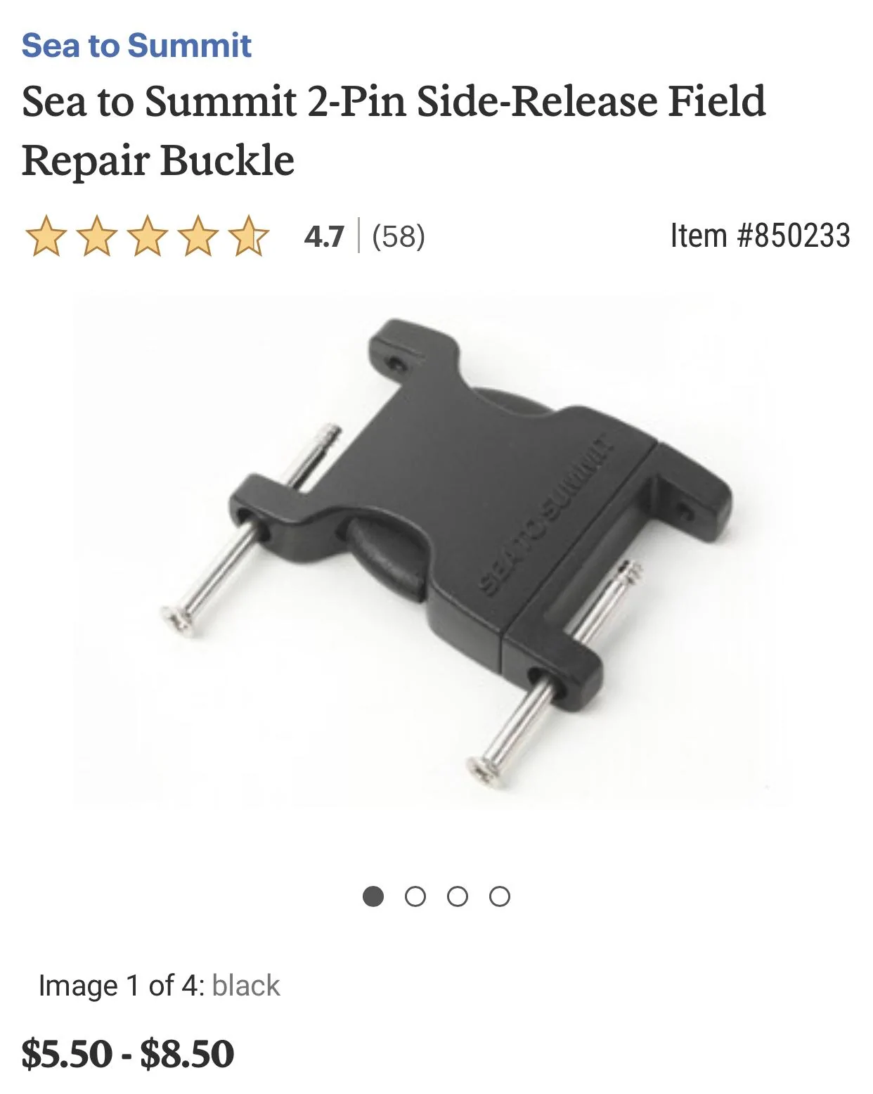

You should be able to use 1/2 of this repair buckle, install it on the strap above the current buckle, and connect it to the existing lower mate, thereby pulling an inch or so of slack. This way you don't have to cut anything to give it a shot. This is what I am trying once I get my Bronco.

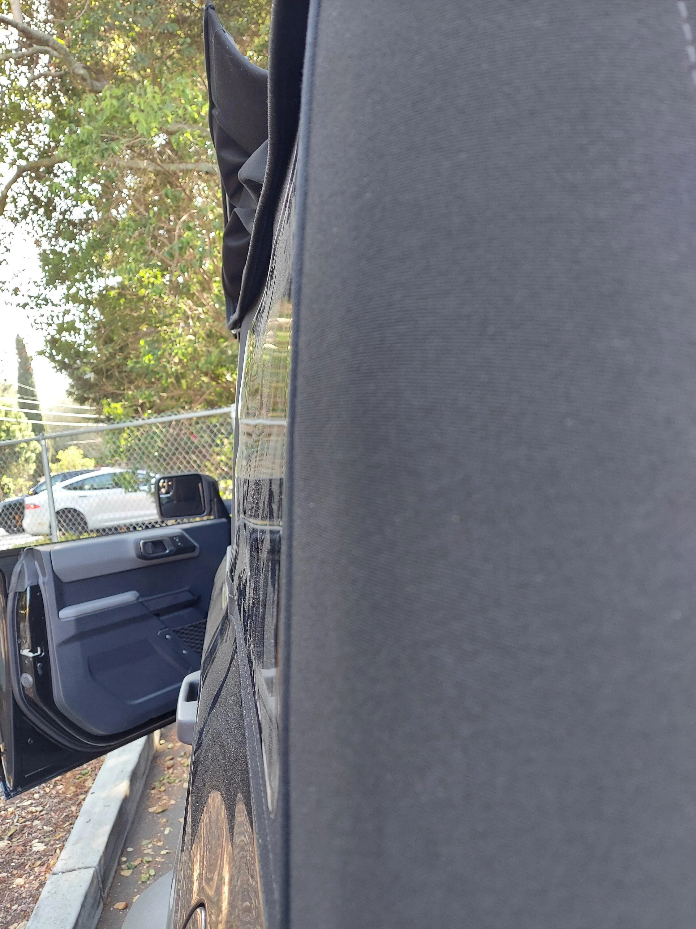

I was able to tighten my rear softop windows a bit by just twisting each top fastner (male side) a full 360 degrees prior to being fastened, which had the effect of decreasing the fastner's overall length.
This method might strain or wear the strap of the fastner, but I found it worthwhile.
The results make it less wavy than normal, however, it does not eliminate the wave entirely.
Overall, I'm more satisfied with the look of my softop now.
