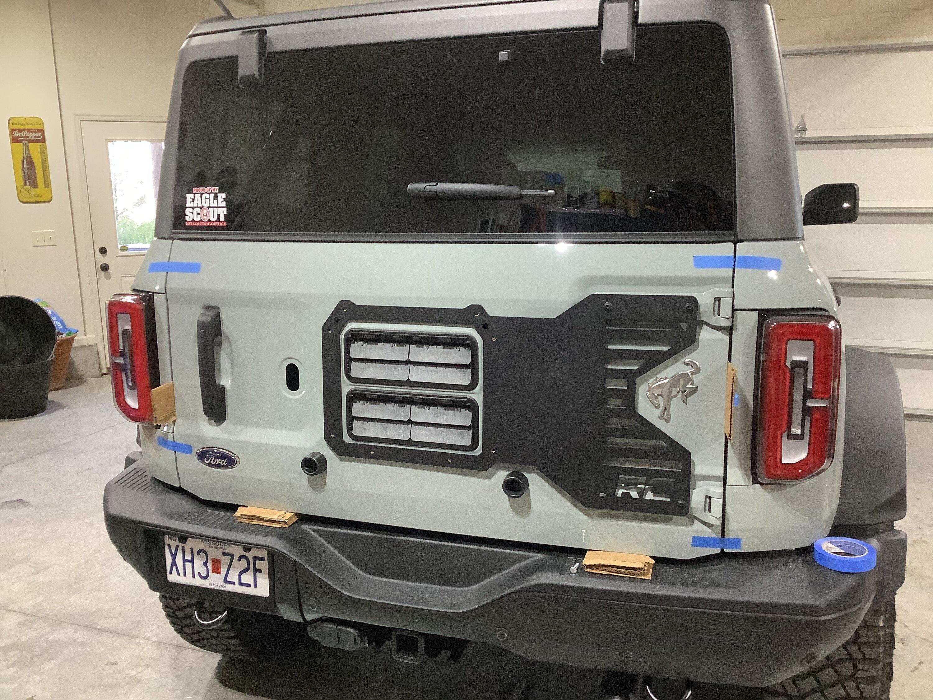

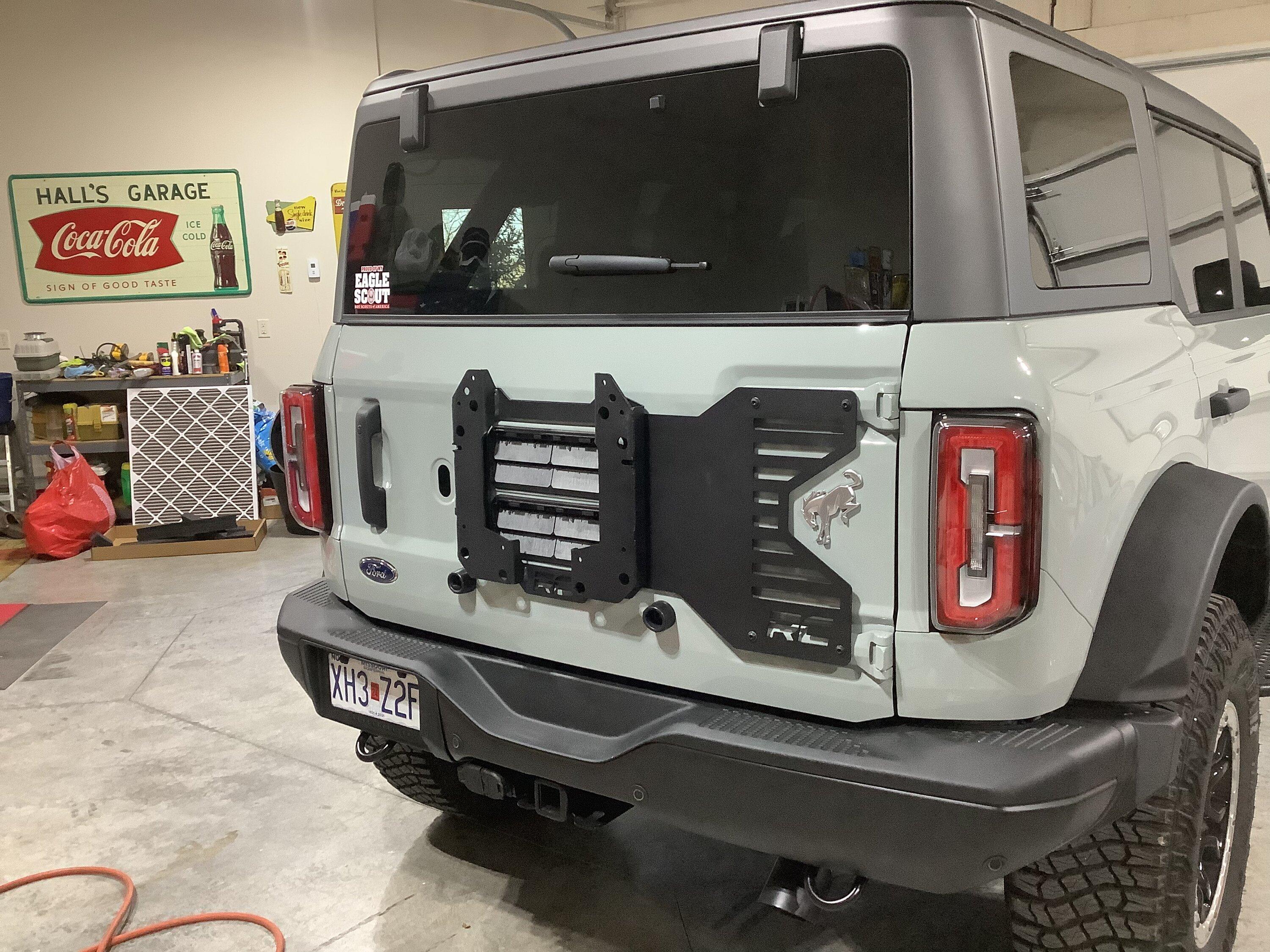

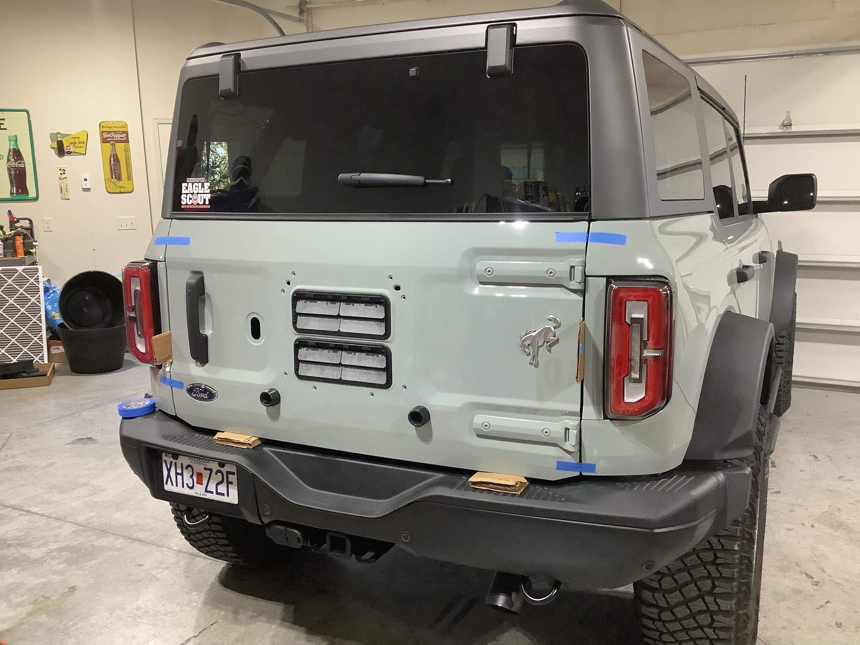

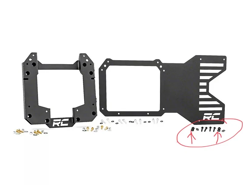

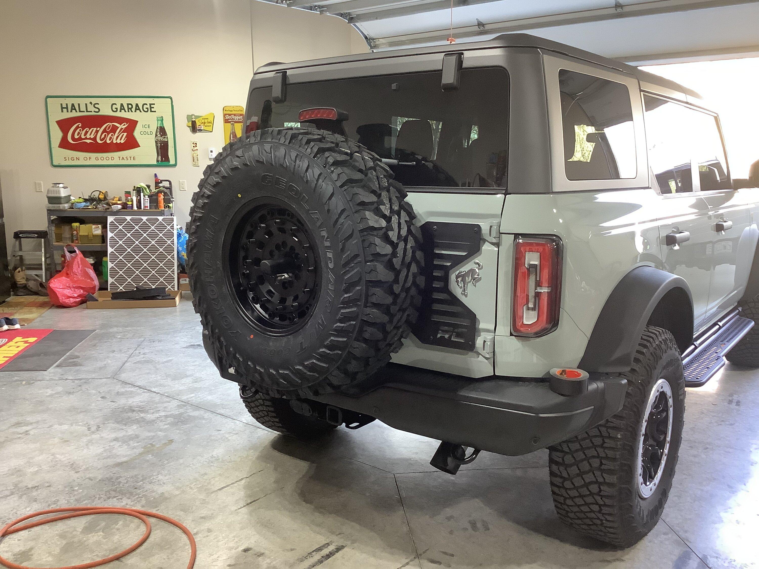

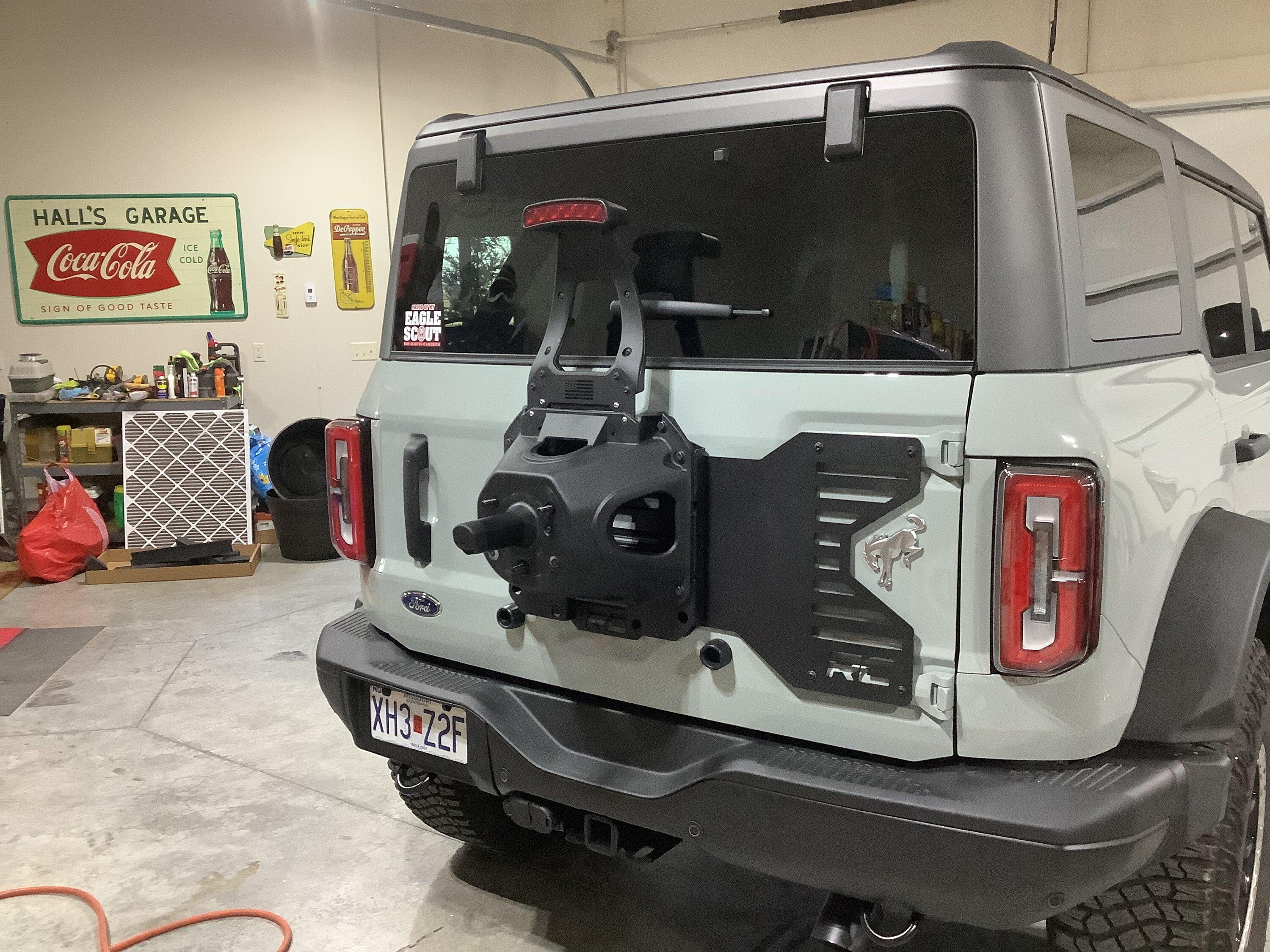

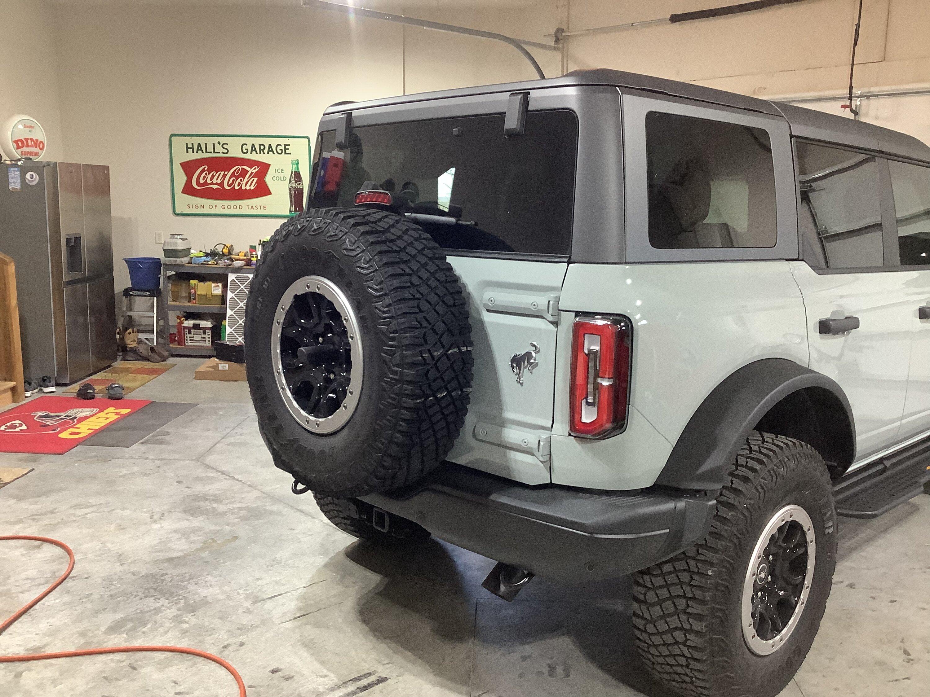

I used the Rough Country reinforcement mount. It has spacers that goes in where the bolts go doesn’t touch the surface of the hinge. The last photo shows the beveled spacers that act like the head of the bolts that goes in the hinge under the bracket.
