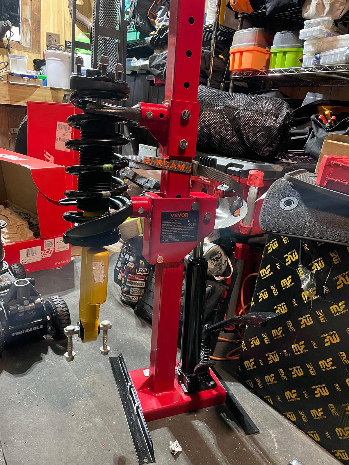

Well, the rears were a breeze. The fronts are being a bit more difficult. I finally was able to get it compressed enough to thread on the nut, but then I realized everything got misaligned. I’ll have to compress it again and rotate the strut and line it back up.
Hopefully the other front goes a but smoother now that I have a method. I guess the front springs are a bit shorter. So, it’s a bit difficult to compress it enough to make up the 2” difference.
My workspace is a bit of a shit show right now. But, this Vevor spring compressor is pretty robust for $135. I sorta wish I had one of those drill clamps to counter the bend to one side that’s occurring and full compression. But, I’m making it work.

All 4 corners are assembled. Not bad for my first time. Learned a lot and it got easier with each one. The fronts are definitely more of a challenge. It was imperative that I rotated the spring in-between the yokes just right so that the spring stayed as straight as possible during compression to get strut shaft through the top hat enough that I could thread the nut a few turns before torquing it down.

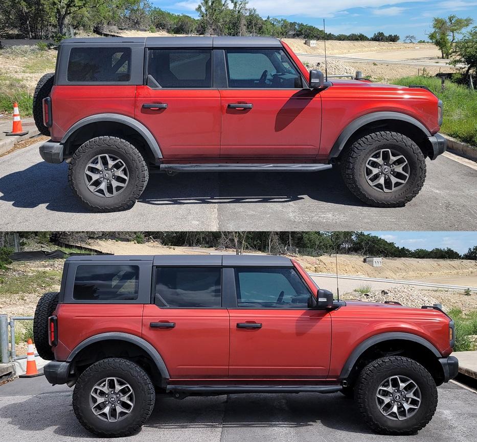

I used an amazon compressor with an electric impact driver, and hex to 3/8" drive adaptor.

Nice. What size tires are those? I need to get mine installed. They’re assembled. Just need the time.

Stock 285/70R17 (32.8)

Awesome. I was worried that my 285/75 would look a tad small. But, this looks great.
I had the same concern. Now I'm not so anxious about waiting for the 35x11.5 Wildpeaks I will eventually move to.
