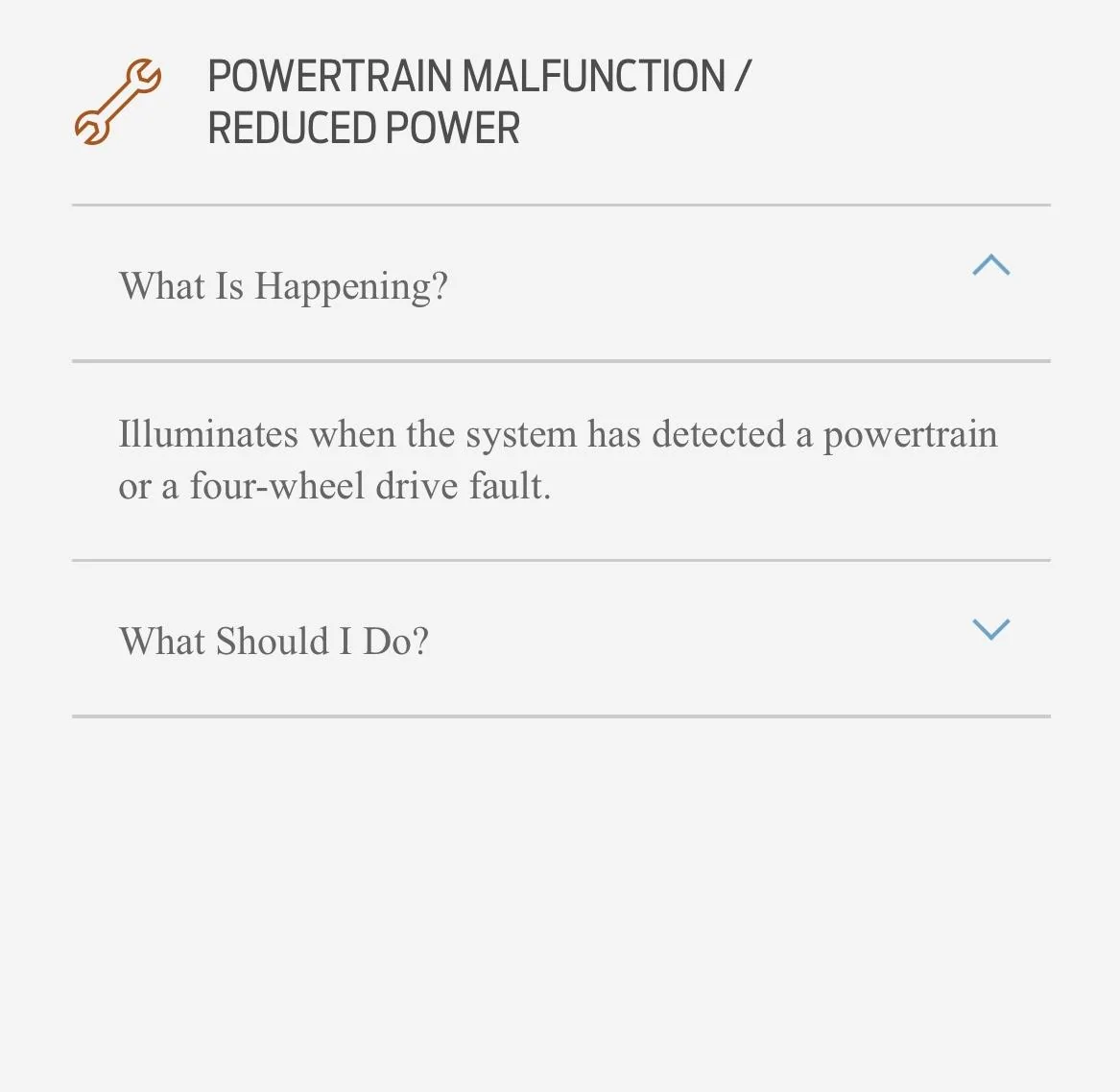

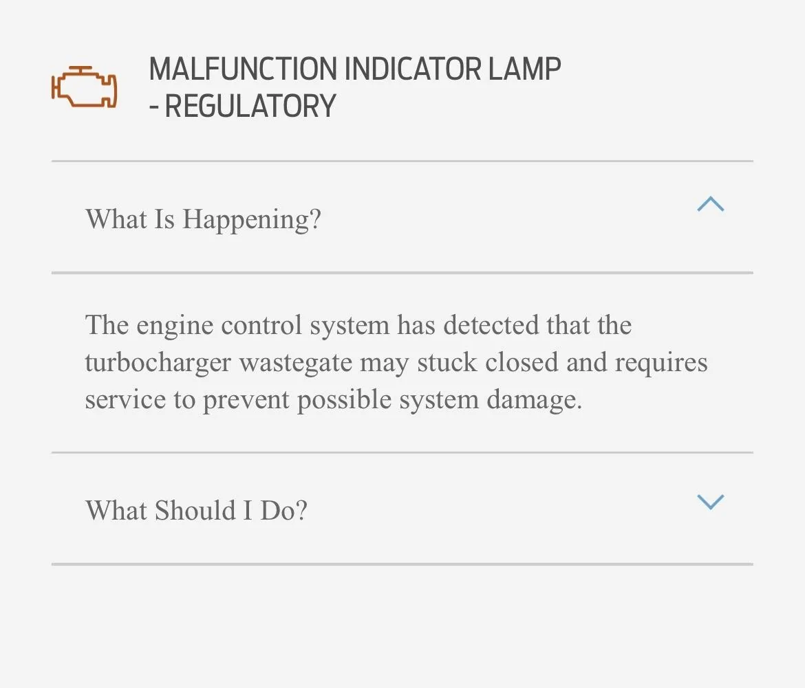

I took ownership of my 2021 Base 4dr Sasquatch 2.7 Bronco in November of 2021. I’m just shy of 2k miles (about 1,975) and the other day while on the road my shifting became irregular, power dropped substantially (extremely slow off the line, acceleration very sluggish, hills were challenging for acceleration), and the engine bay began making some… electronic noises?
This was accompanied by the following error messages and dash lights. Earliest I could get it in to my local dealer is the end of the month, so just playing a waiting game. Anyone have experience with these? Curious what the issue is beyond these messages and whether or not it’s an easy fix.

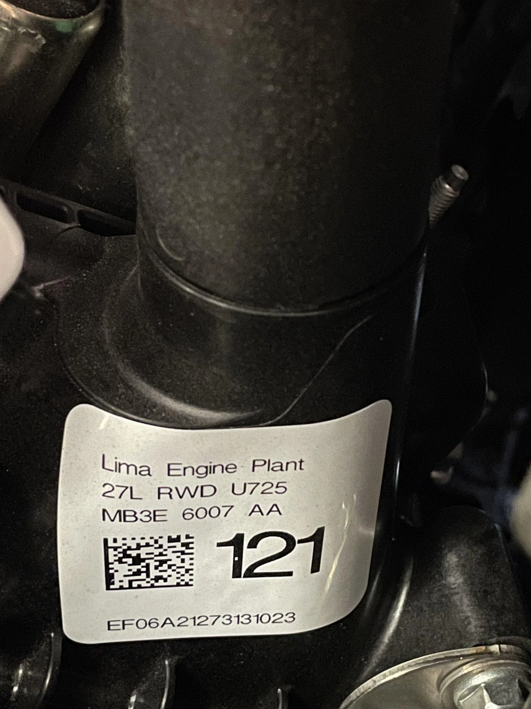

engine code below. i could not see or feel any loose clamps, though as someone inexperienced I’m sure there are more I did not check.
eerrr engine code didn’t load: EF06A21273131023

Wastegate stuck closed sounds very possible and also would match the driving symptoms, if a gate is stuck close it would build max boost and blow the motor but it caught it and is now dumping boost and not building any (guessing). Honestly you guys are like the mob grabbing pitchforks for 2.7s when this doesn’t seem to match up to dropping a valve or blowing a motor at all. Besides when most 2.7s go they shut down and cannot be driven home.

As promised. Checked hoses and at first glance I’m not noticing anything loose, though I’m inexperienced and likely have missed some.
Looks like it was built Sept 30th of 2021. Which I believe is in the blown engine window that the other thread is tracking. Hope it’s not that! Good luck!
