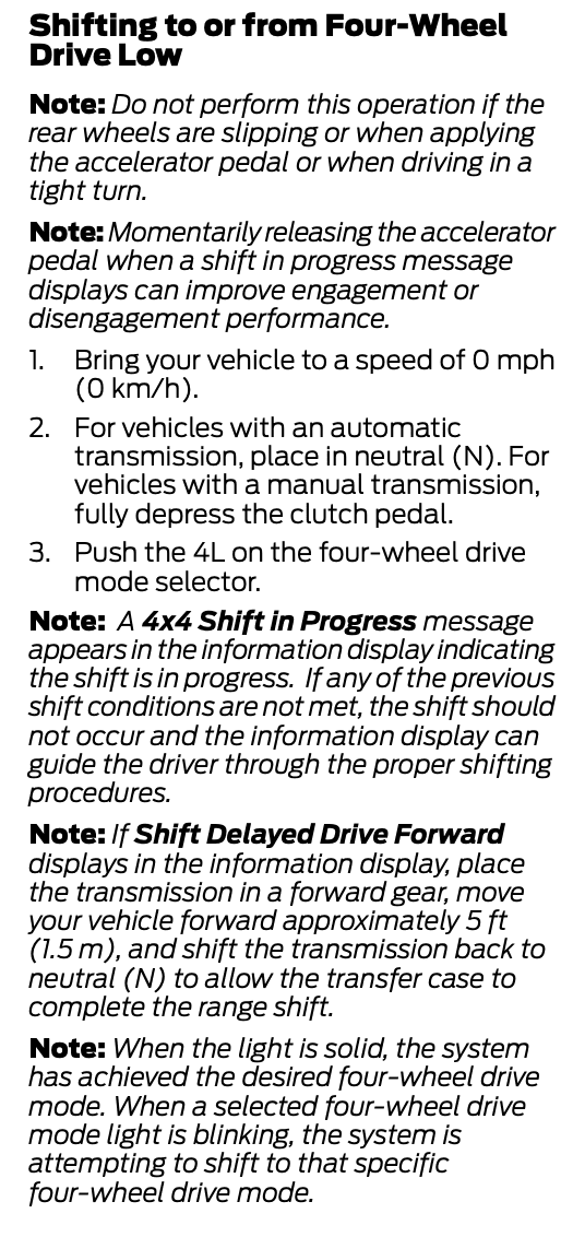

I had this issue today when trying to show somebody how the GOAT modes work and enable the lockers and stuff automatically. Was just sitting in my driveway, foot on the break, put in neutral, change mode to rock crawl mode. Then it got stuck and said there was a fault in the 4x4 system, and to service the vehicle soon. Would not let me shift it back to any other mode. Got a little worried, certainly did not impress the older gentleman that I was showing haha! Came inside and did a quick search and saw this thread, so I went back out and put it in reverse for a split second, then went forward a few inches, then put it back in neutral and hit 2h and it went back just fine.
I mean I wasn't planning on driving around like that obviously, but I didn't think it would be an issue to just let it do its thing if I wasn't moving. I've seen this on some older vehicles that had mechanical shifting t-case's, just had to move a little bit to let it lock. I just didn't think it would be an issue on this, but it makes sense I suppose. Just rather annoying that the thing flipped out and said to service the vehicle. Seems ok now, but I naturally got a concerned there for a bit.

This happened to me yesterday. When I shifted into 4L, I think something happened in the front-end that didn't engage. I write this because the back tires were spinning and the fronts were not. I suspect that whatever this issue was caused the "Check 4x4" alert. Then the wrench icon appeared and get it to the dealer warning. I was stuck in low range.
None of the transfer case buttons lit up, nor did anything when you push them. The goat mode dial did bring up the modes on the dash cluster, but it didn't shift the transfer case with the different modes.
I shut the rig down for a few minutes and then turned it back on. The 4L light was then lit up on the button, but no ability to change. The warnings came back on immediately.
I shut it down again for five more minutes. This time when I turned it back on, everything seemed to reset. I was able to shift it back to 2H. No warnings.
To my wife's dismay, I then put it back in 4L and tackled the obstacle that started this adventure. No continuing problems.
