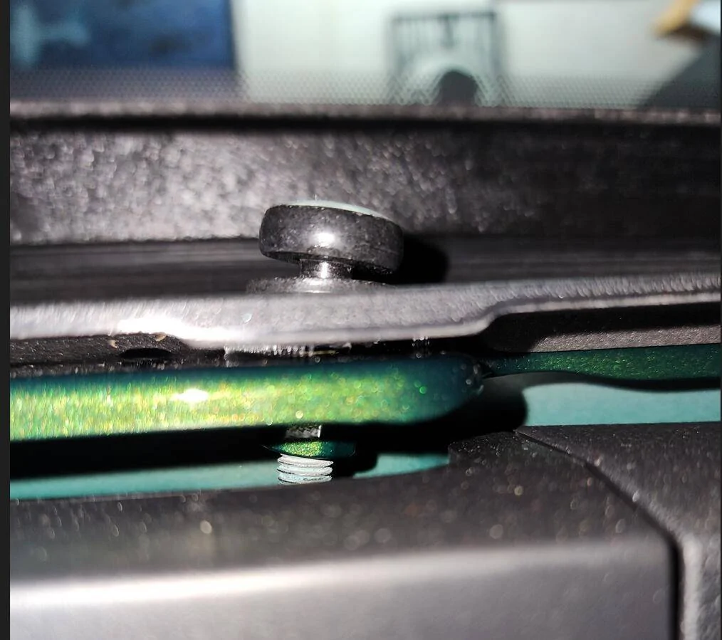

I’ve had my Bronco for about a week and just now getting around to checking out everything closely. I was looking around in the back and noticed one of my hardtop mounting bolts sticking up about 3/8 inch. I tried to screw it on down but it would not budge. I took it out and tried reinstalling but it got to that same point and stopped.
That’s when I decided to look on here just to see if anyone else might have something similar and wahlah- here it is. Same bolt same side. The guy responsible for that bolt on the line must have been having a bad day(s). I’m going to try a shorter bolt in that spot for now and use that one in place of the one behind it as the torx is all wallowed out on it in addition to this issue. Good times!! Still love the Bronco

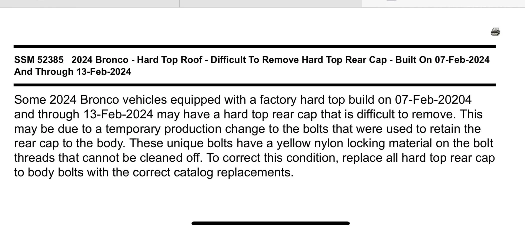

There is a special service message for this concern for 2024’s,
maybe other years are affected see attached

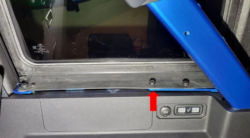

Well let me tell you my story. I bought a new 2024 Wildtrak. In early August I attempted to remove my hardtop for the 1st time and found the left rear most fastener difficult to remove. The next on up was even tighter so I stopped at a half-turn. This picture is of the third fastener. This is where I stopped. I live about 90 miles from the dealership. However, I asked my salesman (and sent the attached picture) about it since he has owned several Broncos. His response was "...looks like something if off". The appointment they scheduled form me was 17 Sept.
Technician said I cross-treaded it during installation thus it is not covered under warranty. I explained to the service manager the above whole story. He had my salesman and some manager go out and inspect my vehicle and told me someone would get back to me. Well, it is now Oct 4th and I haven't heard from anyone. We had a couple of storms come close to the area of the dealership but I have think I have given them plenty of time to get back to me. I plan on stoppy by next week but I suspect I am going to get the same "you did it so it's not under warranty.
