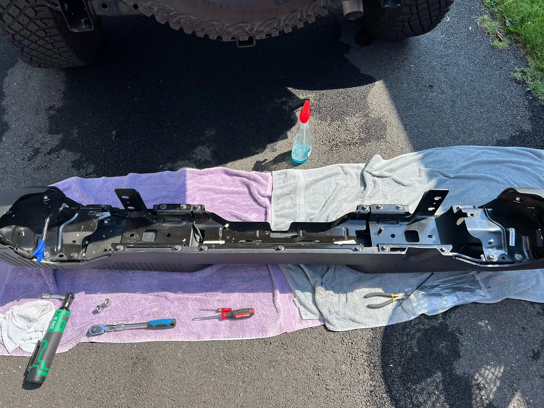

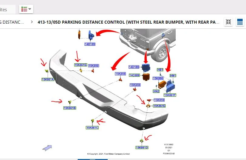

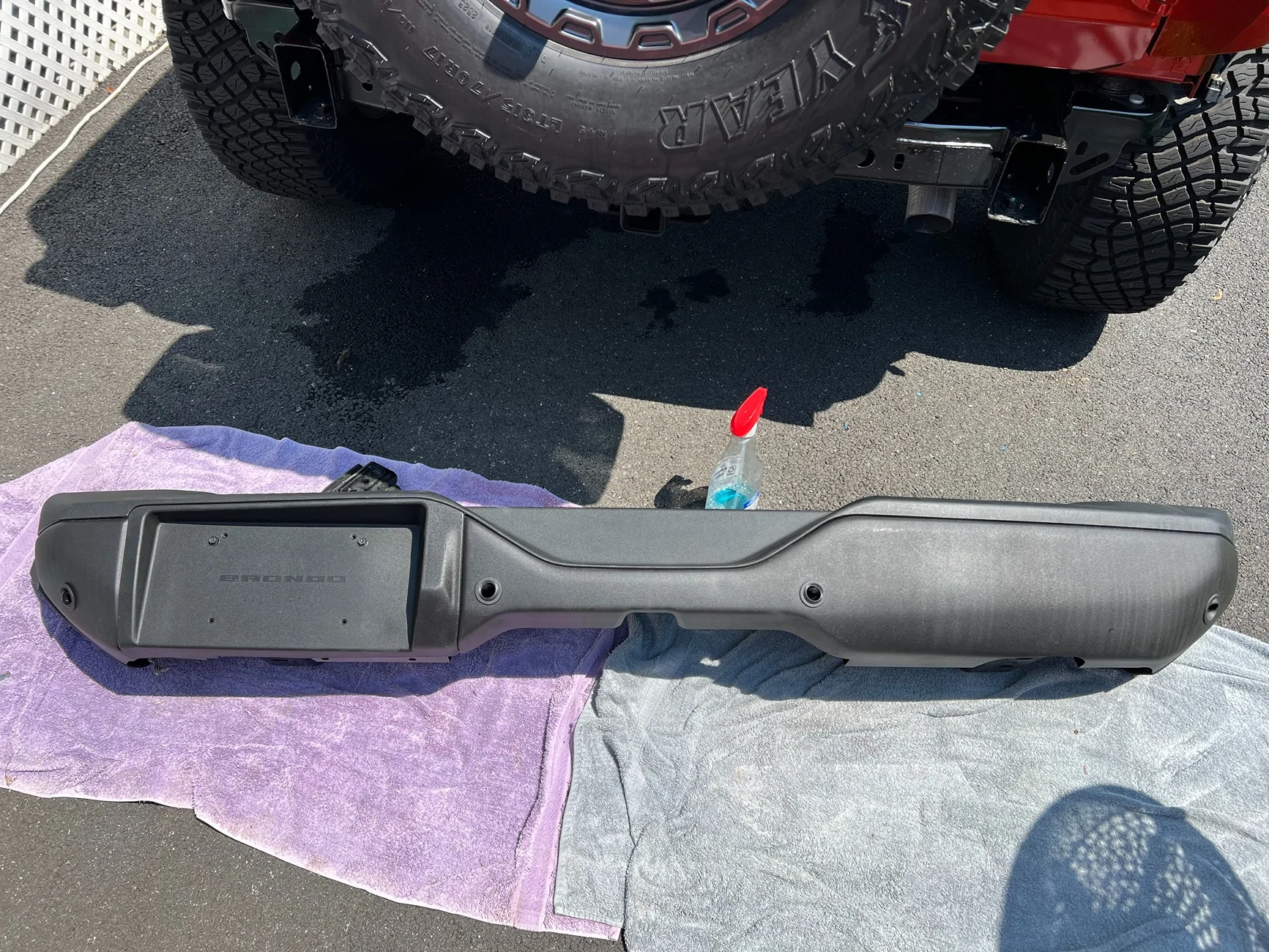

I did the swap on my 23. I did need parts. i dont know if the base has ssensors or not I am thinking not then it should be pretty easy. This is the parts list. I worked with @flip to buy them.
M2DZ-15K861-CBSensor Ring1
M2DZ-15K861-CCSensor Ring1
M2DZ-15K861-CDSensor Ring1
M2DZ-15K861-CASensor Ring1
M2DZ-15K861-HCollar Retainer1
M2DZ-15K861-GCollar Retainer1
M2DZ-17F774-DDEnd Cap1
M2DZ-17F774-DCEnd Cap1
-W718905-S300Bumper Cover Spacer Panel Clip 6
You may or may not need the end caps.

The one I purchased was a take off from ebay, The sensors/retainers for the plastic bumper are different on the steel. The end caps were missing.

Ah, I swapped out the front plastic one also. I purchased the parts before it was added as an accessory part. It was more difficult to put together but since I bought it in parts there were no directions.
