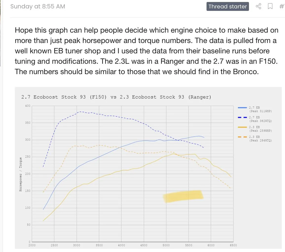

Personally I'm more concerned in where the power curve is / will be . Making peak HP /Tq means nothing if its in an unusable rpm range. I want the torque to be down low for tail use. My understanding of having twin-turbos is to have a more constant power curve, where when one turbo is cutting out the other is cutting in to alleviate lag. Am I thinking correctly?
That is true in some applications, but not this one. You have two equal size turbos each feeding their own bank of cylinders.
Small turbos, quick spool, FAT torque curve through the most usable part of the rpm range.
full torque by 3000 rpms should be very responsive from both the 2.7 and 2.3. See baseline dynos on a Ranger 2.3 and F150 2.7 From another thread:

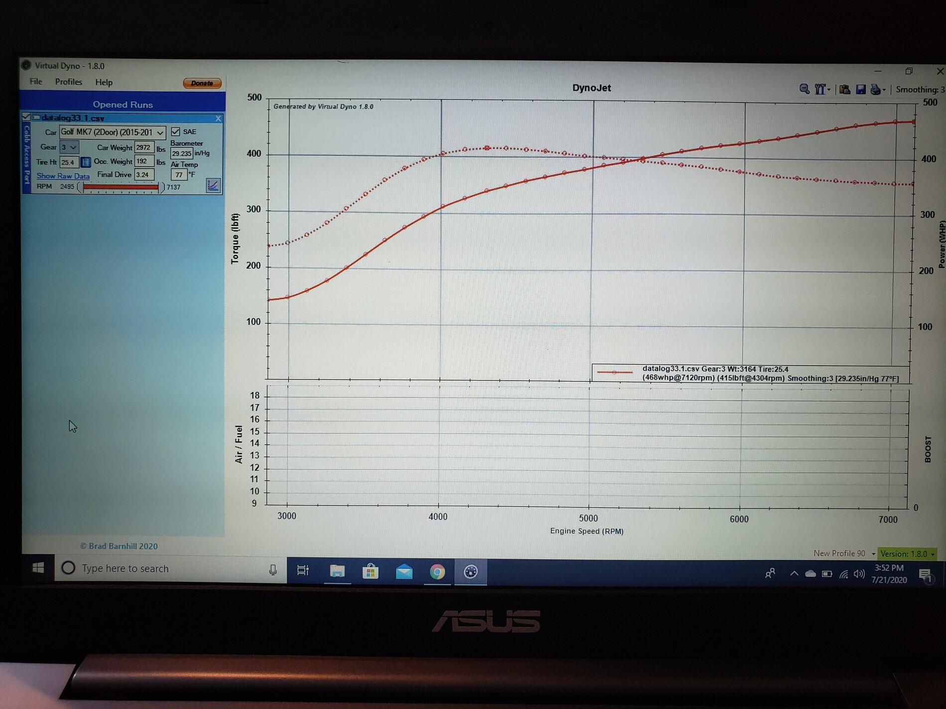

Coming from a heavily modified big turbo 500 hp mk7 GTI, I will be just fine with an IC, intake, DP and exhaust.
VD of GTI...
Ford Bronco Sooo intercoolers, BOV and headers? 20200721_155110

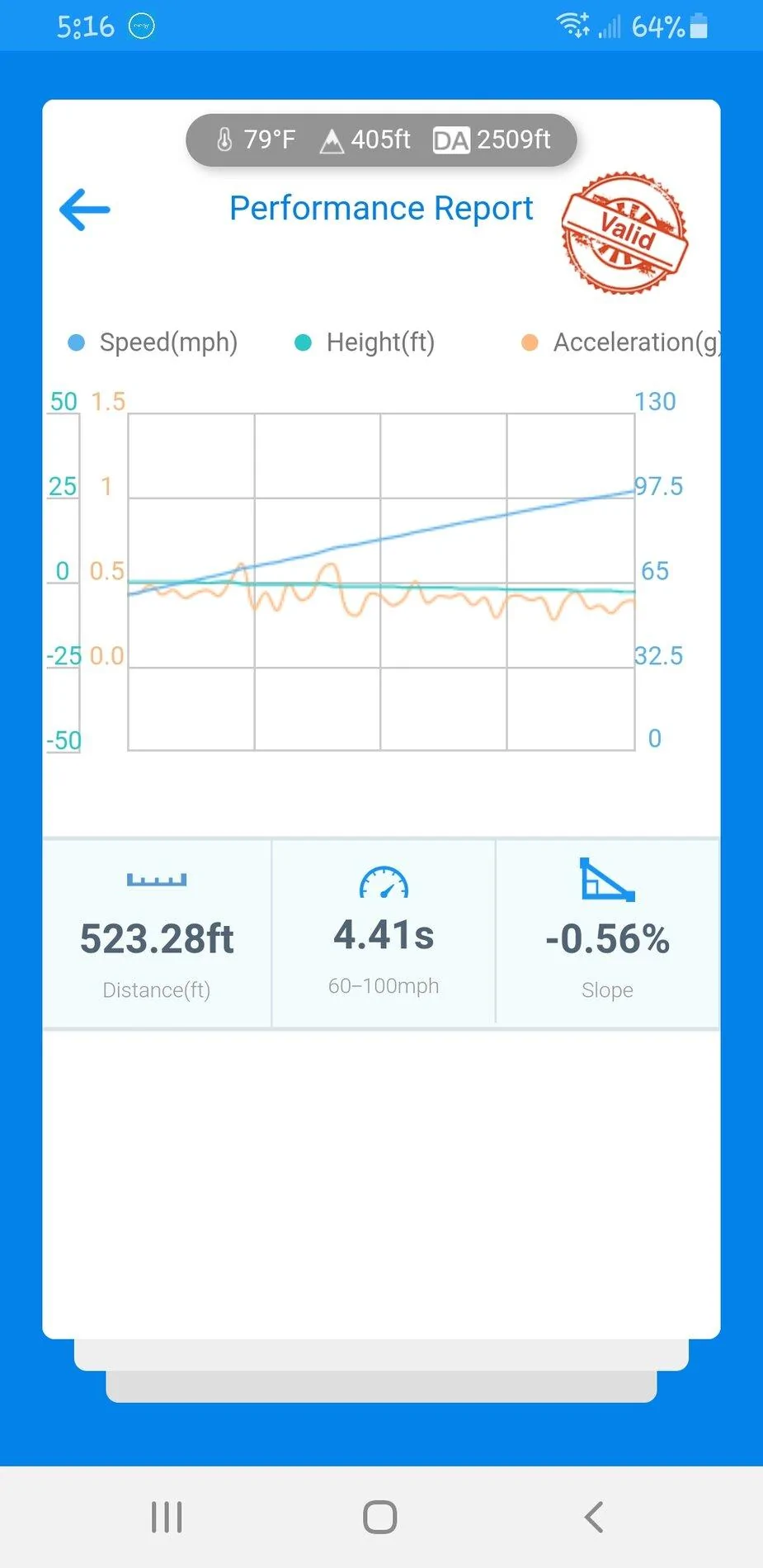

Last Dragy with not the best DA for 60-100.
Ford Bronco Sooo intercoolers, BOV and headers? Screenshot_20200802-171614_dragy
