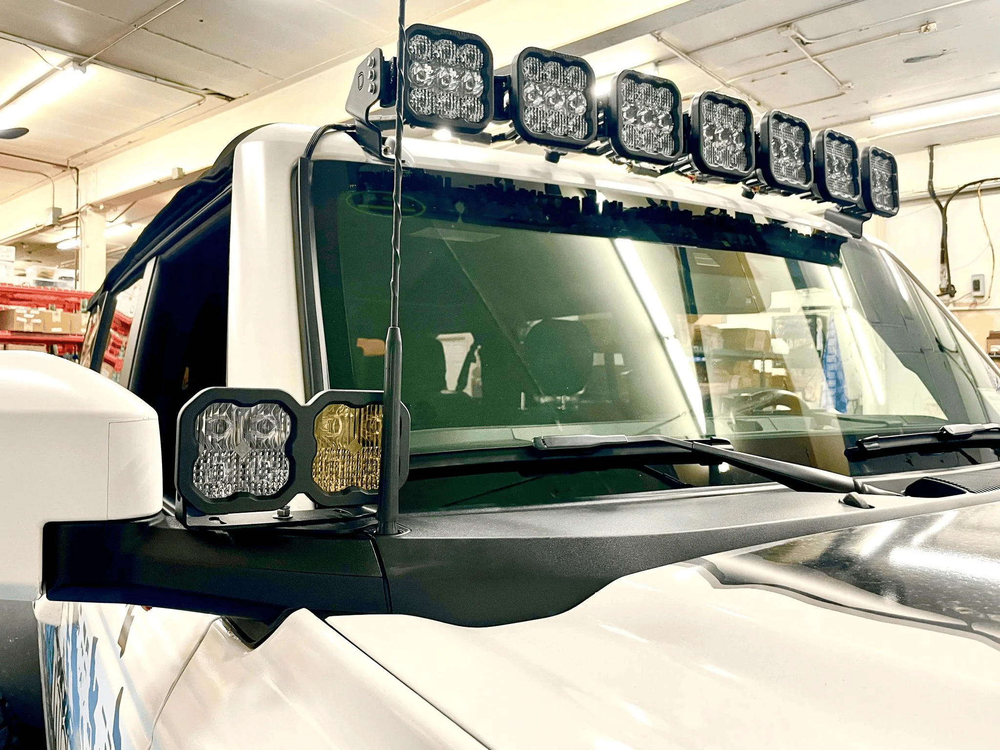

For the wiring... yeah don't use the wire up there, it's 100% useless. We use the KC wire hiders on all of our installations:
https://www.4x4truckleds.com/kc-hilites-universal-wire-hider/
Here is what it looks like, nice and out of sight

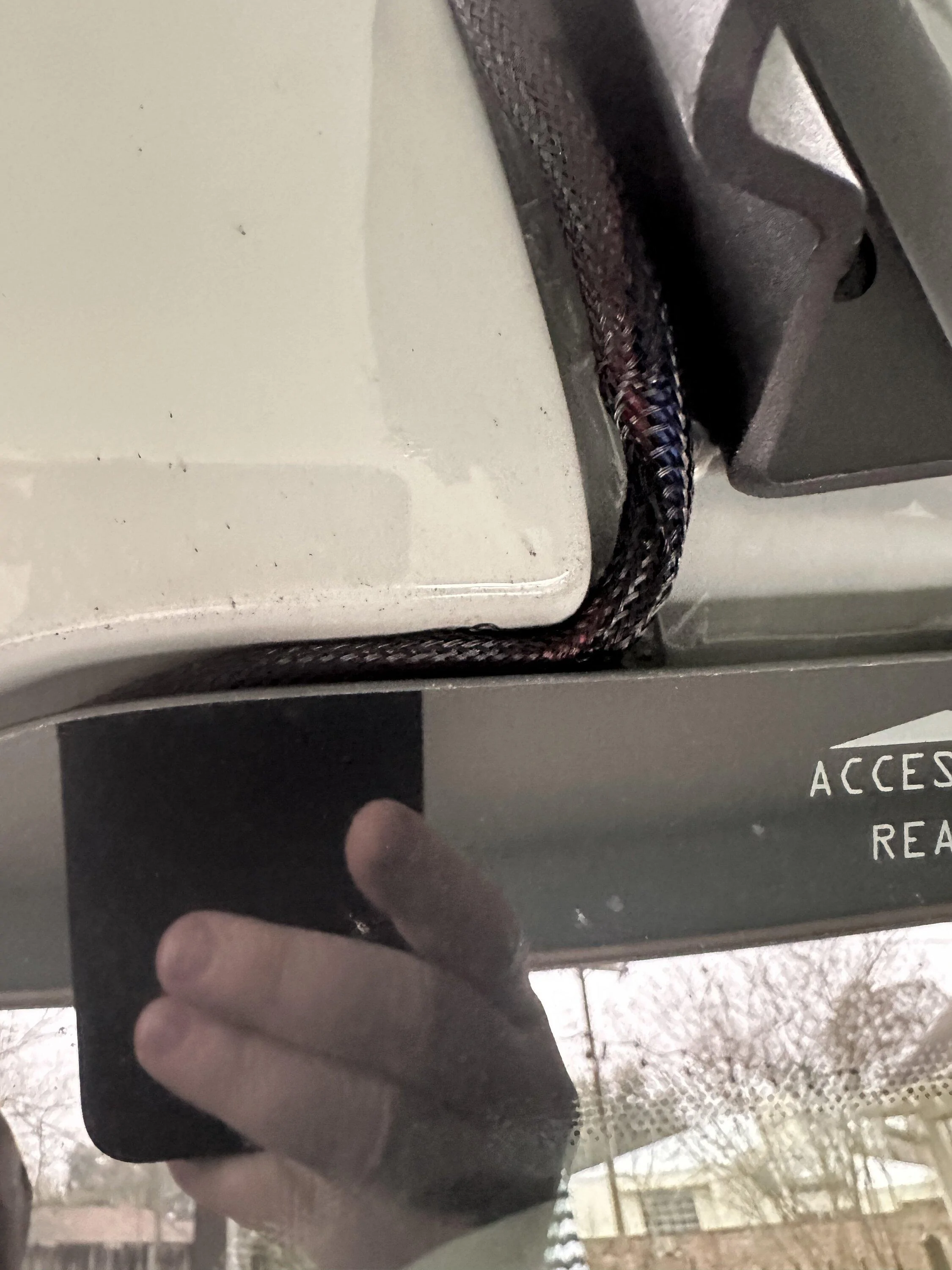

Do you have pictures? Would like to see how you have that wire run along side the windshield.

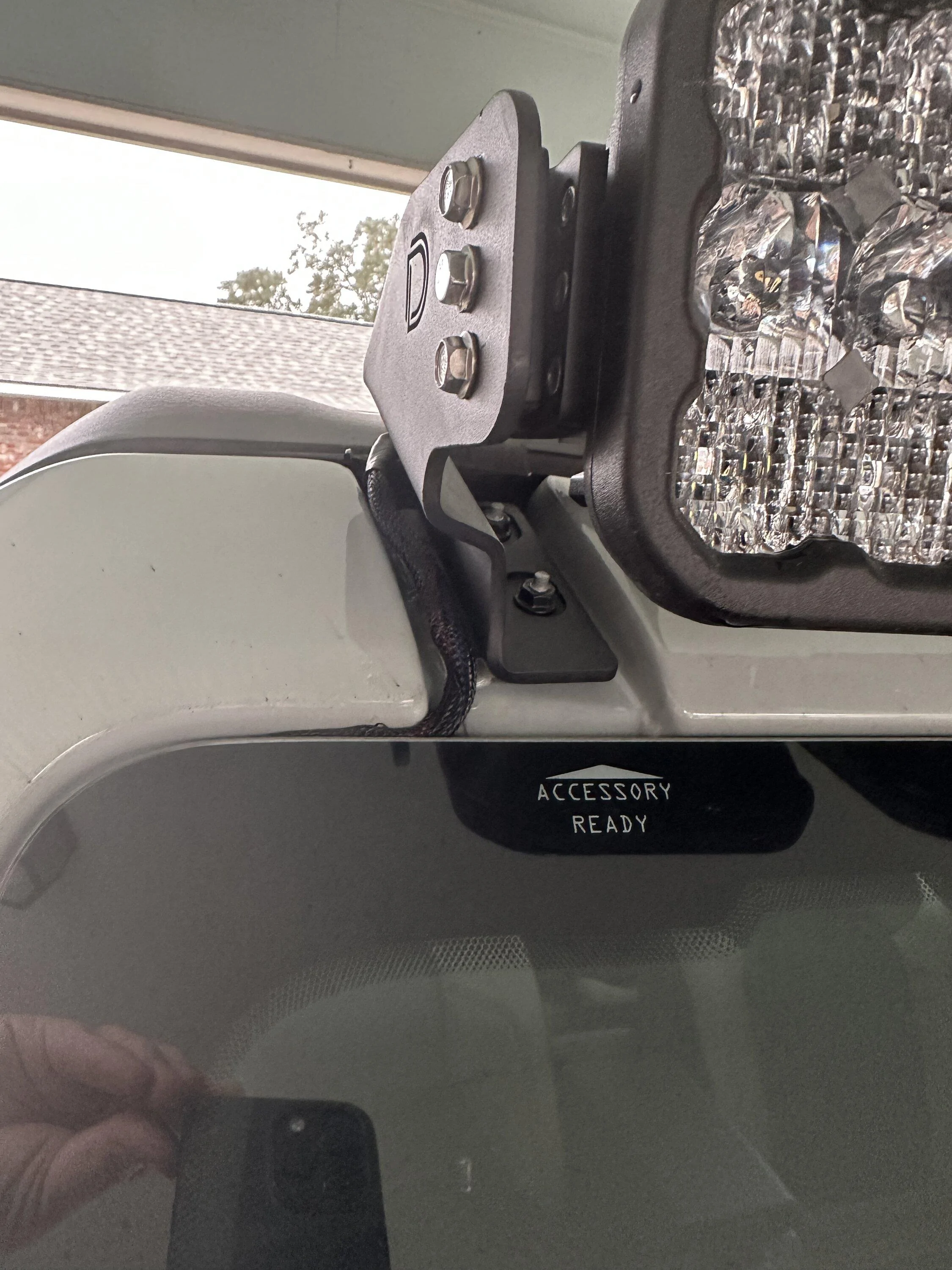

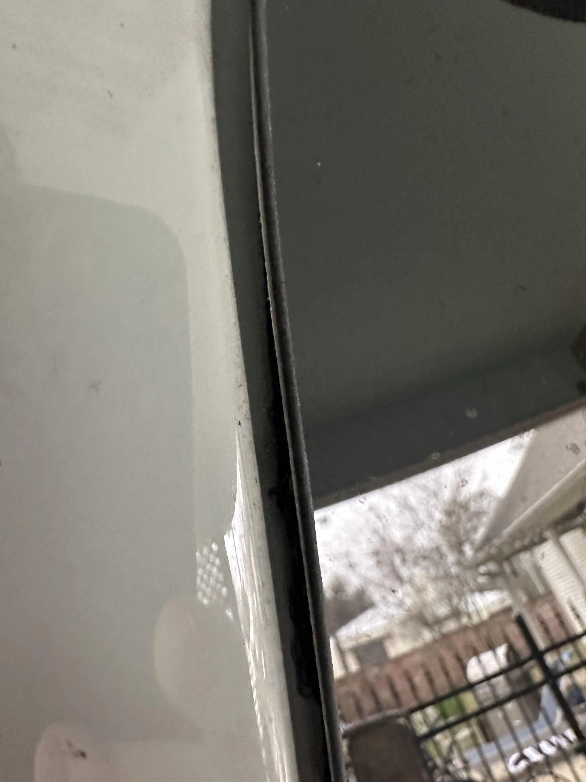

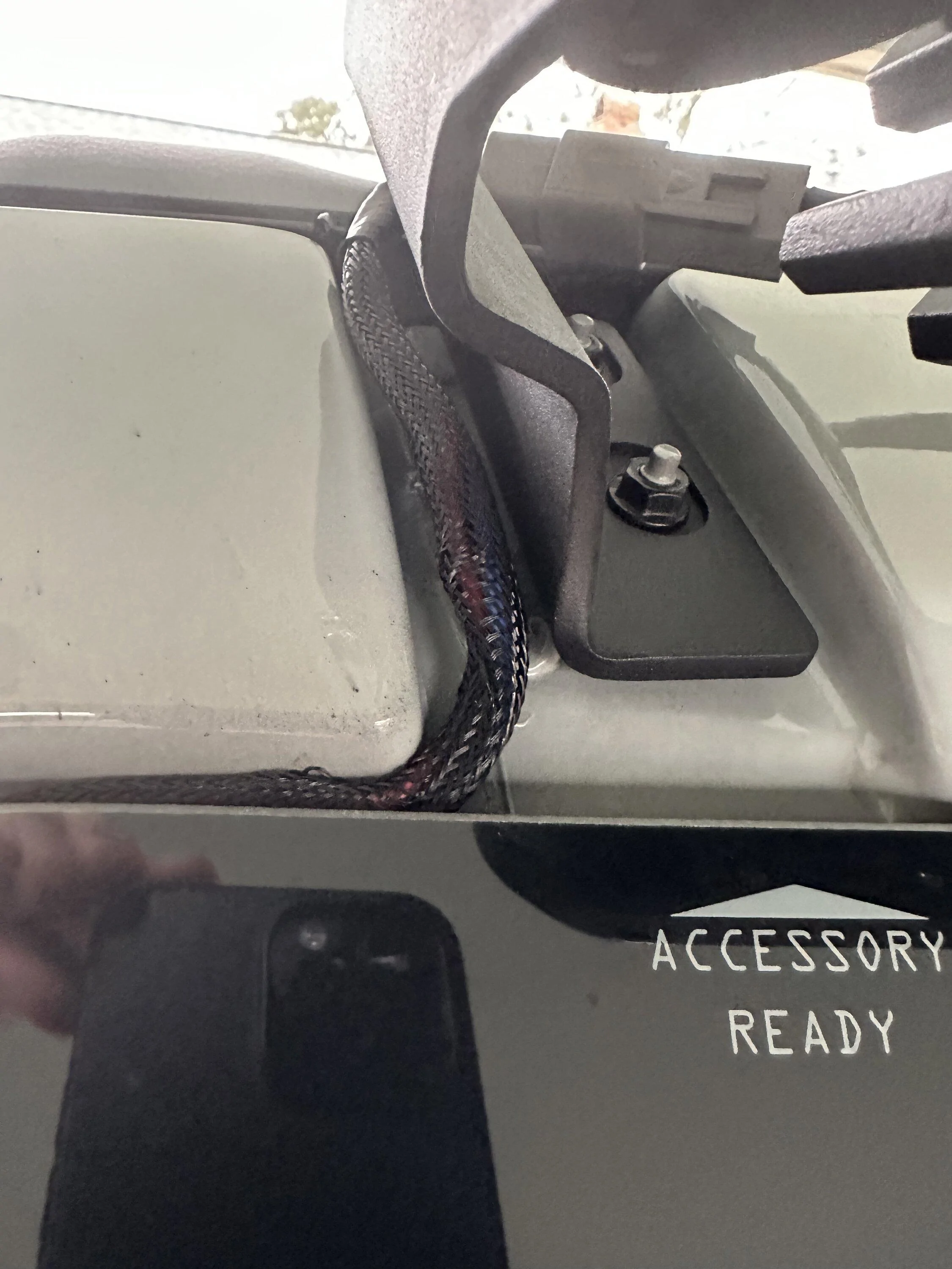

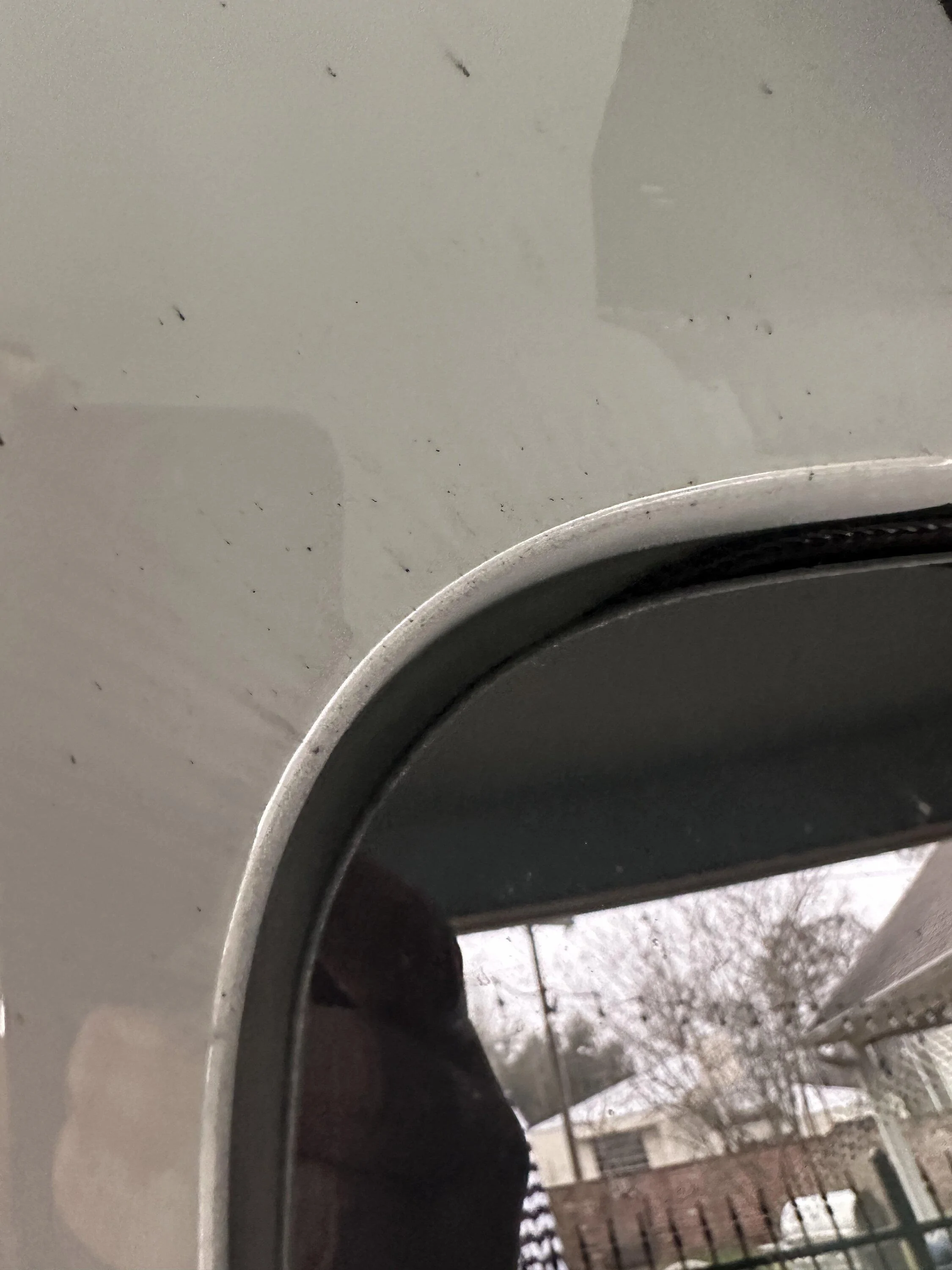

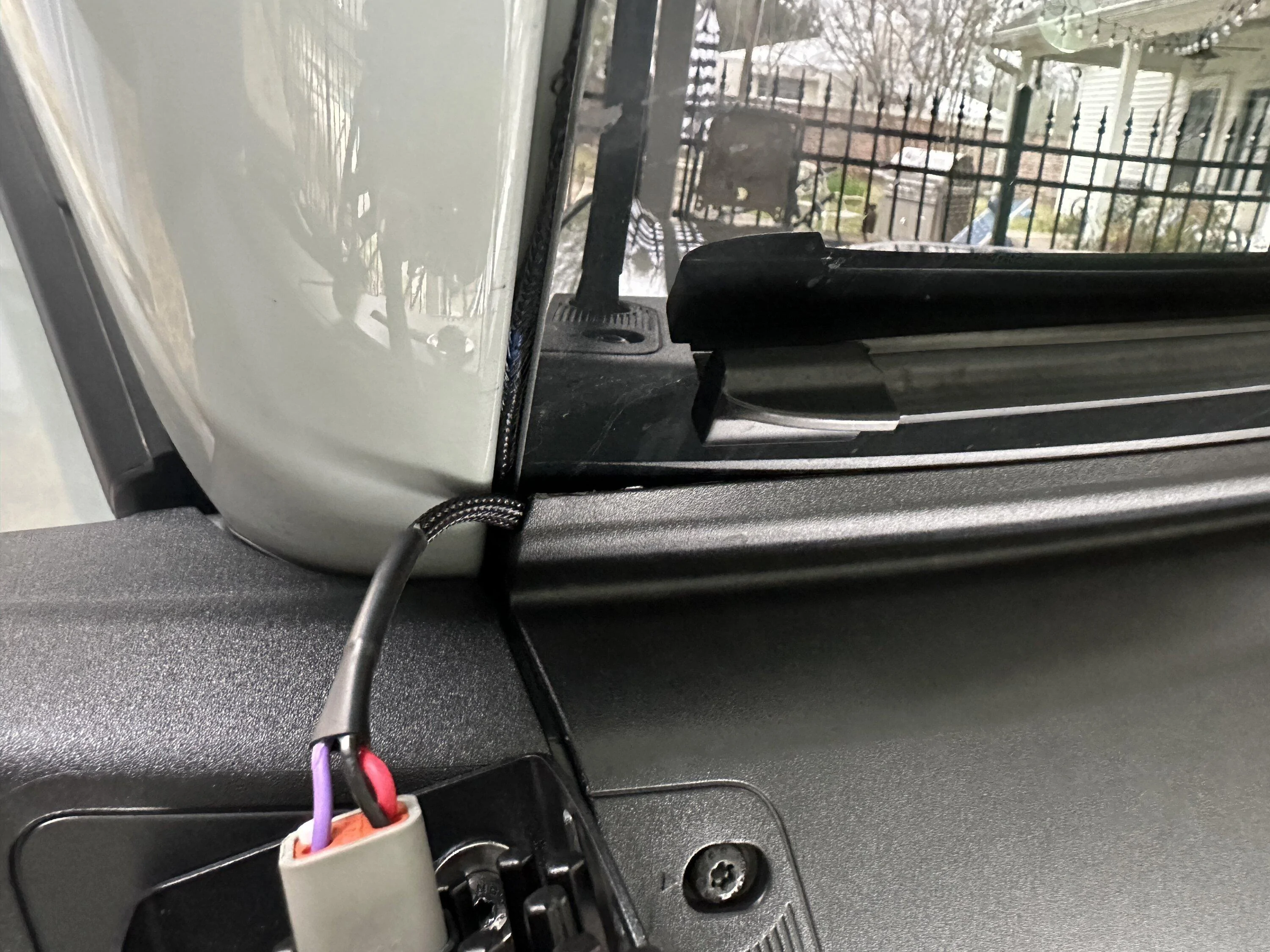

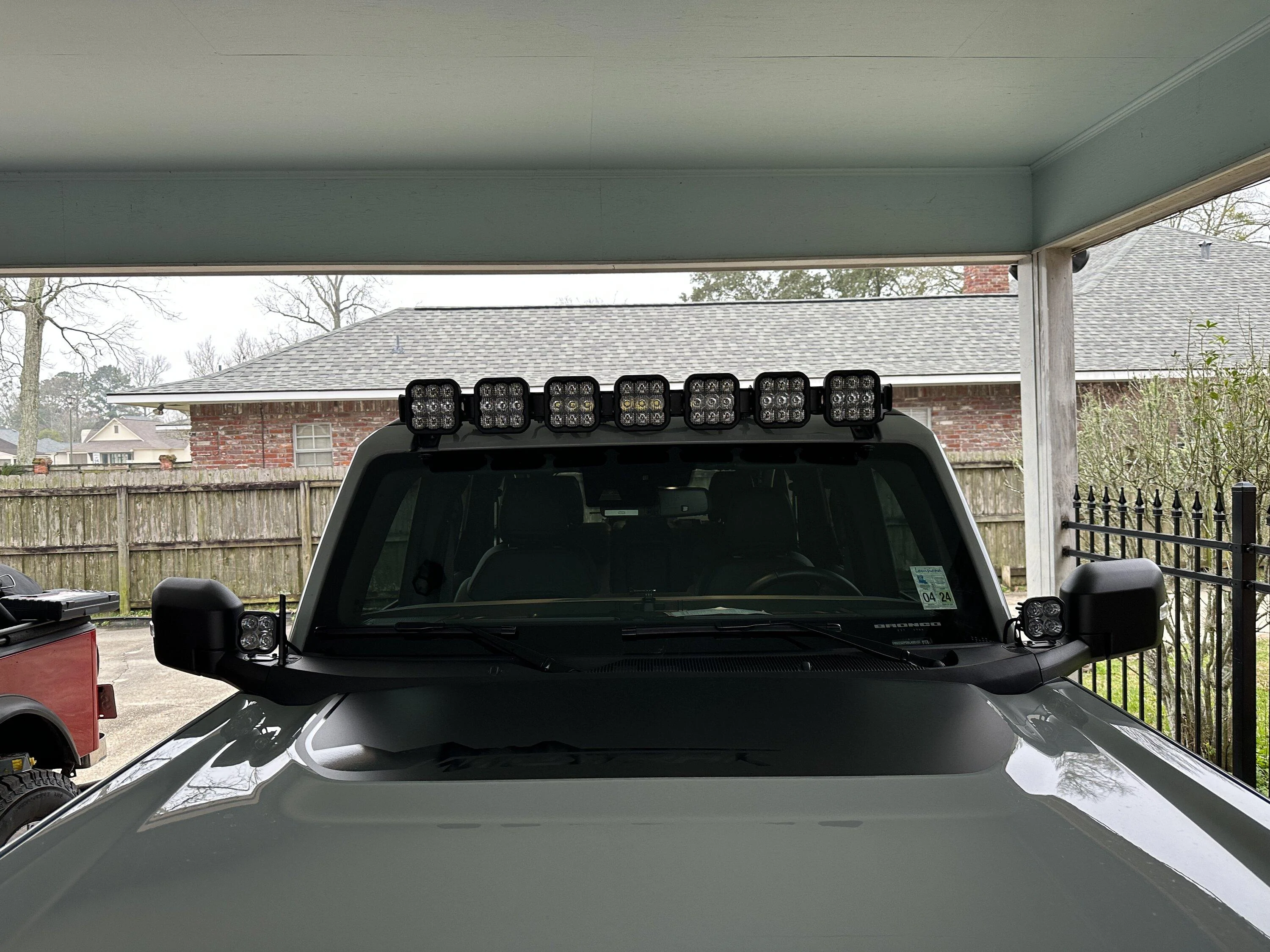

Here are the pictures I took today. I have the KC hide a wire that I thought I was going to have to use but ended up not needing. $10 and shipping for the hide-a-wire will have it at your door. 4x4TruckLeds.com is where I bought the lights and Alex at 4x4truckleds.com is the guy I pestered with wiring questions. He helped quite a bit with simple questions for him but seemingly brain surgery for me. Thanks again Adam and the 4x4Truckleds group.

thanks for confirming it'll fit into the gap. i will probably do the same

That looks pretty good. My names Adam btw :( Not Alex :(
