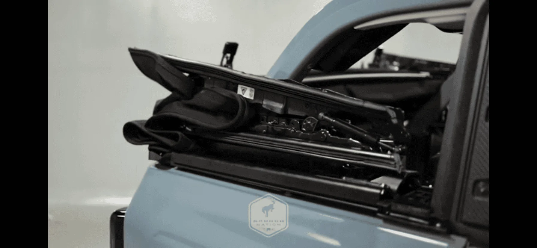

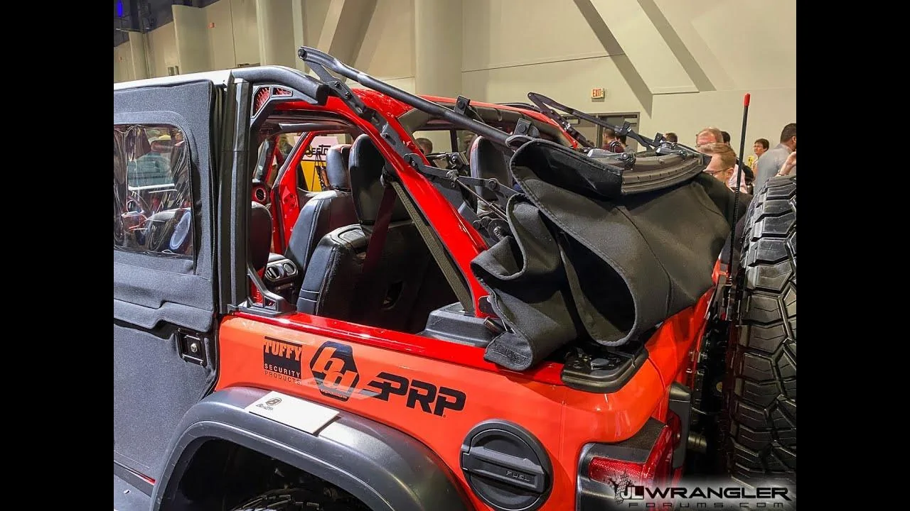

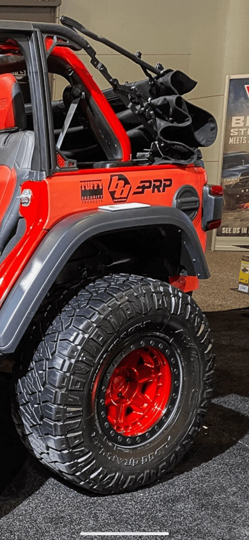

I’ve been thinking about this for a while as a soft too guy. It seems like EVERY single video, both produced by Ford and by owners, people just set the top into the down position and lock it in with zero regard for how the soft top material folds into itself. On the Jeep Bestop that does this, the material folds a little bit neater into its accordion style.
I’ve maintained from day 1 of seeing the soft top that I don’t think you should just throw it down and bounce. As you can see from these pictures, it’s easy for the material on the sides to not fold neatly, and get pinched up in itself. I think 30 extra seconds while you’re putting the top down, you can make sure the folds are neat and not trapped in between the frame and the rest of the bunched up material. I really think this is why the soft tops have this gross wrinkled looks on them on the sides, and why OP is experiencing rubbing.
