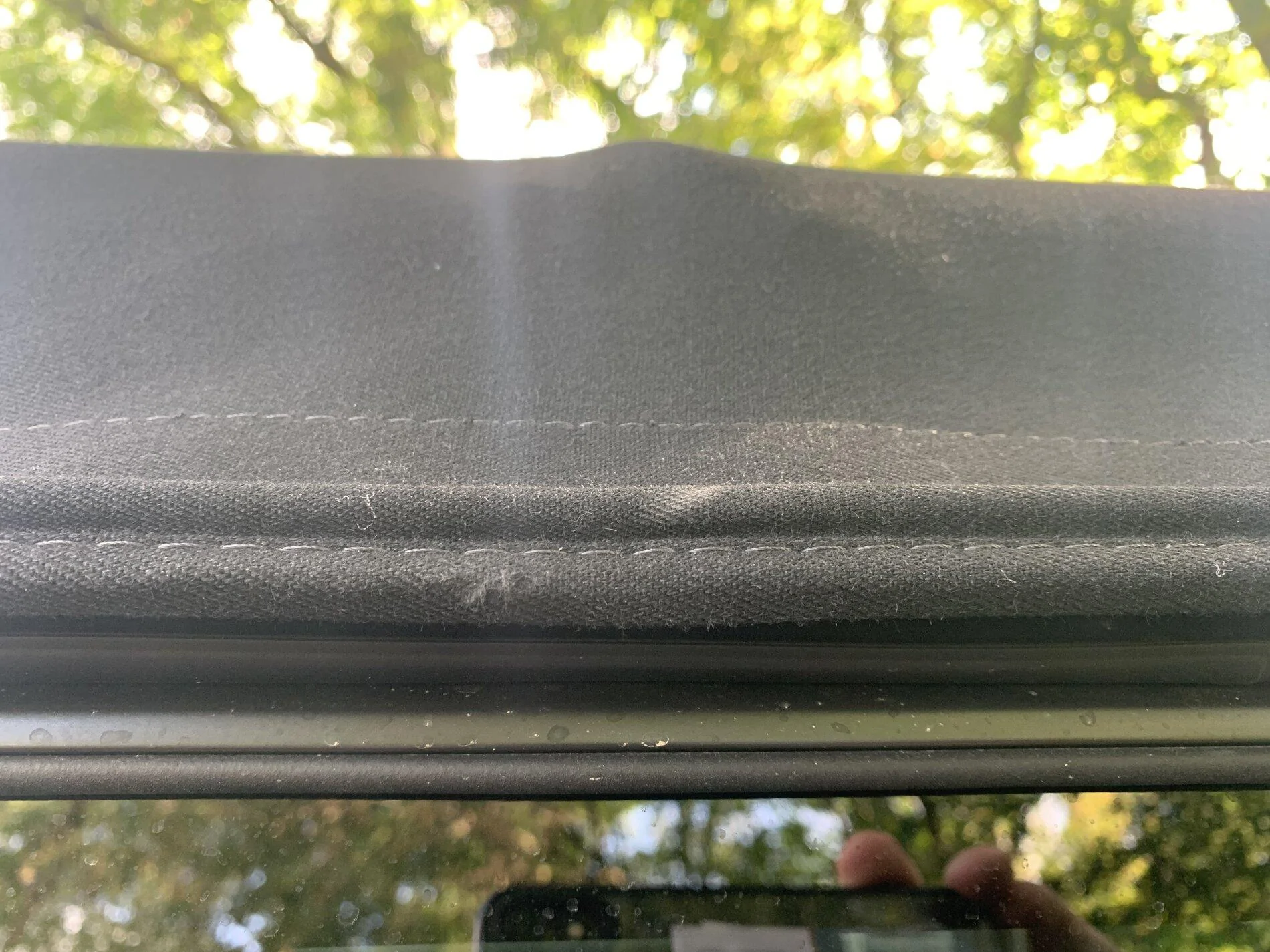

Getting in the car today I noticed wear on the softop. It is bad enough that the driver side has rubbed through the top down to the rubber below
It appears as though the top is rubbing on itself, or something when it is all the way down. I say that because when I put it back it didn't appear to touch anything. It also appears on both sides, though the driver side has worn through and the passenger has not yet.
Will be reporting this to my dealer on Monday.
Update 8/1
Took a minute today to do some troubleshooting. It looks like when the top is folded back it can fold under the frame and rub against a piece of plastic. I noticed it folded differently yesterday so not sure what causes it to fold under and rub versus not. Definitely check your top when folding it back.
Pictures of the issue.
I’ve had mine for three weeks now, and I am seeing the same thing with my soft top, but at the leading edge of it. Any thought on what to do?

That first pic is something to be upset about. One reason why I wouldn't change to a soft top.

Double check both sides when you fold the top back that it isn't tucked under and touching the plastic on the roof frame. This is what caused mine to wear.
I'm late in seeing this issue. Does this happen when just the front part is folded back in the first position, or when the entire roof is folded all the way back with the rear panels removed?
It can happen in either. It happens when the top folds under and rubs on a piece of plastic on the top. Double check when you fold the top back it's not folded under on either side.

Update- props to Ford they contacted me here and I arranged to go to the dealer this week. They reviewed it and have a new top on order.
