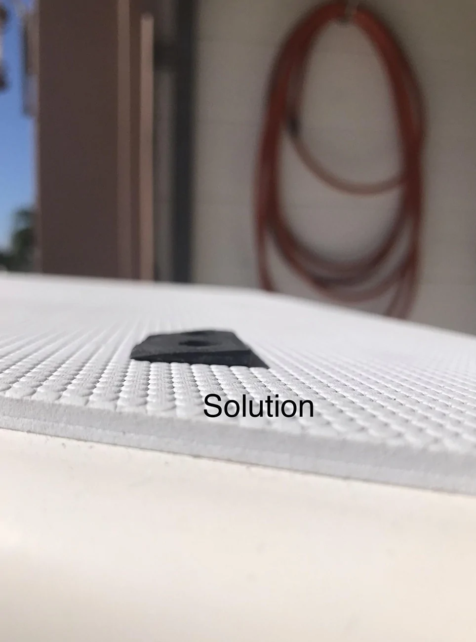

Well I asked a while back if there was an adjustment for the rear side window slide. Last weekend was beautiful so I took the top off to see.
The drivers side rear window will not pull out. I pressed down on the plastic piece at the front of the larger slide in the frame. The window has two round pieces that slide into a channel a long one and a short one. The short one starts to pull out but the long one hits the channel the short one slides into.
I played with it enough to get it out, by loosing the two Torx screw holding the plastic piece in place. I placed the entire top frame on saw horses to try and figure out if there was an adjustment or maybe a way to shim the plastic piece. There is no way. The metal bracket the plastic piece screws into is bent up about 1/16to an 1/8th of an inch which is causing the two channels not to line up. I dropped by my dealer to see about shims to fix it. To their credit the said they hadn't see any soft tops or how to remove the window. I showed them how.
Anyway they opened a case with Ford about how to adjust the bracket or replace the entire frame.
We shall see.

Just how it is. The two tracks with the space between don't align. You'll (not) get used to it.

There's a guy here who did some trimming on the edges, don't know how to find it, but might be worth finding. I'd like to do it as well, even tho' I only put them in/out once per year.

Mine are so misaligned that I can't for the life of me figure out how to get it from the small track lined up to even enter the back track (pulling from from to back)
I just can't even get it started to enter the back/long track.
are there any tricks?

rounding off the end edges of pabel tracks helps getting ot started and transioning to next track.

I push up on the longer track and angle the male channel piece down to get it in. It actually shaves a little off the male piece every time, so it’s getting slightly easier 😂😂

I was just looking at the tracks and realized the same - that I could push up a little on the longer track to line things up.
I have thought about taking a flat metal file and trying to "round the corners" on the entry of the slot to help the rubber piece slide in easier.
I have found that slightly pulling out on the soft top window will actually make the rubber pull and make it thinner to ease it in easier.
