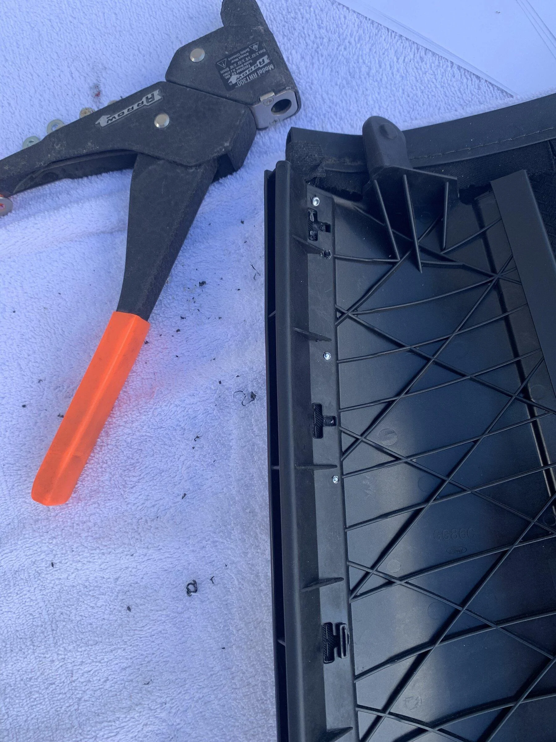

have an appt with the dealer monday. hopefully they will rivet the broken tabs under the tsb.
so with a few of the tabs missing, are we NOT able to reinstall the rear window?

I think I’d rather just buy a can of Gorilla spray and do it myself, rather than deal with the Ford warranty. From the sounds of it, it’s the best fix to date anyway.
