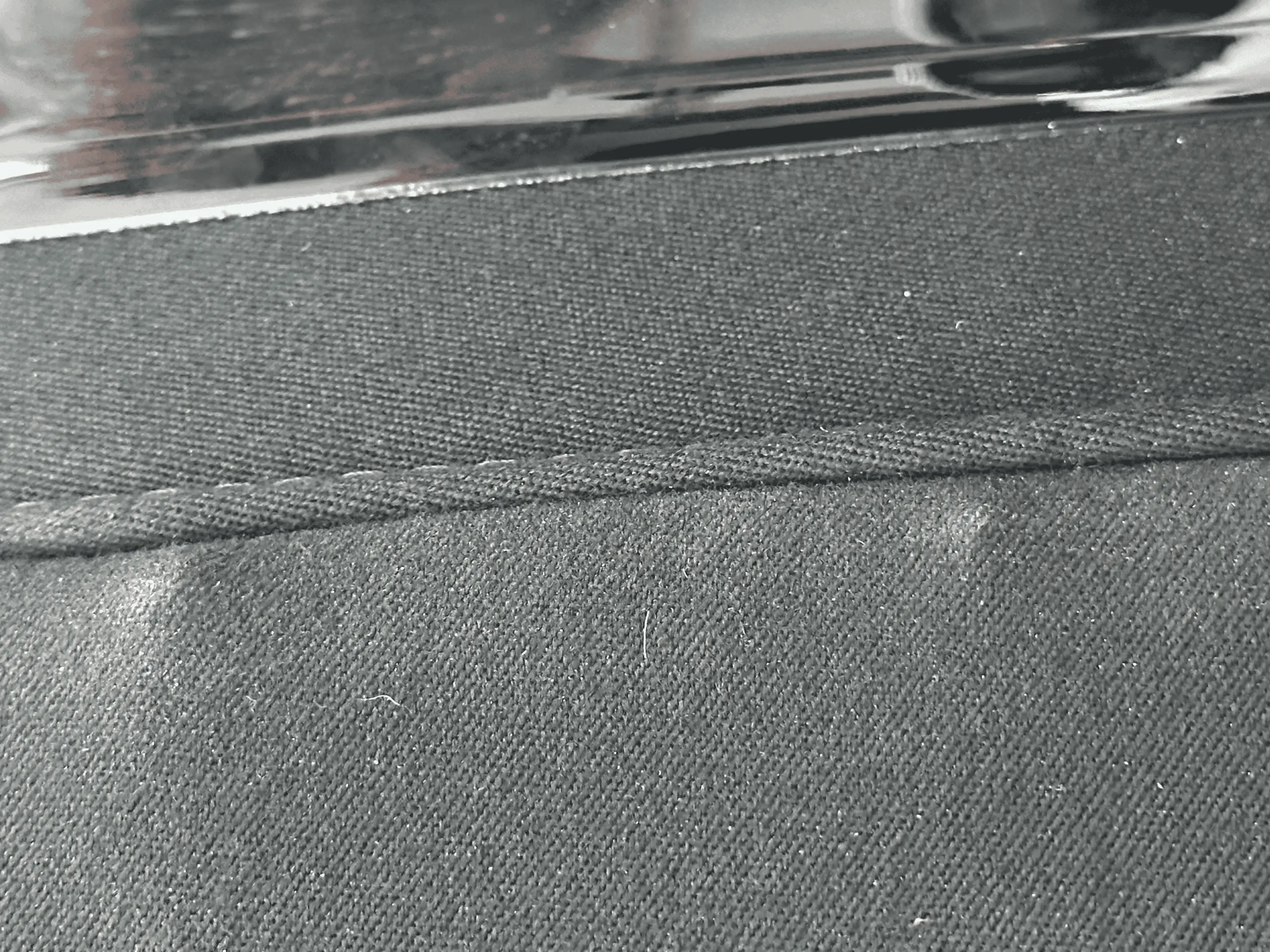

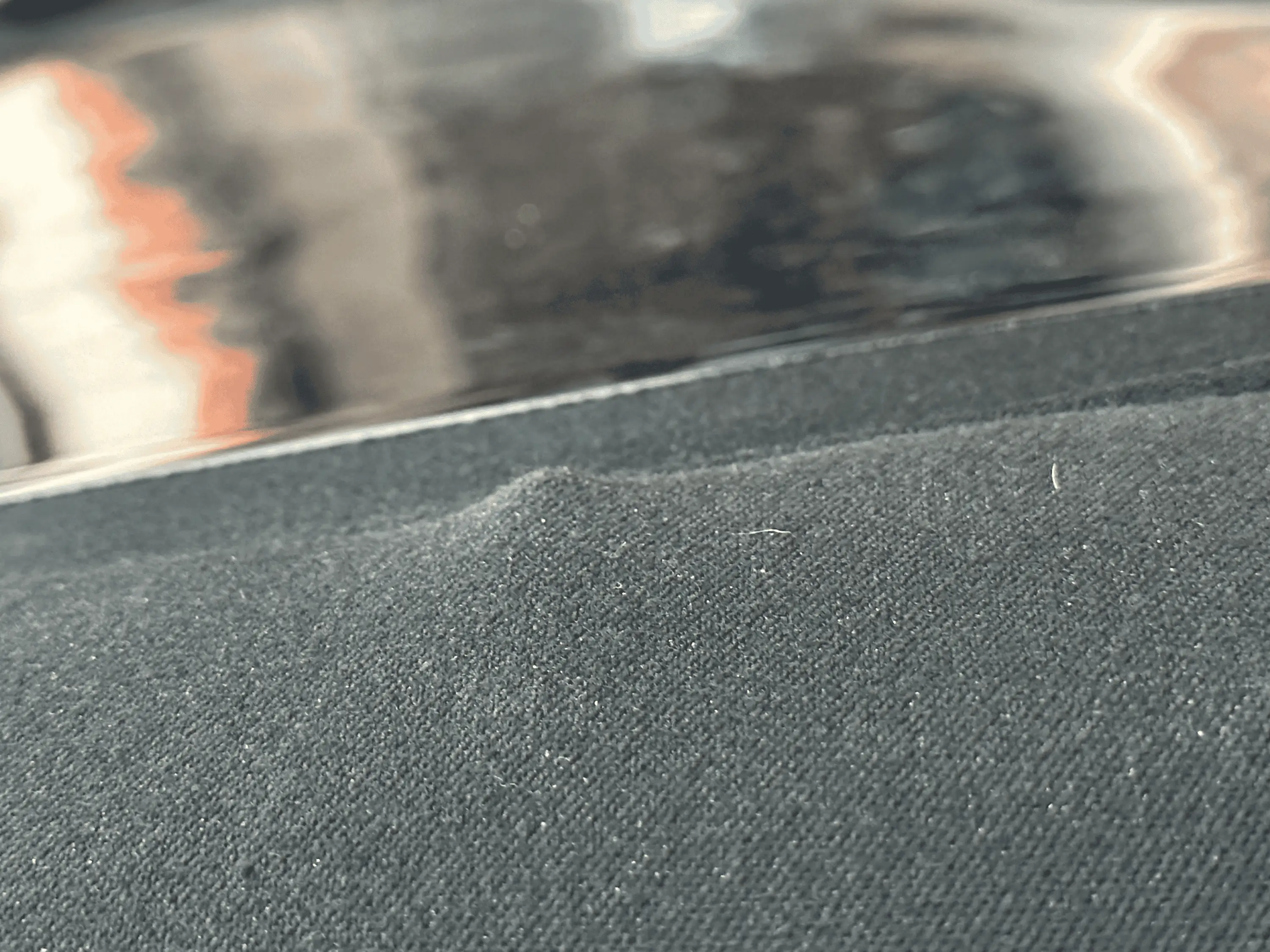

Ok got my back from the dealer. I was told it was a half day job (not really sure--seems like 30 minutes of work max. to me) but it actually "supposedly" took them two days. (I suspect they did not really work on it that long.)
Now that it is done, I am very concerned I am going to have issues with the rivets tearing through the soft top. There are two rivets pushing very hard against the top. The first pictures shows the larger one and the second one shows a smaller rivet pushing too against the top.
Anyone else have had a dealer put these in and if so, do you have similar pushing of the rivets? I am going to have an issues down the road?
I will check mine after the game, but I dont remember seeing anything like this.

Please send pictures. I suspect they did this wrong.

If anyone else has had the Ford dealership put in the rivets can they send pictures today? If mine is wrong I would like to take it back to the dealer today before traveling tomorrow.

Just returned from dealer and they admitted when they fixed it, it did not look right. (Incredible they still had me pick up--did they not think I would notice.)
In fact they supposedly called Ford on the TBS Repair and sent photos to them (similar to what I posted above) and Ford said it looked right.
They agreed to take the Bronco back next week and try repairing again.
What a huge waste of time this all has been.....
