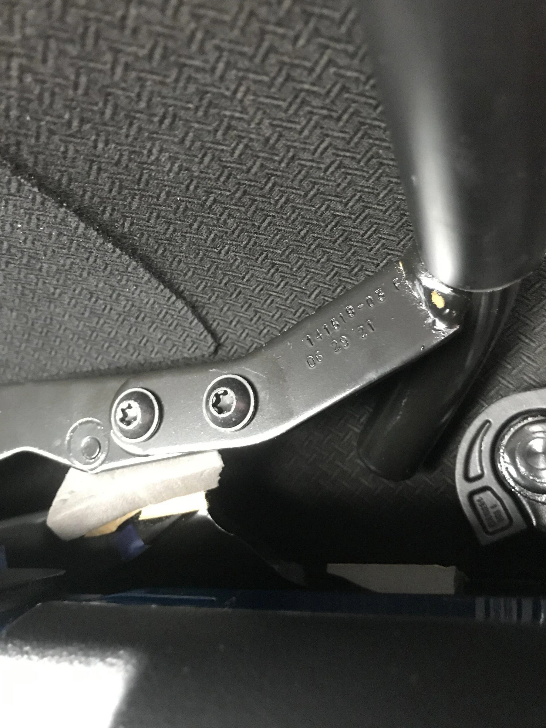

Just a heads up for anyone with an annoying clicking or rattle on the passenger side. I have been searching for the source when going on shitty NY cracked up roads and found it on mine, The second from the front roof crossbar has bolts that go through and hit another metal bracket. They installed a small round bumper pad but it does nothing for up and down bouncing. I pushed up on the roof crossbar and slid in a 1/4 inch thick piece of foam insulation you get with a window AC unit. My soft top is now very quiet over rough roads. Hope it helps someone.

hard to see what your doin maybe more pics? pan out ...arrows?

It’s the second crossbar right over the middle of the passenger area, if you push on it to lift the roof up and drop it, mine make a loud clicking sound.
