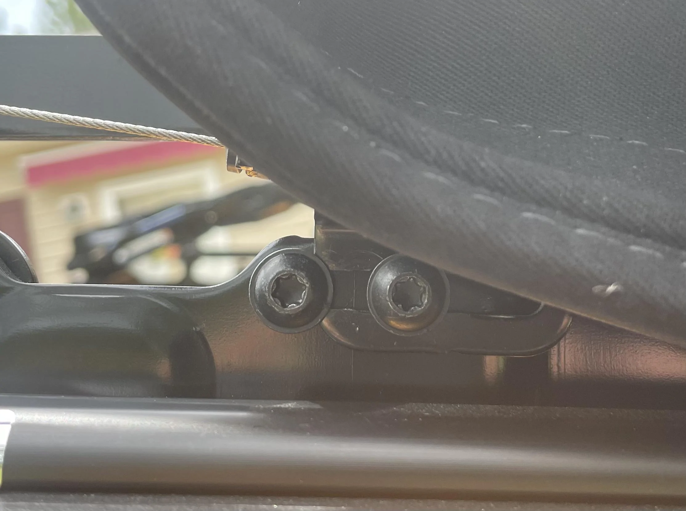

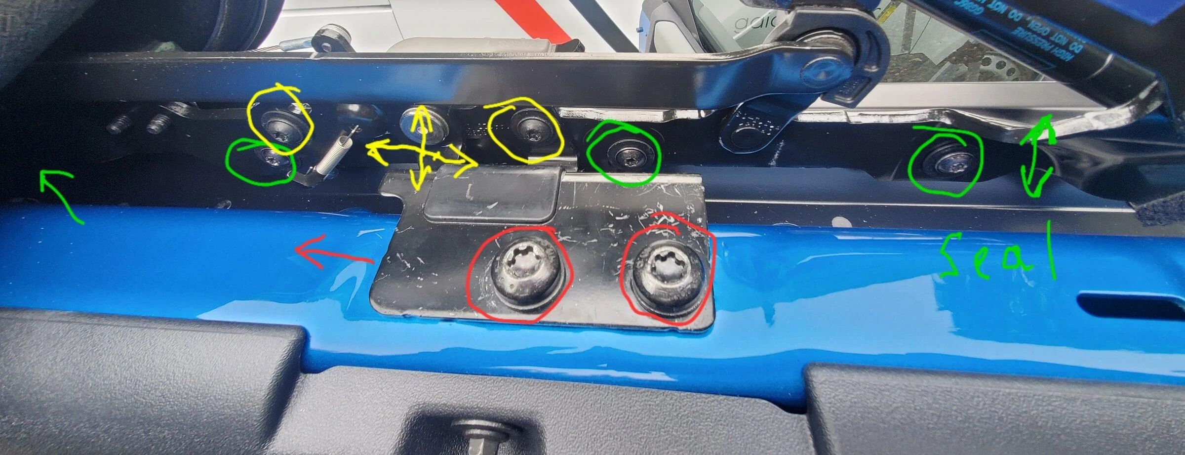

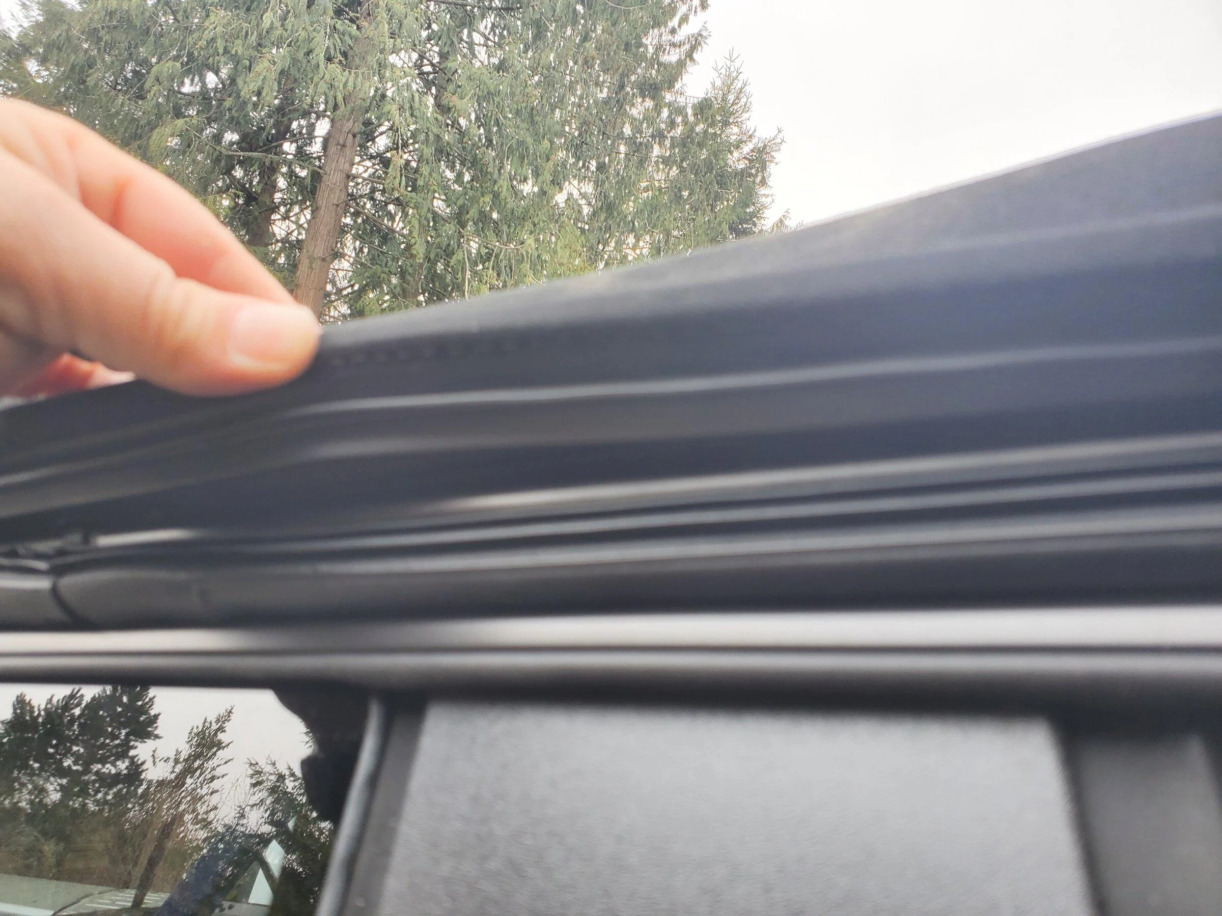

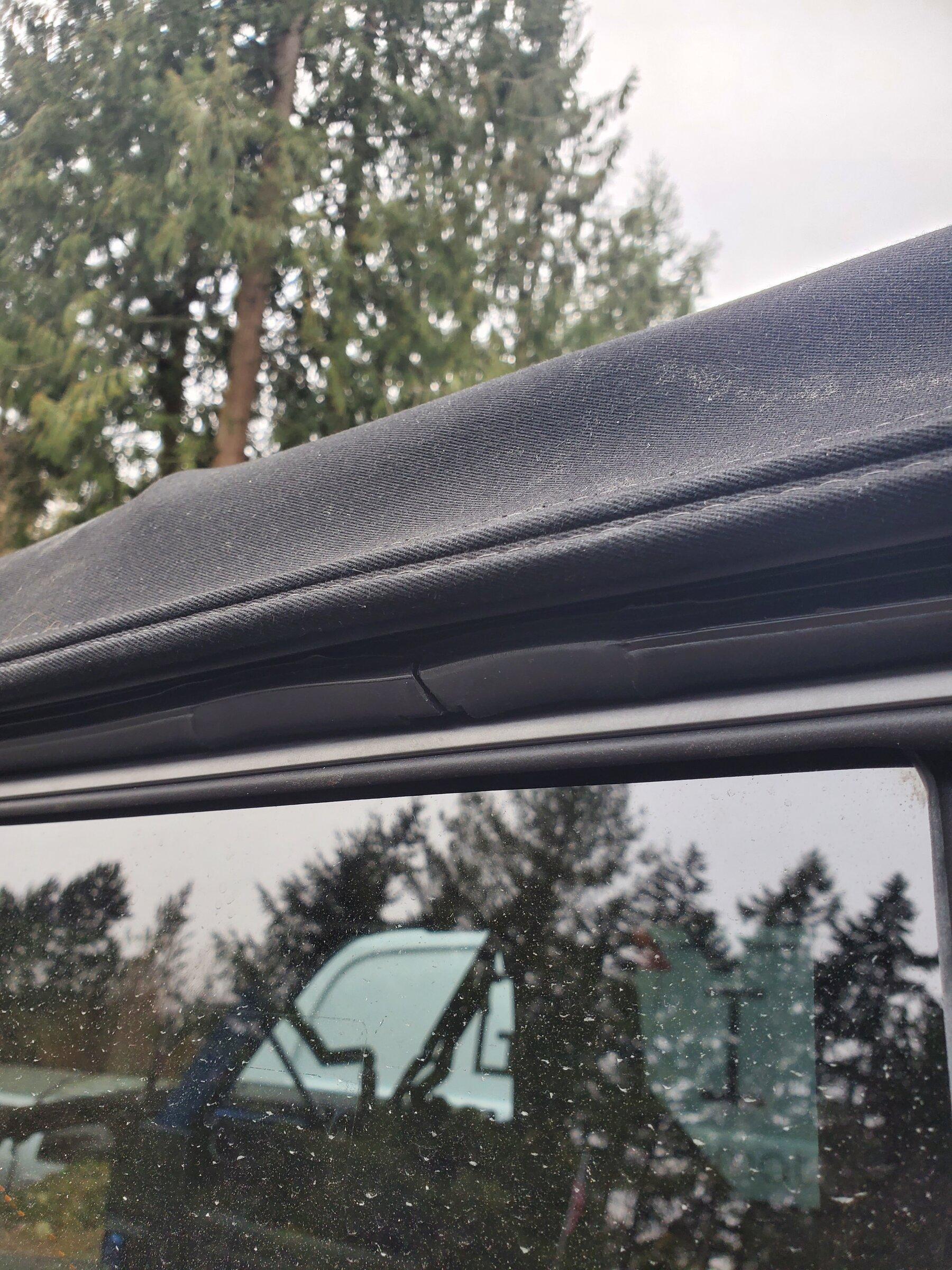

So I just spent some time to adjust my top. For mine I needed to move the solid "catches" back all the way. I also has to go back and forth with the "cable tension" adjustment until they both locked in easily. I also had my seals that didn't align correctly between the front section and the rear section. There are 4 screws that have big holes behind them so they can be adjusted up/down forward and back. My clips were pulling down on the top so hard it was squishing the seals out over the doors so they didn't align. After I adjusted the catches and tension plates (the whole latch that moves front/rear also moves up and down)I folded it all the way back and checked clip engagement with the top all the way down. Had to adjust the tension plates again (easier to get to with top down) the tension adjustment is nothing more than the cable is fixed between the two plates. If you loosen both moving one affects the other. After some fiddling it latches and unlatches smoothly.
The green bolts circled allow you to adjuat the seal
The red circled bolts allow the catch to move front to rear
The yellow bolts are for the tension cable and position of the latch up/down front/rear

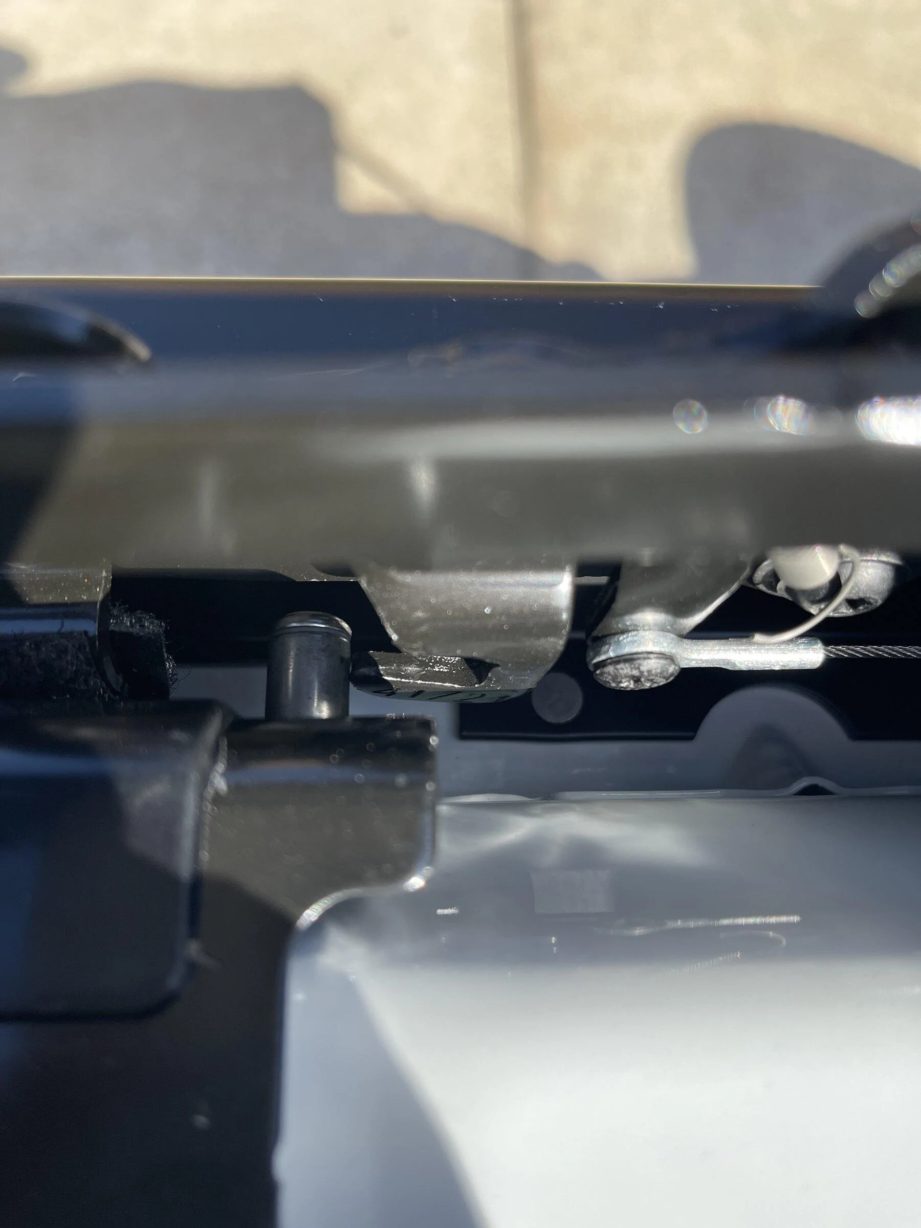

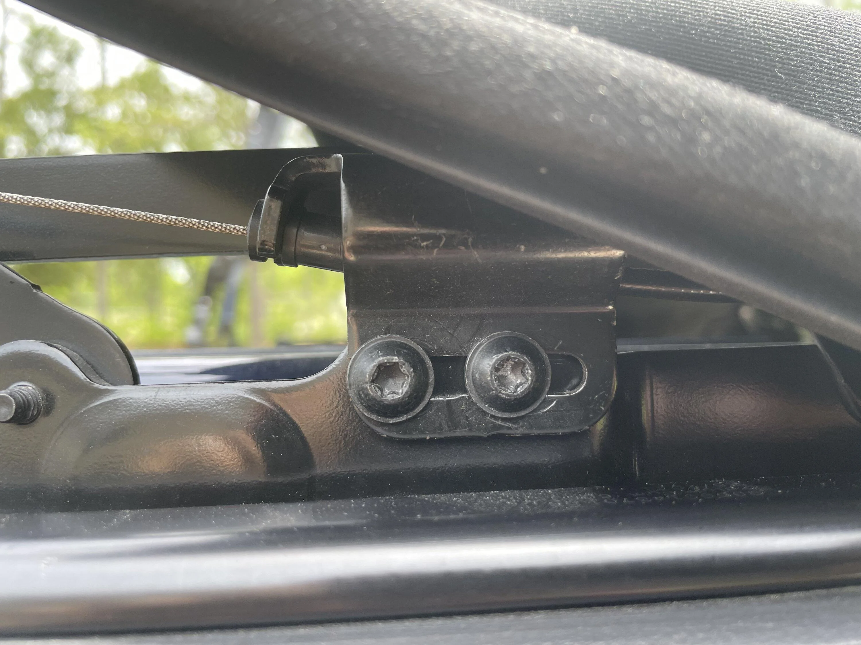

The front receiving bracket by the visor on the driver's side had to be moved in towards the centerline if the car.
The two "clips" that are on the top at the midpoint of the vehicle on both driver and passenger side had to be moved down and forward in the direction of the engine bay .
The two receiving posts that are bolted to the chassis above the rear doors had to be adjusted( what little they could move) towards the rear of the vehicle.
The cable tension adjustment bear the midpoint (above the driver's side rear door) had to be loosened because there was too much tention on the cable for the system to latch.
When the top was 100% folded back to the spare tire the receiving posts that the clips latch to had to be adjusted up because the top would not lock into the secure position.
I hope this is a good description, the terminology is very open to interpretation for these parts 😁

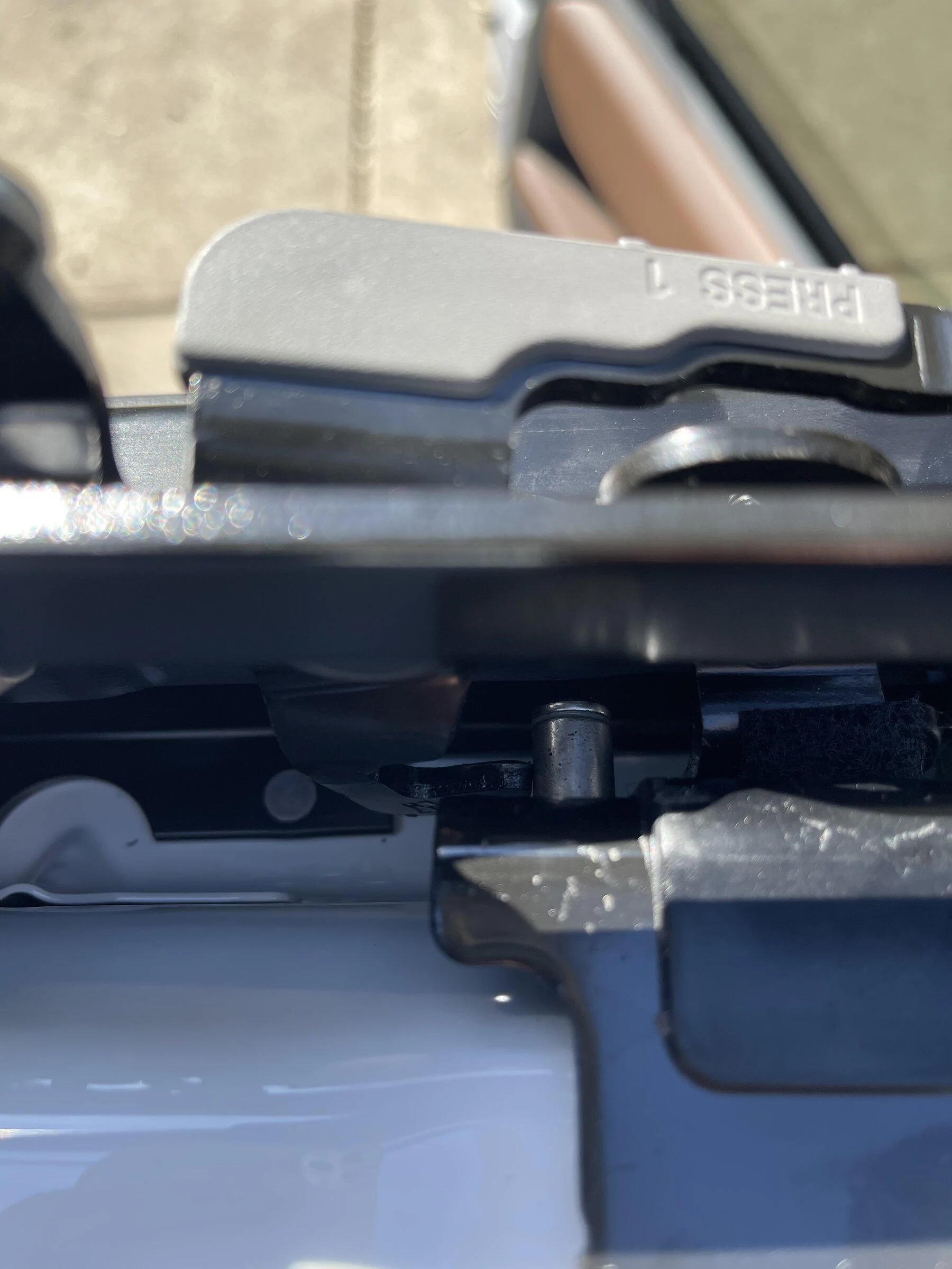

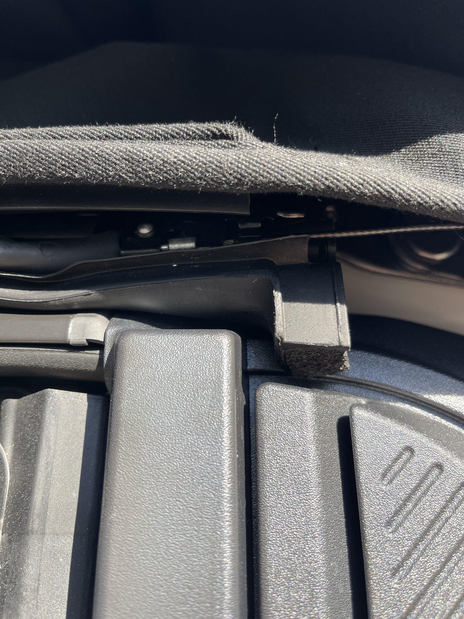

My wife’s top wouldn’t latch all the way down and was a pita to lock in the half down up front. I adjusted the photo below. Almost looks like it slipped, but was tight. Works good now.
