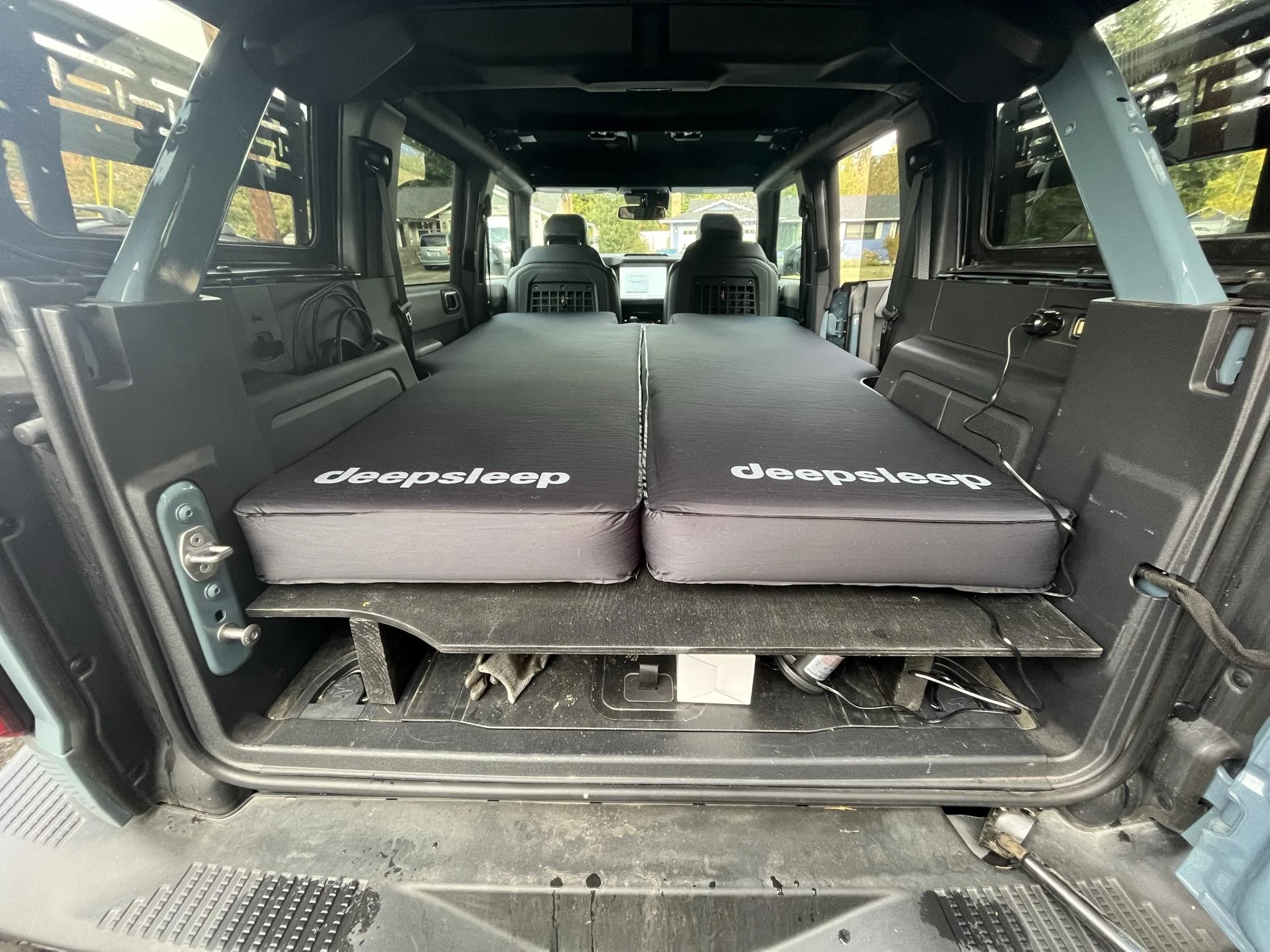

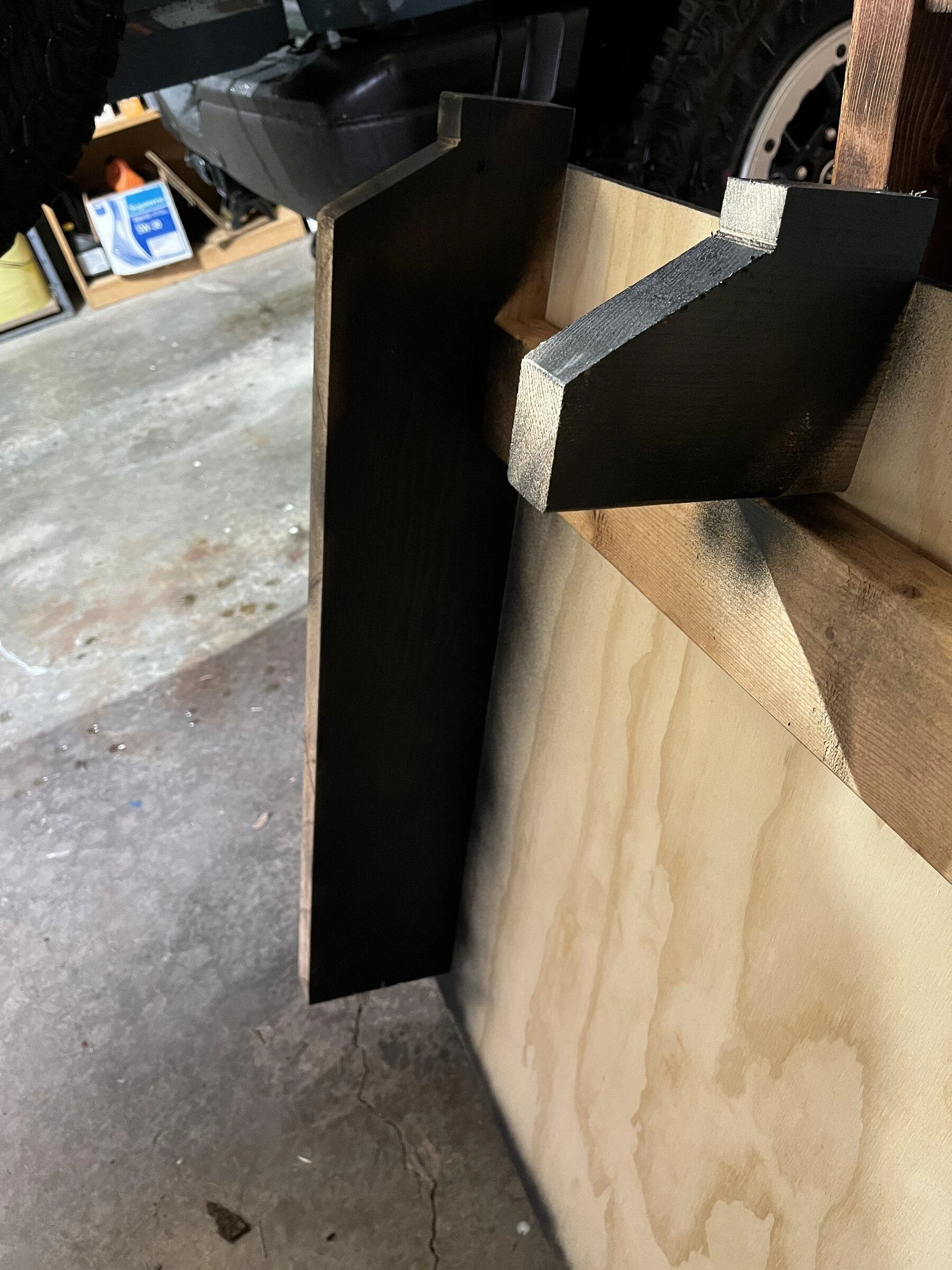

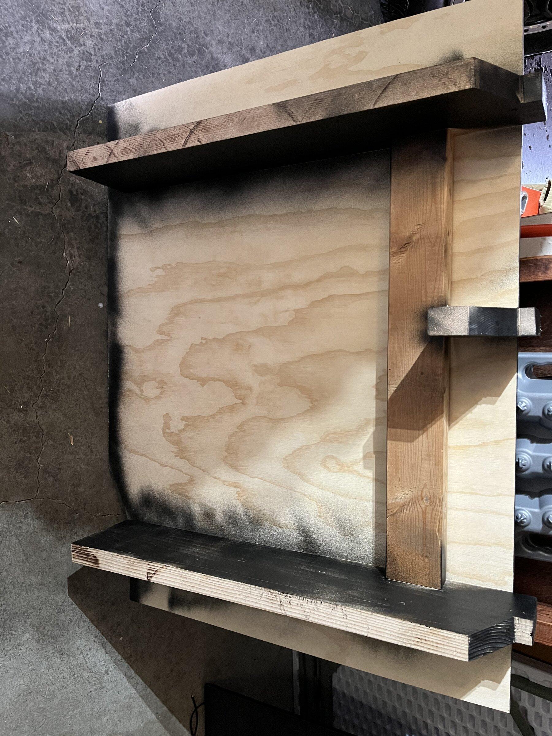

For everyone asking about dimensions... sorry for delay.
Each section is 42 inches across the vehicle. The main platform is 32.5 wide, the middle section is 25 5/8 in wide, and the top piece is 18.5 in wide with 3x3 cutouts at the corners for the rear seat fold lever plastic to clear. The center console cutout is 8.5 wide x 12 deep, cut on center.
The main supports are about 31 1/4 by 6 with a 1.5 inch over hang for the center piece to rest on. The angle cut is about 31.6 degrees. I'll post another pic of the base.

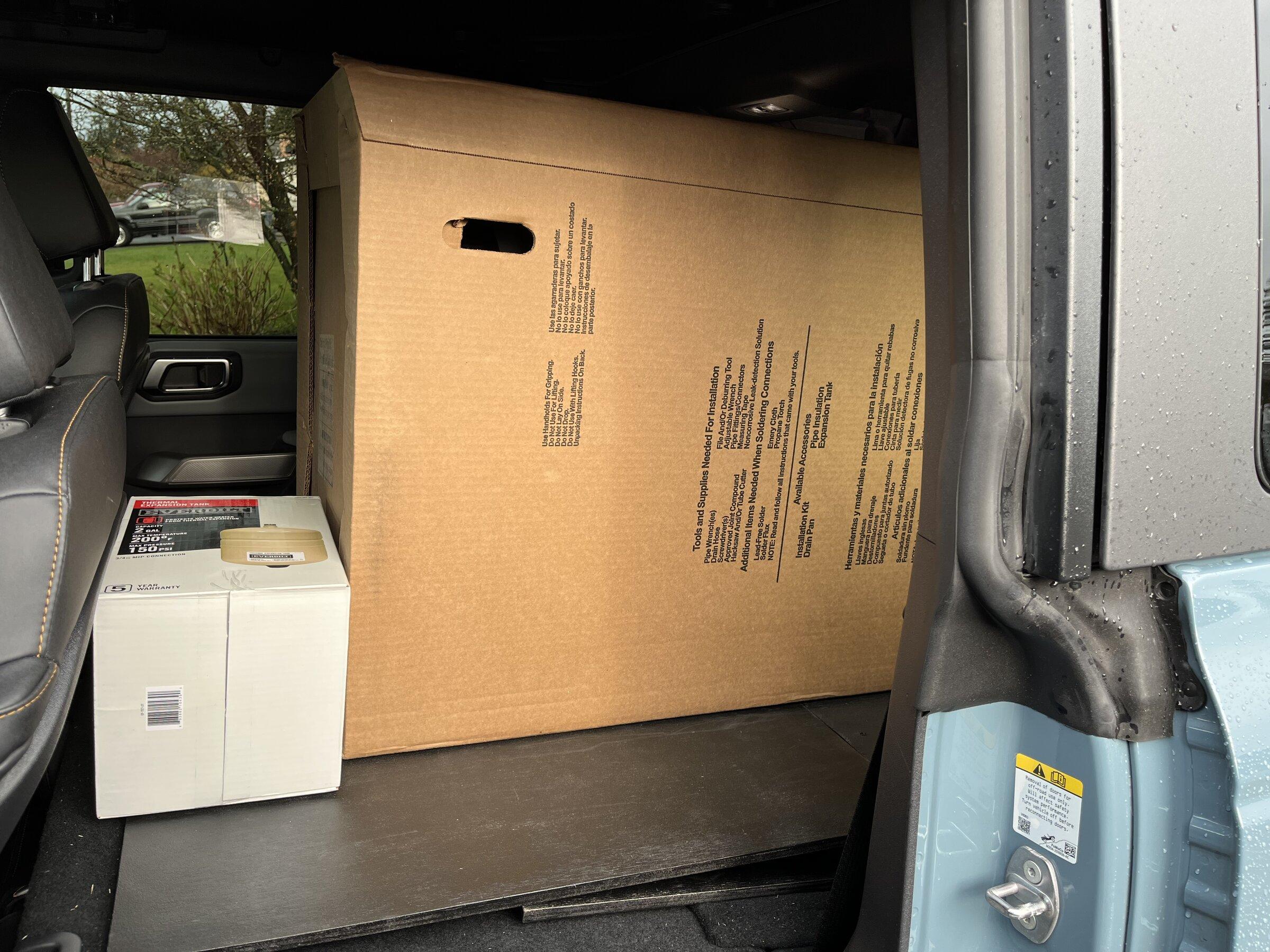

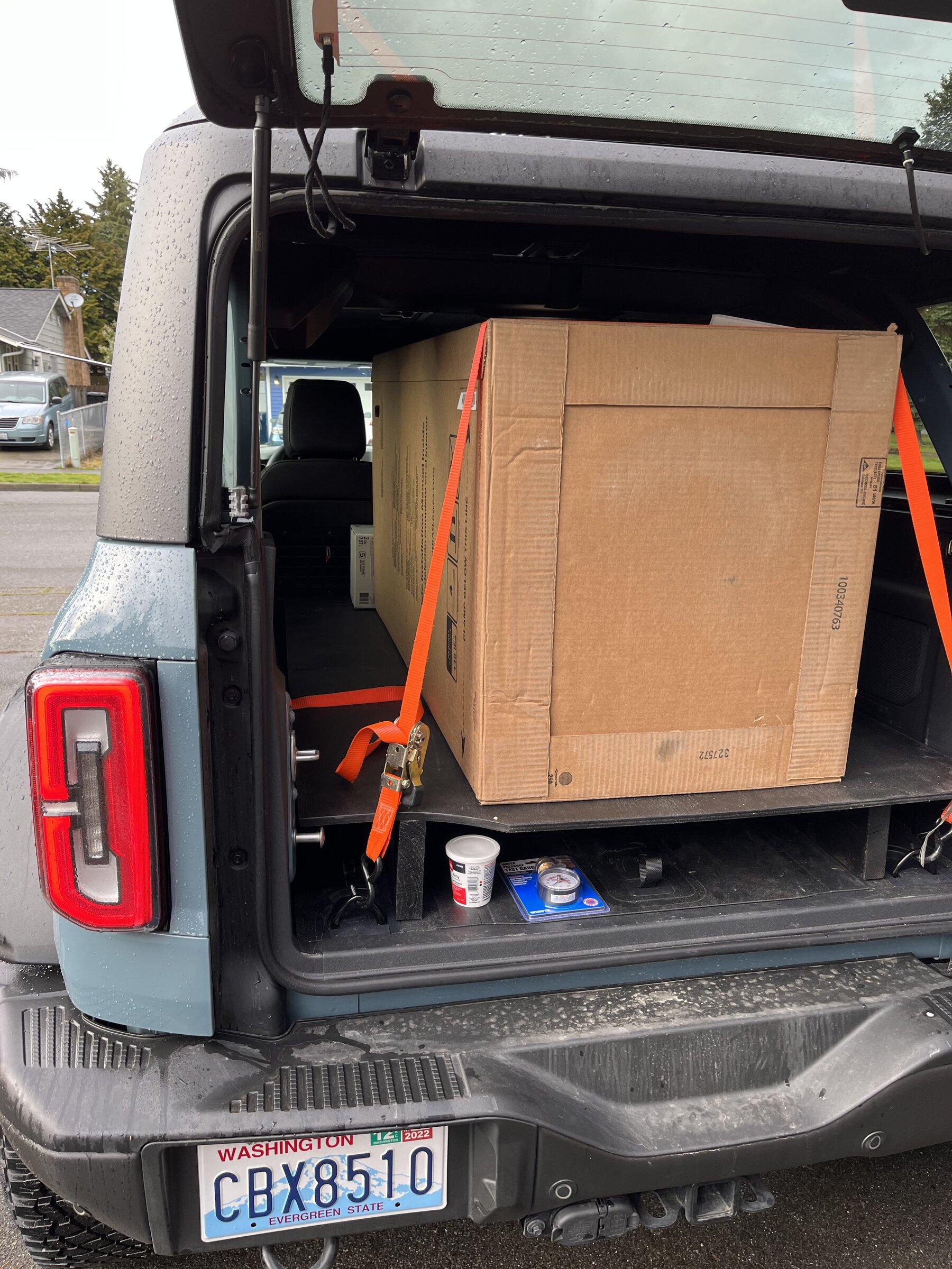

Used the platform yesterday to transport a water heater. Worked like a charm. Even had room to use ratchet straps.

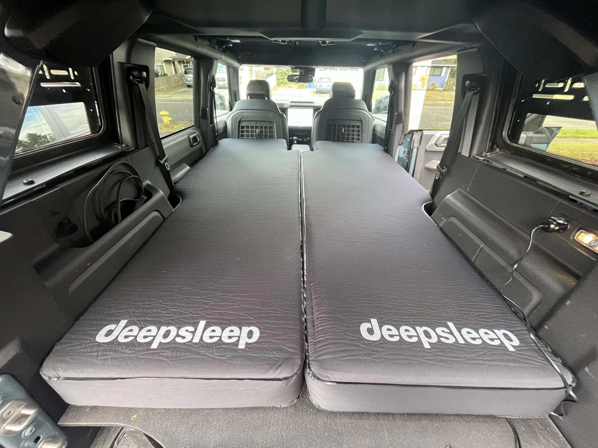

and if you just want to buy something to sleep on that’s level… here you go.
https://deepsleepoverland.com/products/deepsleep-solo-mat-for-ford-bronco-more
