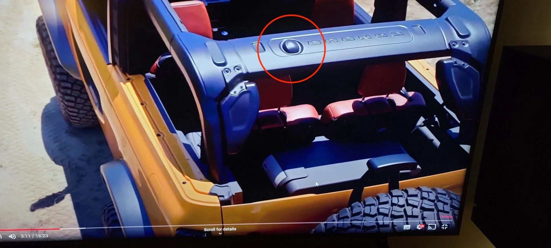

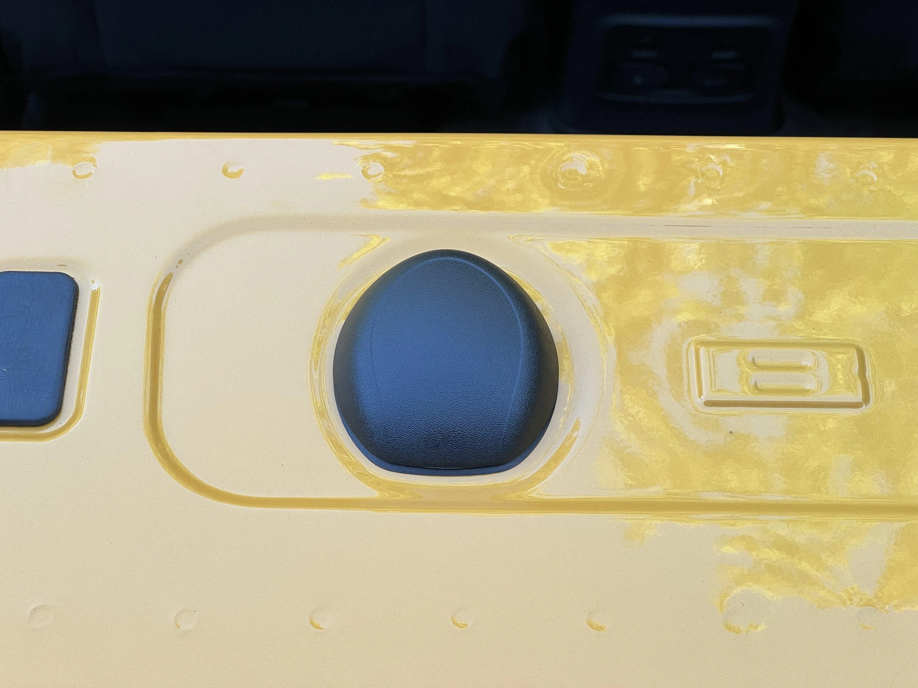

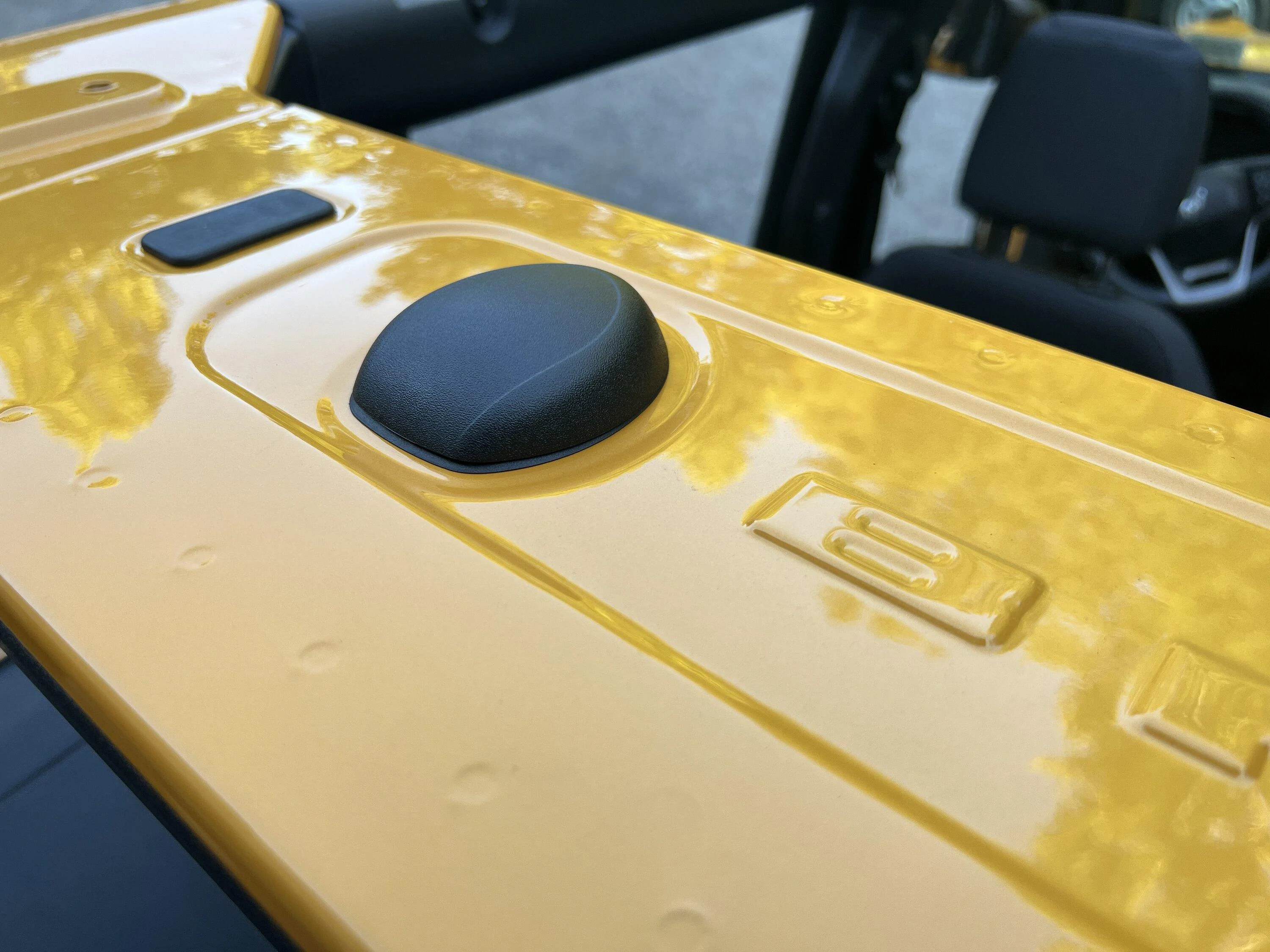

Ah, the truth comes out, any metal over or around the antenna will block the signal.Probably doesn’t help I have a GOBI rack too. Now I’m wondering once I add the RTT if it will just knock it out completely.
The RTT not so much since it is made out of non-conductive fabric. However, bed slats / boards and mattresses will not help as you add up the thickness, it will start to attenuate the signal.
What you need is an antenna relocation kit, move it to the top of the rear third brake light or something like that. Here is one for the Ford F-Series trucks and a couple for Jeeps.
Any way to relocate Sirius satellite puck?
JK wrangler Satellite Antenna Relocation Bracket
Maximus-3 JL SATELLITE ANTENNA RELOCATION BRACKET-jl-satellite-antenna-relocation-bracket
With the Jeep ones you still have to research extending the wiring (antenna coax, etc), you need an extension harnesses kit for that as you don't want to extend shielded wire unless you really know what your doing. Maybe Maximus has them available for the Jeep kits, you could call them or google and see if they or someone else will make them for the Bronco, seems likely.
