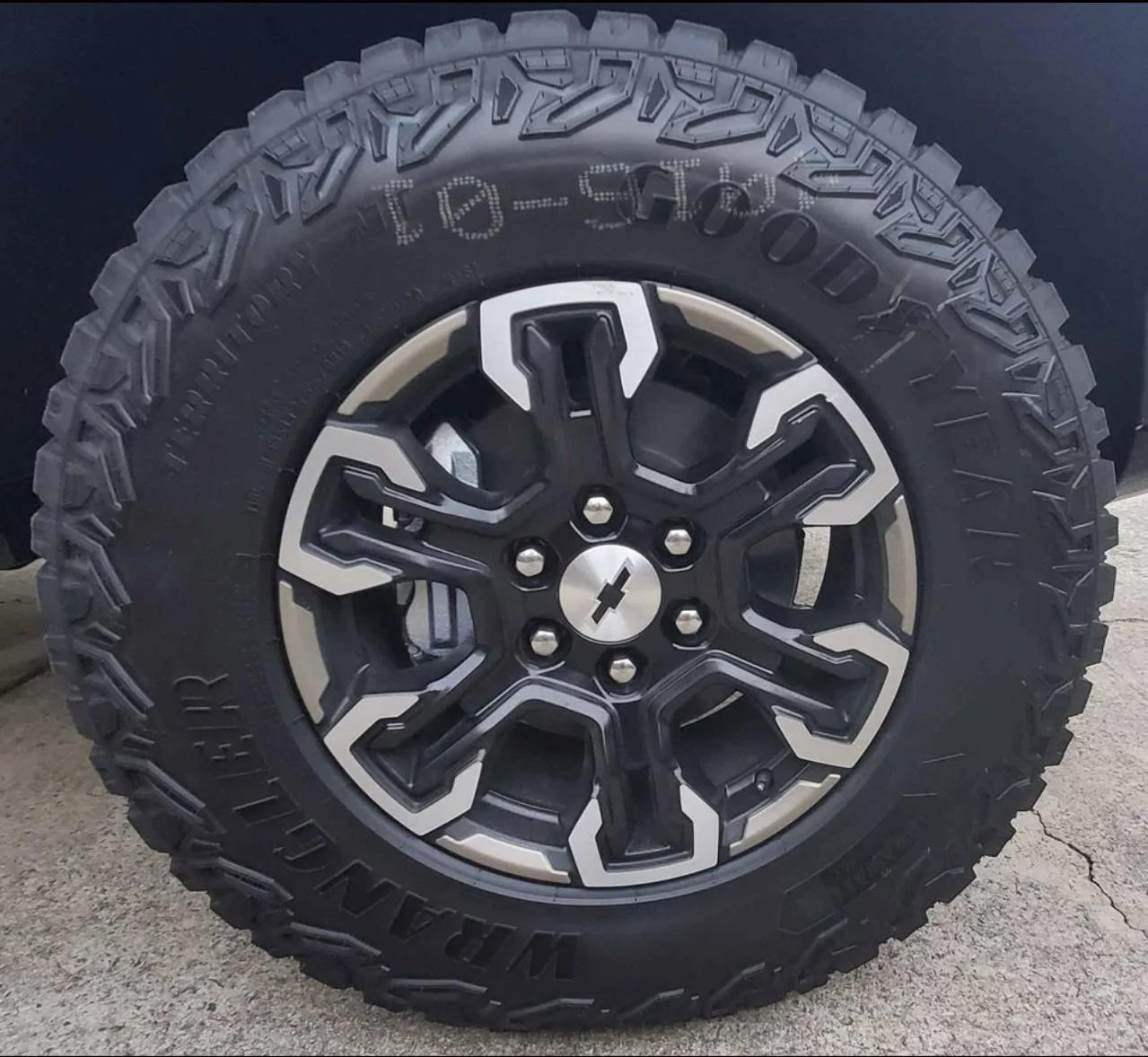

18x8.5 +25 with 275/70/18 seems like they would be a perfect fit. Saw them on marketplace for cheap and I’m debating on buying them to swap out my stocks. I’m sure I can switch the center caps but wanting opinions on if this is bad juju putting Chevy parts on my bronco Before I pull the trigger?

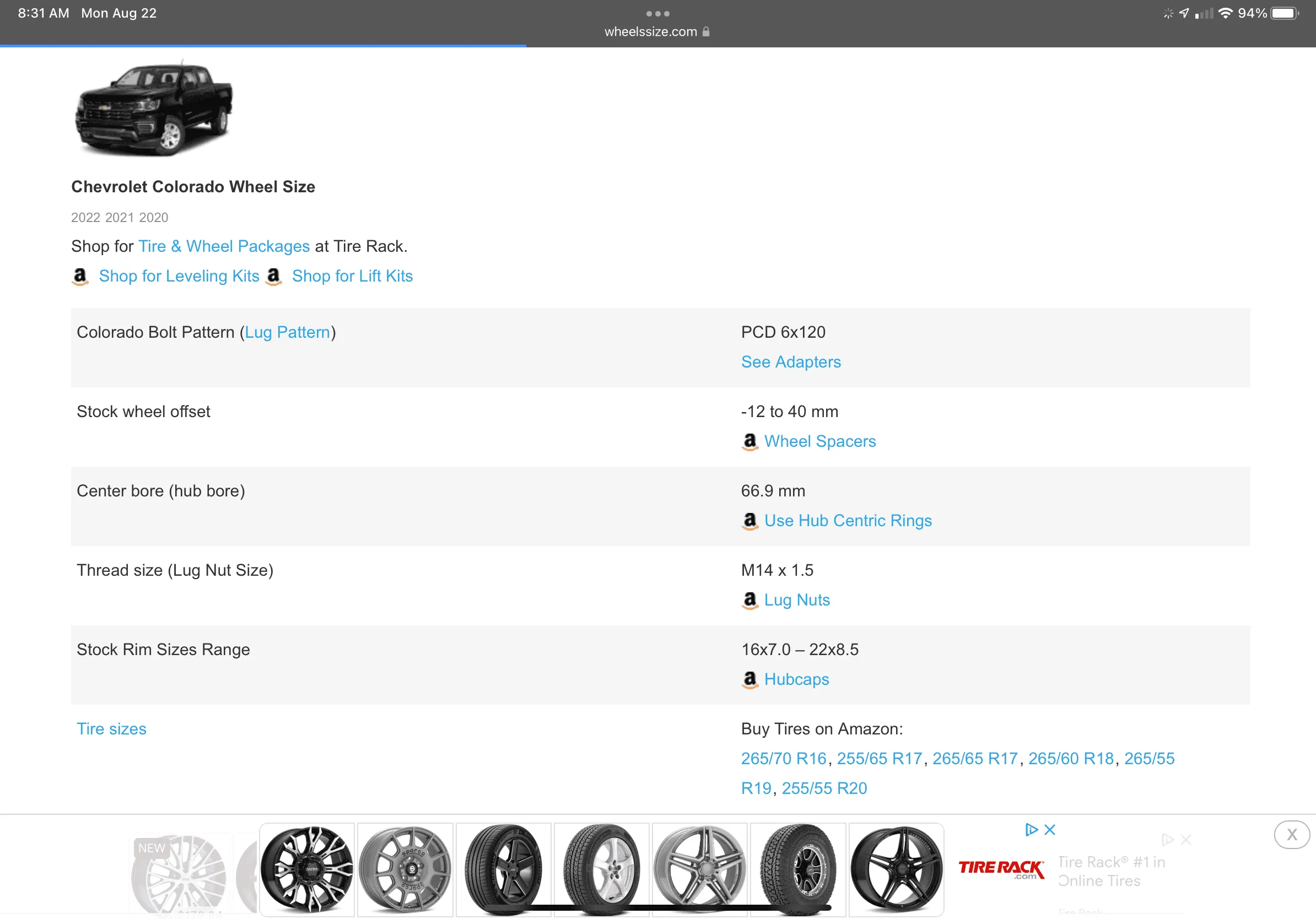

Center bore on Chevy trucks is too small, you would have to run spacers/adaptors

And they already have two strikes against them, Chevy center caps and Wrangler tires. Definitely bad juju. :unsure:

GM usually has tiny centerbores so confirm that.
